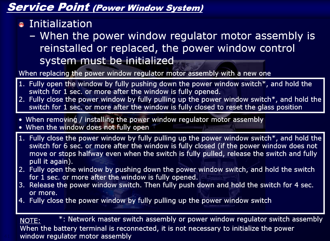

Regarding your windows, I suspect your battery has been disconnected; and you need to reset your windows (from the drivers side panel).
I can't remember how to do this, check youtube, but I think you just wind them all up and down a couple of times and the car remembers them !
I think your seller is suspect suggesting all Alphards have windows like this , it's (*****). They don't; unless yours are faulty and I doubt that.
You may need to perform this reset each time your battery is disconnected.

Yes, you need to open and close the windows fully from each specific control button all the way down and up...then try auto from drivers  buttons. Same with Moonroof.

Windows was just a reset (phew!) Thanks for all the info, I am looking round now

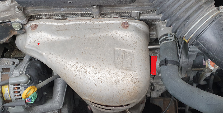

Have eventually found that the VIN Number is printed on the V5C[V5C's now have a new format], but the engine number given is only 3 digits so obviously incorrect. I have ordered an English copy of the drivers handbook which will hopefully show where the engine number is located.
VIN number is Japanese, you can find it on passenger door column label and under the bonnet
and below is the engine number location(in red)
Hi, thanks for the help, will check tomorrow.
