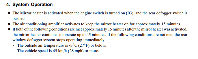

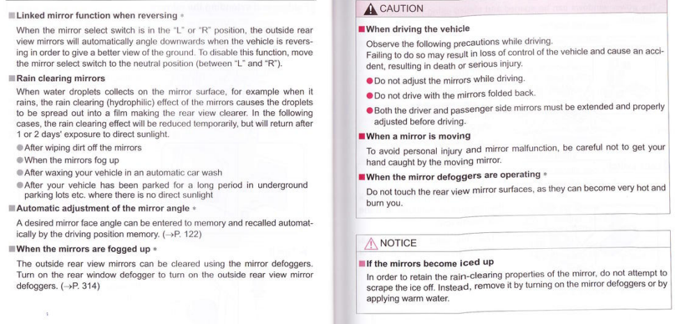

hope I dont need to replace mine ever - heated and Hydrophobic UV coated.
Apparently, UV/sunlight self cleans it and I must say so far ive not had to touch the glass since October, it really does seem to stay clean, whereas my previous regius, I was wiping them down eery few days

I think I have the fancy mirrors too. With the current weather I'll soon find out.
Did you say it needs the Sun to work? I'll have to wait until Spring then !

yes - ill attach the document (was a toyota 'feature' bulletin'

I need to check this "dipping mirror" function.
I have it on another car and it is hugely useful in helping me avoid kerbing the alloys.
This feature is more useful, to me, than the self cleaning mirrors.
