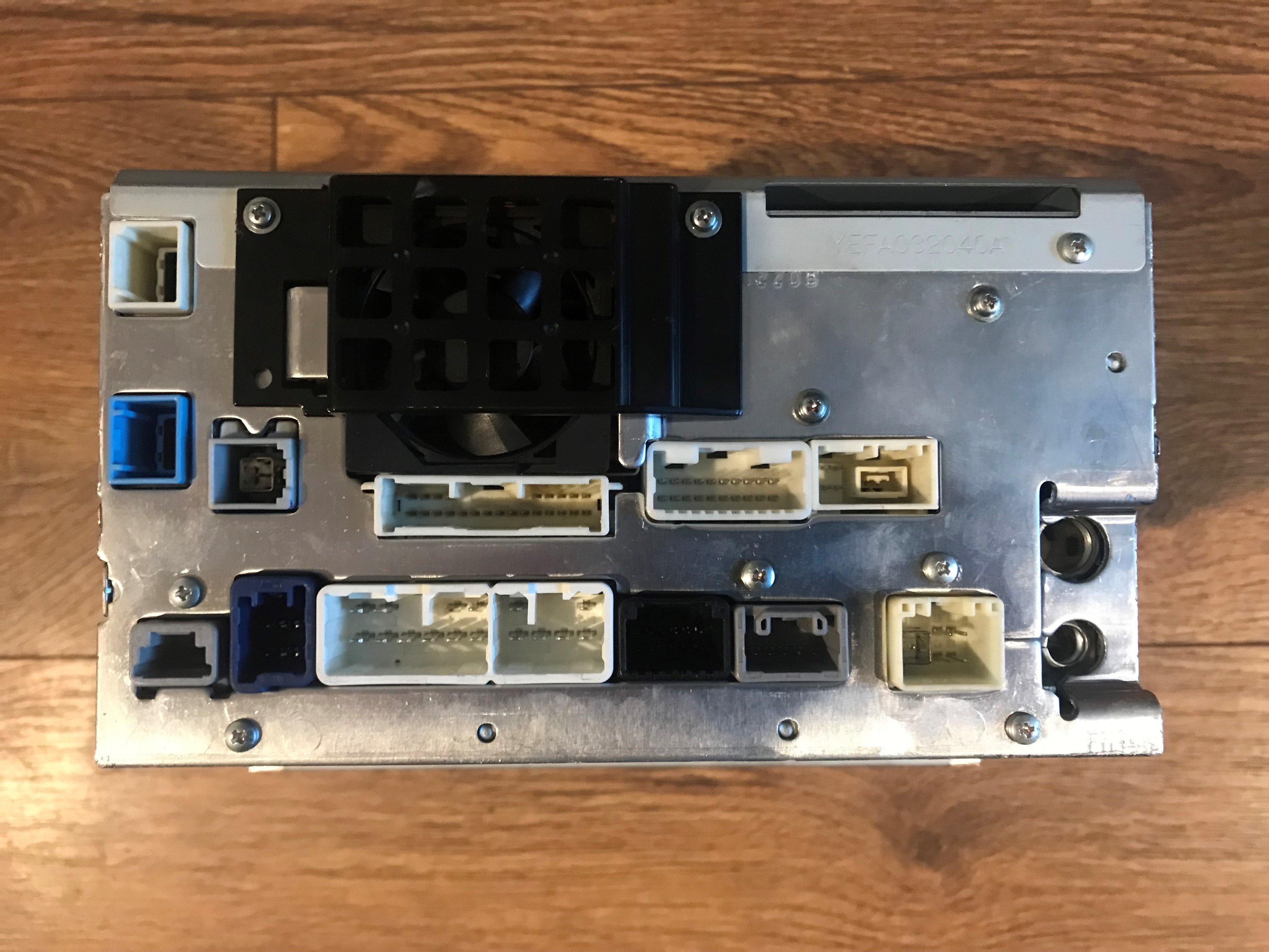

Replaced factory fitted stereo with new android head unit but can't figure out which lead is for the camera's any help please. Everything else works ok even the steering wheel controls. The stereo I replaced is a Matsushita 86100-58011 but it has about 15 sockets, (pictured below) and can't find and user manual for it.

Hi, Mally,
             I'm about to start the same quest to replace my head unit that matches your old one. Did you find out which socket does what and which lead was the camera?
I recognise it's been a while: From what I've found so far the interface into the parking assist ECU is left-hand light blue connector and it needs a LVDS converter: https://www.aliexpress.com/item/1005007374098960.htm to connect into the Android unit.
Hope that helps
