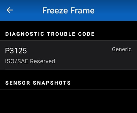

marty Posted July 2, 2022 Author Share Posted July 2, 2022 Quick update..... I managed to get this code using OBD Car Doctor. There's no subcode though. Searches show that it's possibly something to do with the Inverter cooling system or a faulty pump. The car was making a squealing sound when starting up and steadily got worse, so that could indicate a failing pump. Has anyone here changed an Inverter cooling pump? Quote Link to comment Share on other sites More sharing options...
