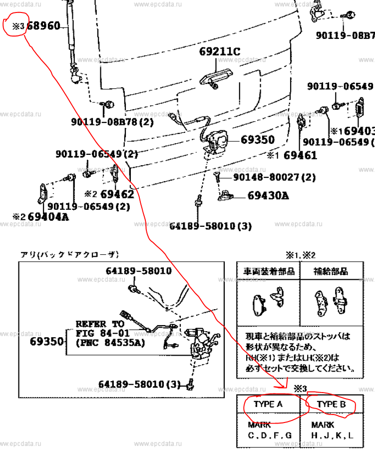

Chris.ac Posted April 15, 2022 Share Posted April 15, 2022 definitely 'break out' boxes that are detailed by asterixis in the drawings dependant on the trim level of the vehicle, for those dampers. Did your old dampers have a letter marking? you look it up in this box and it tells you the type of damper you need. There are ones for cold weather region alphards, and ones for power doors. So maybe subtle differences in pressure which may explain why they are not holding the door up as far? On my old regius I would occasionally almost scalp myself because the door didn't extend fully in the cold. I dont think its the motor, that is only required to get the door to the critical point where the pistons take over 1 Quote Link to comment Share on other sites More sharing options...
Rojie Posted April 15, 2022 Author Share Posted April 15, 2022 Thanks again Chris, You are so helpful, and so reliable. I am kicking myself. I cannot believe I overlooked this. I saw the asterisk 3 and ignored it, poor concentration ! Must have been another late night. I have looked for markings before, without any real success. Most is hidden by the strut itself. However, now I know what I am looking for, I'll look again. At £25 spent I'm not too bothered about it. I'll look for markings and get on Amayama. Thanks, once again. 1 Quote Link to comment Share on other sites More sharing options...
Rojie Posted April 15, 2022 Author Share Posted April 15, 2022 Hi Chris, I have been checking the EPC (again and again). I had been focusing on trying to find a standard unit that fitted across all Gen 1. Silly really. Now, after your prompting, I can see there are 5 options for my model year. I'll get my Google Translate on it tomorrow. Try and decipher the variants ! Quote Link to comment Share on other sites More sharing options...

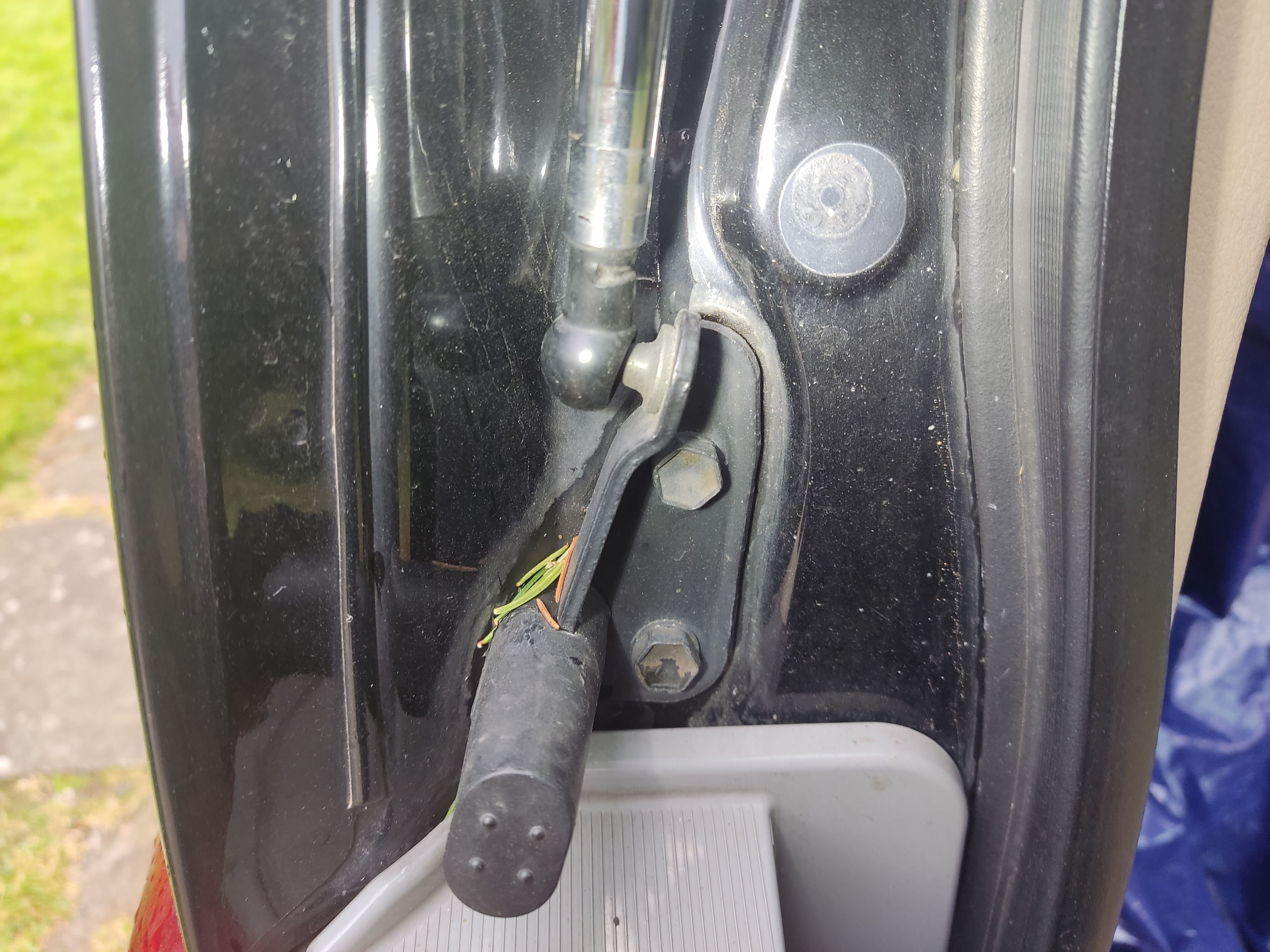

Rojie Posted April 19, 2022 Author Share Posted April 19, 2022 Hi Chris, I finally got around to checking which tailgate struts I have. Annoying thing is all the wording is in Japanese; except for this very large, and obvious, letter K ! Until your message, because of my oversight reading the EPC, I had not paid any attention to it. Talk about can't see the obvious ! My struts extend almost fully, just half an inch extra if I push them to their maximum extent. I have decided not to renew them yet, but wanted to thank you again for your help. Just to satisfy my curiosity I still have to decode/translate the several Amayama options to find the correct one. There's always something else to do, isn't there. Quote Link to comment Share on other sites More sharing options...
