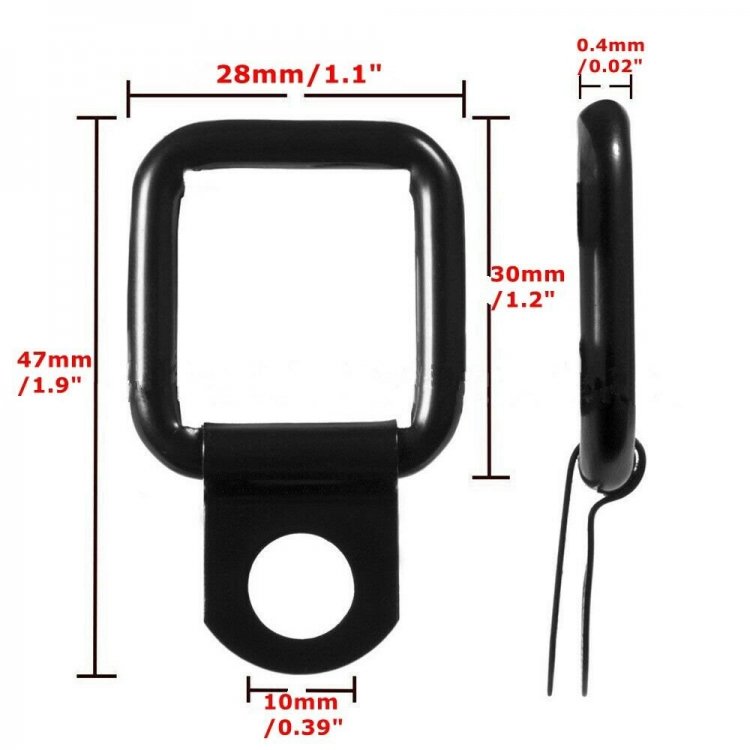

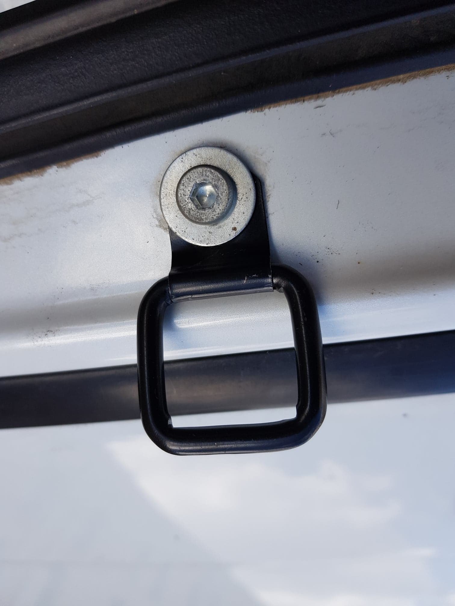

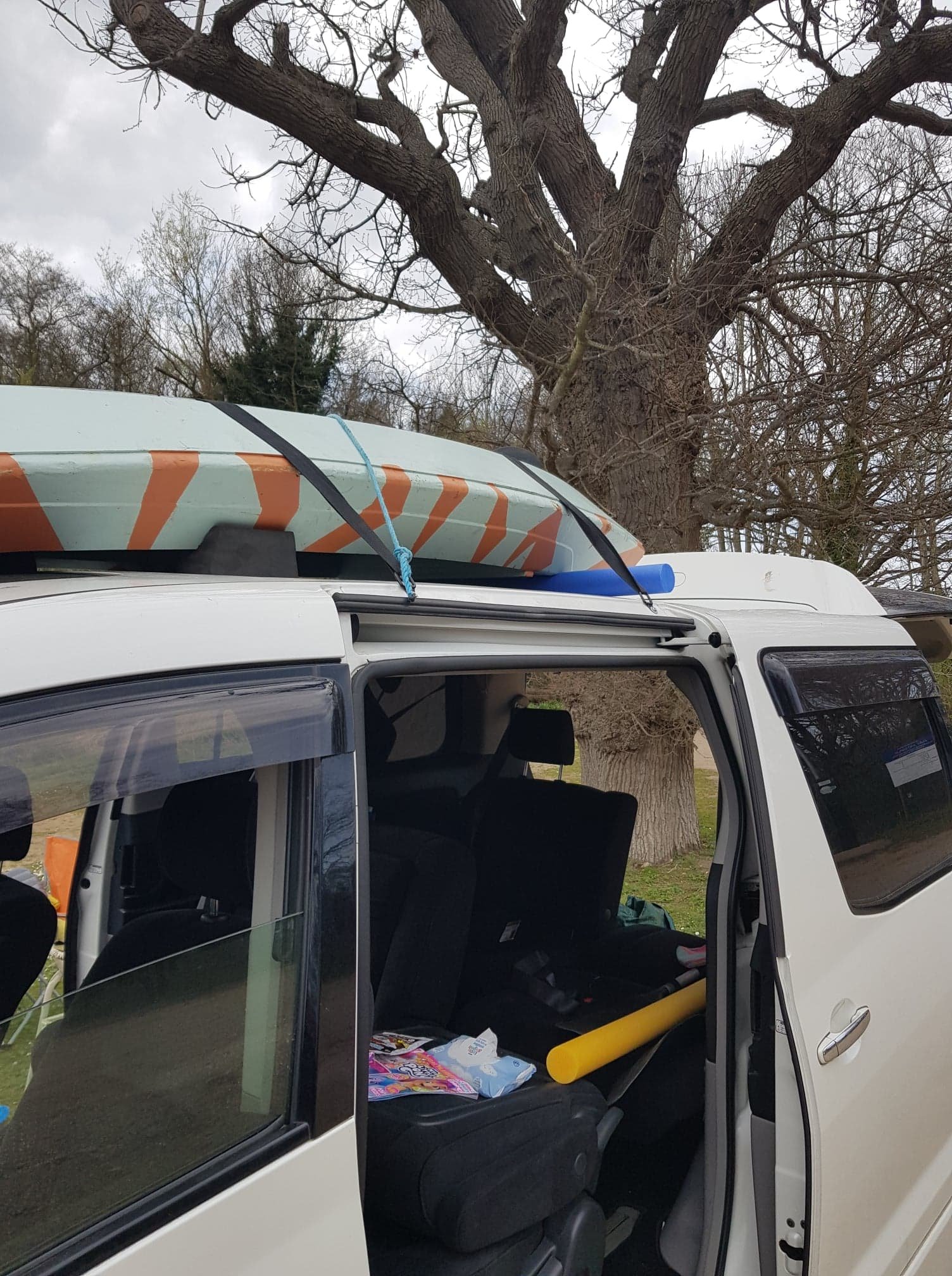

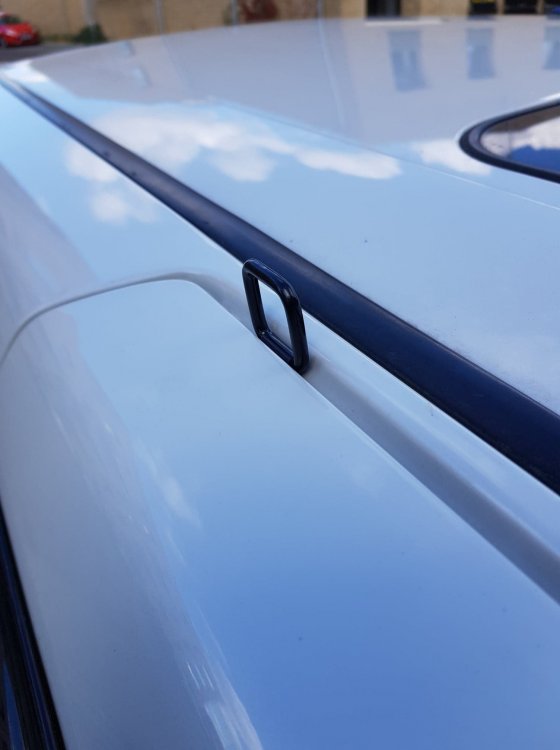

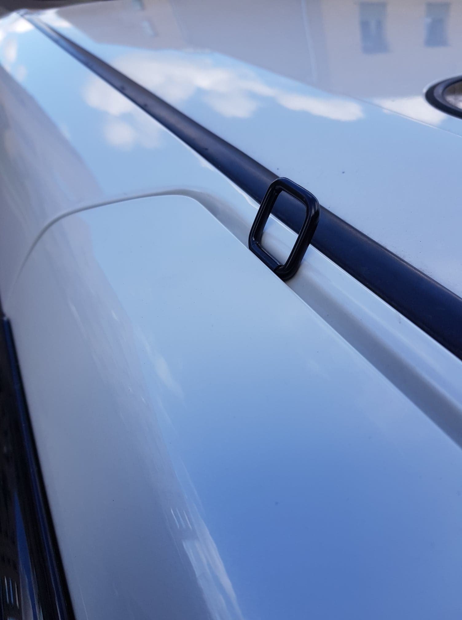

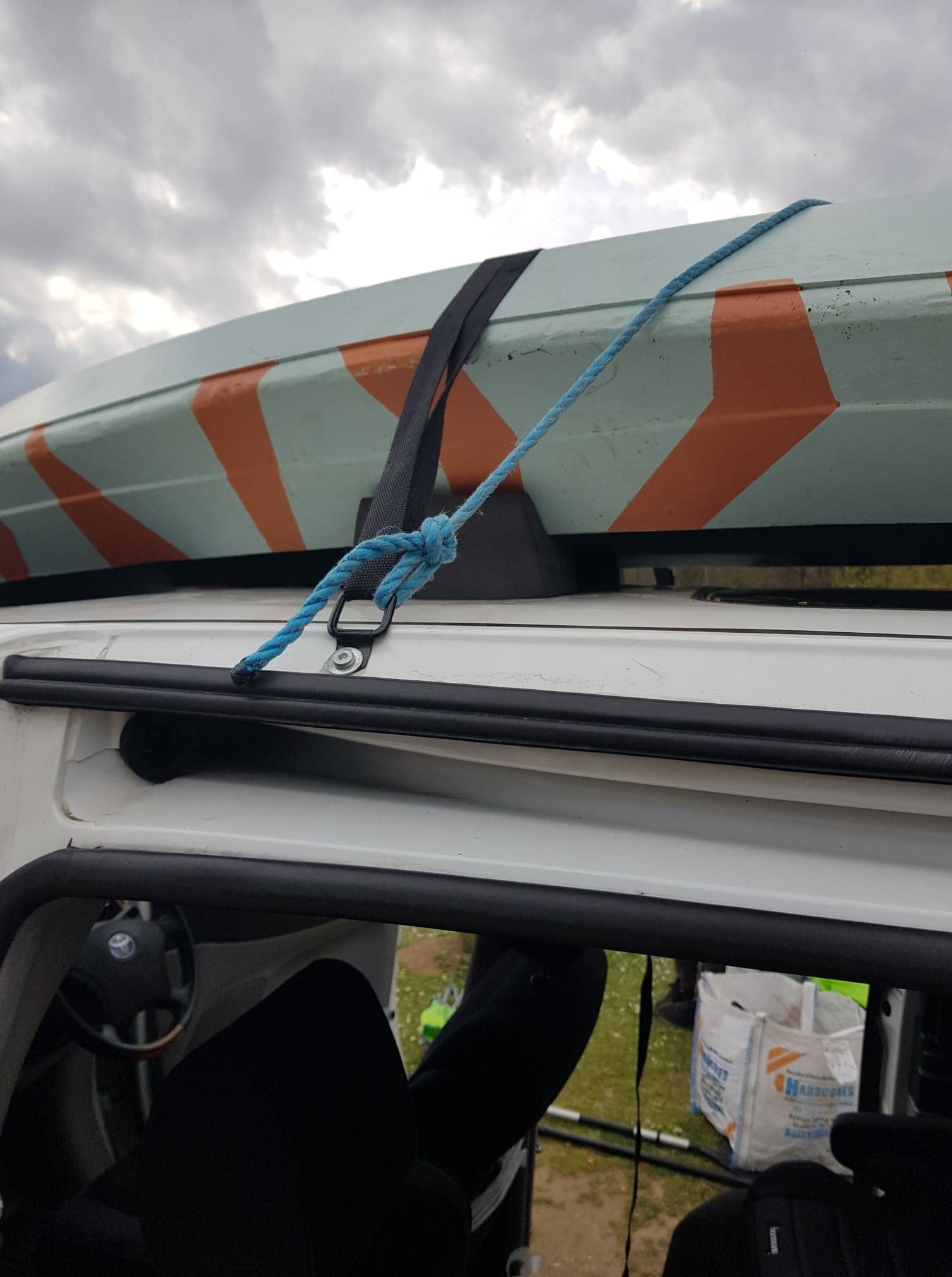

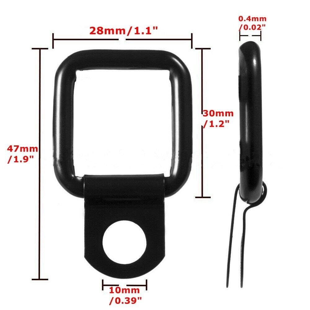

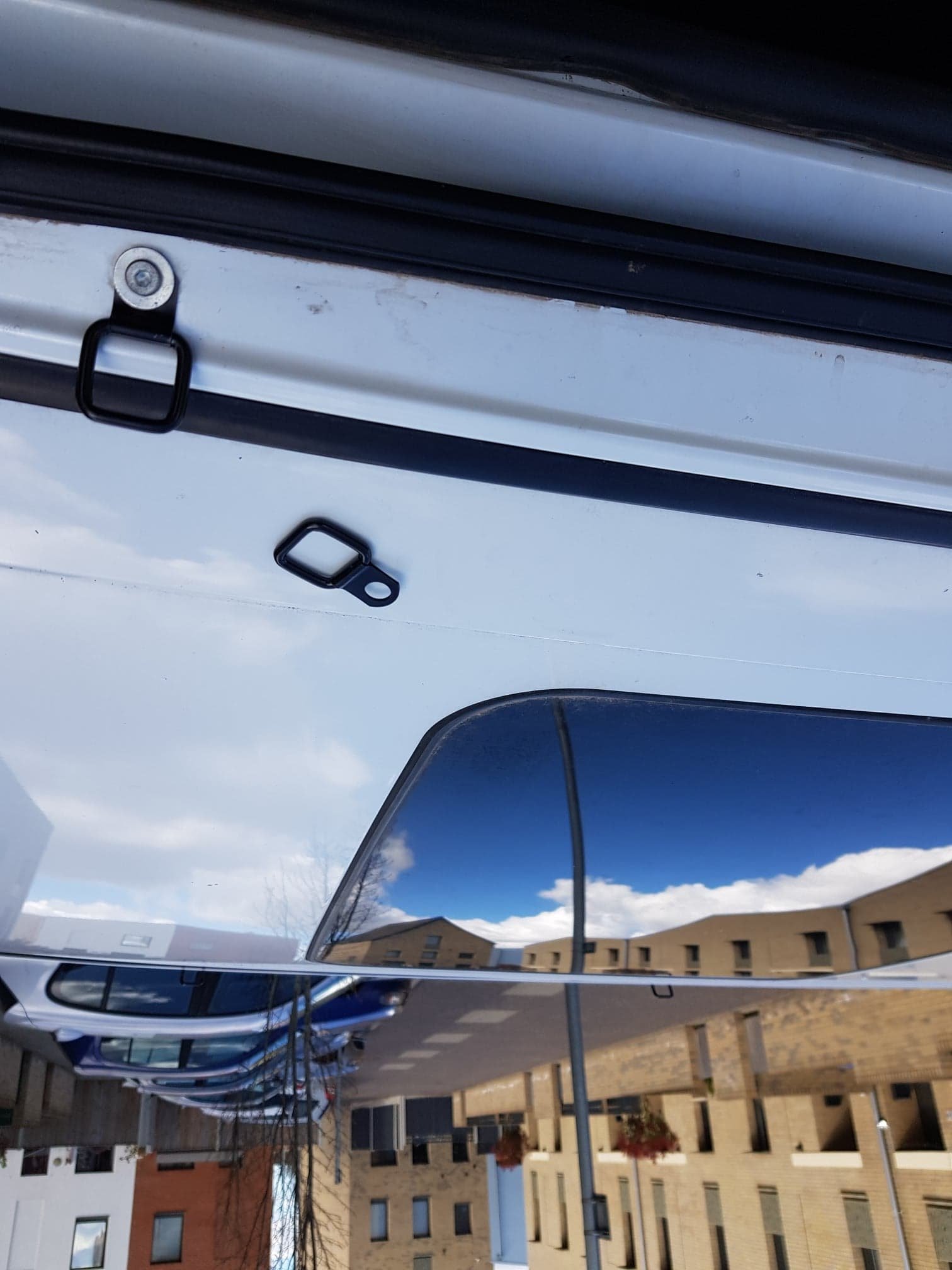

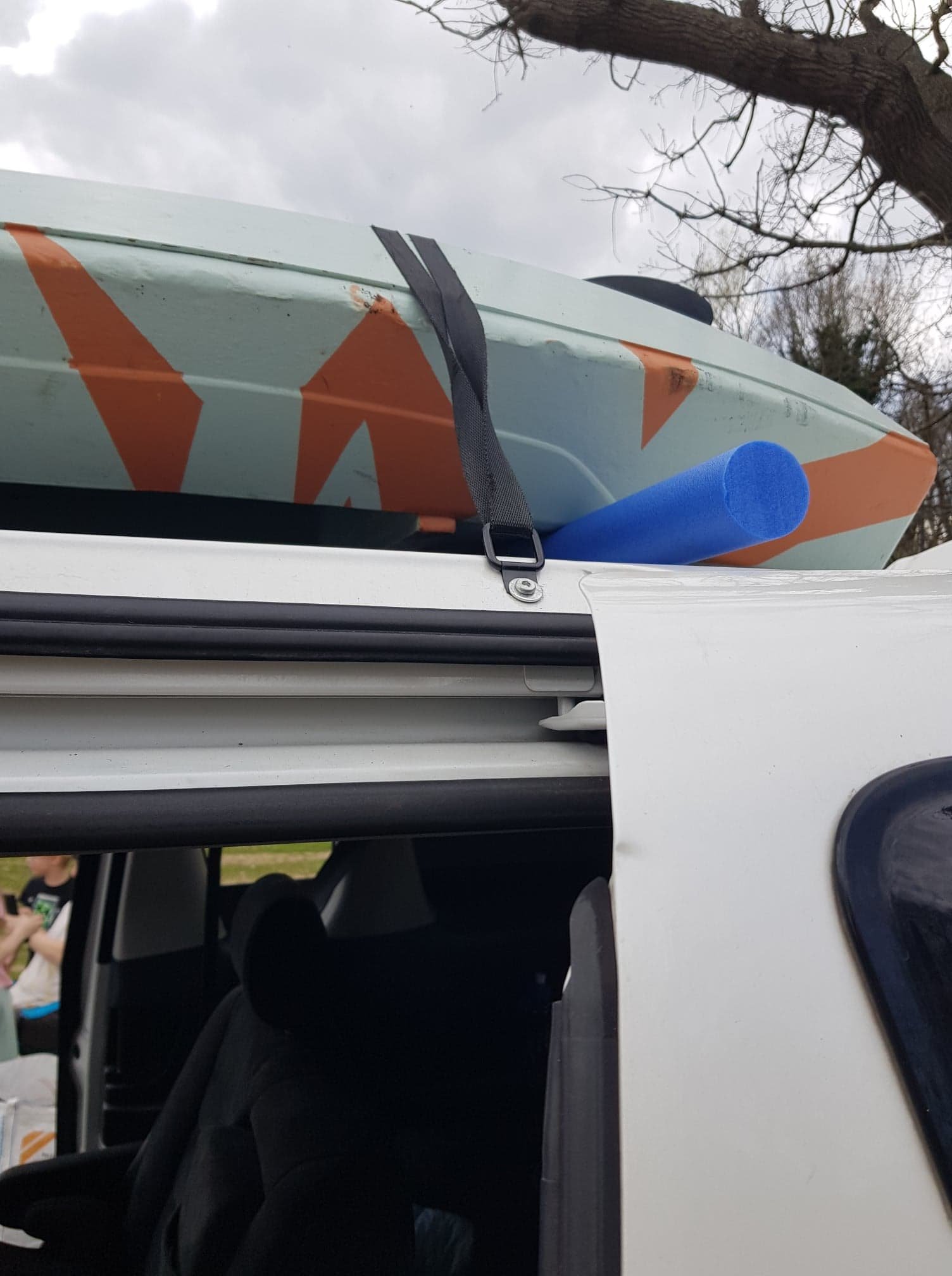

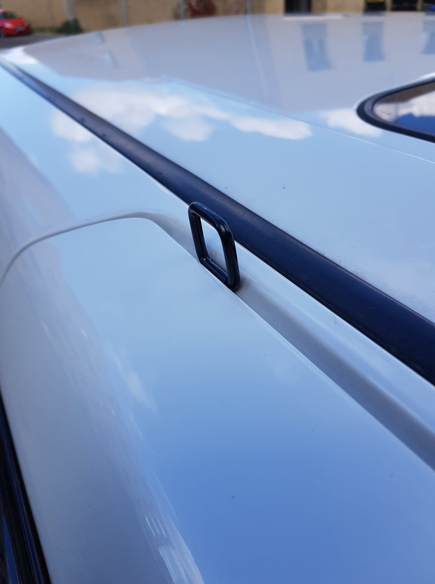

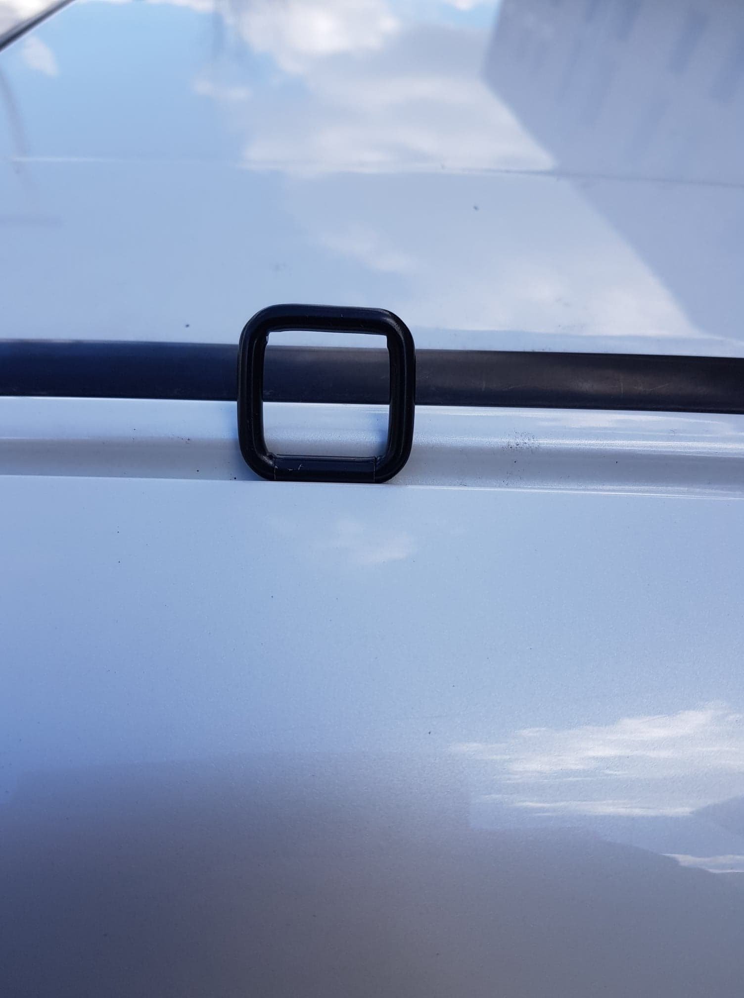

I need to transport the kayaks. Heavy duty D-rings, bolts with washers and I now have 4 solid tie points. They fit flush, dont grab or scrape the door rubber and with some pool noodles to protect the roof should be ok.

  • How do you get at the nuts ?
The holes are threaded, no nuts needed.
So are the holes existing, or have you drilled and tapped ?

It certainly looks extremely neat.
Thanks for sharing it.
The threaded holes are there, just remove the plastic insert.

I bought them off ebay, just a few quid
