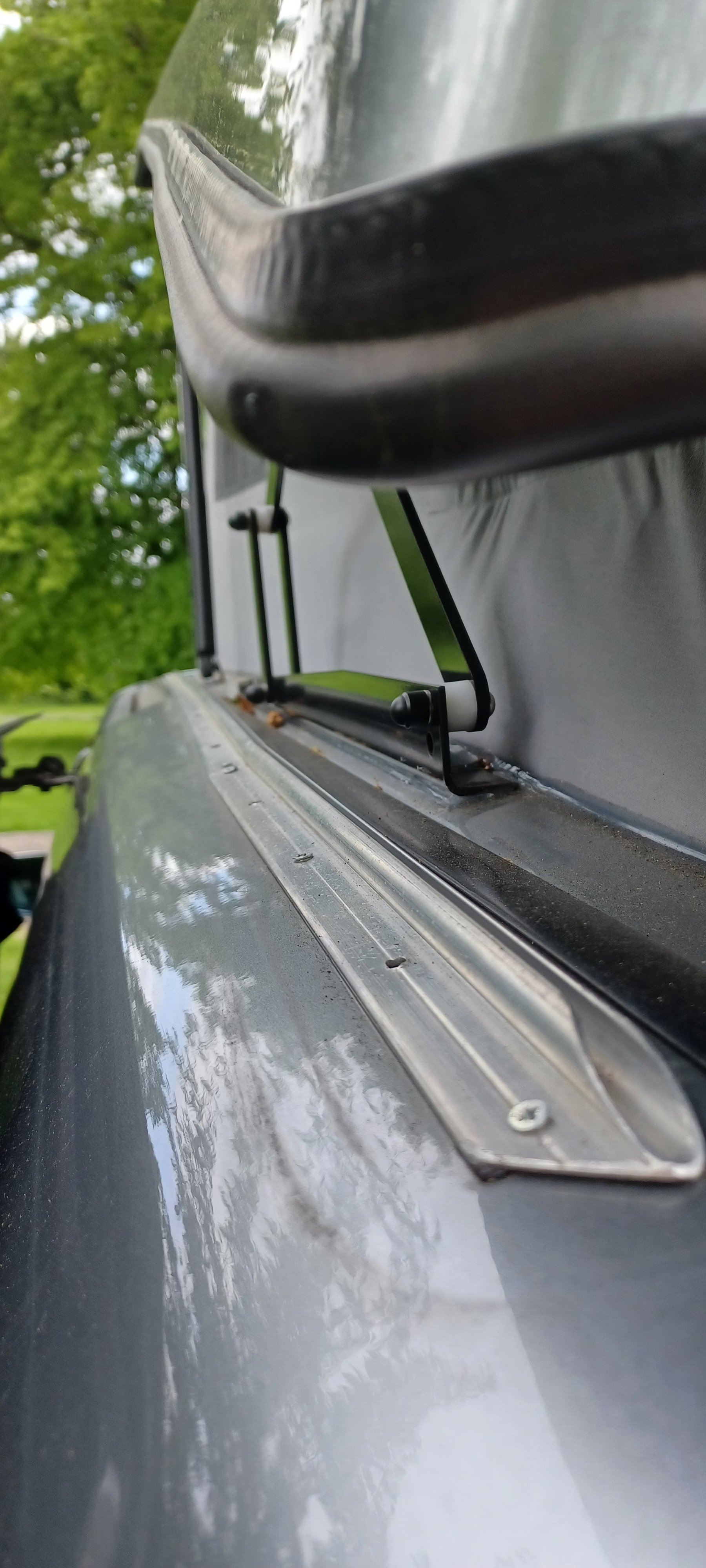

Were away in it tomorrow, so when I pop the roof, I'll take a photo & post up here ok....bear with.

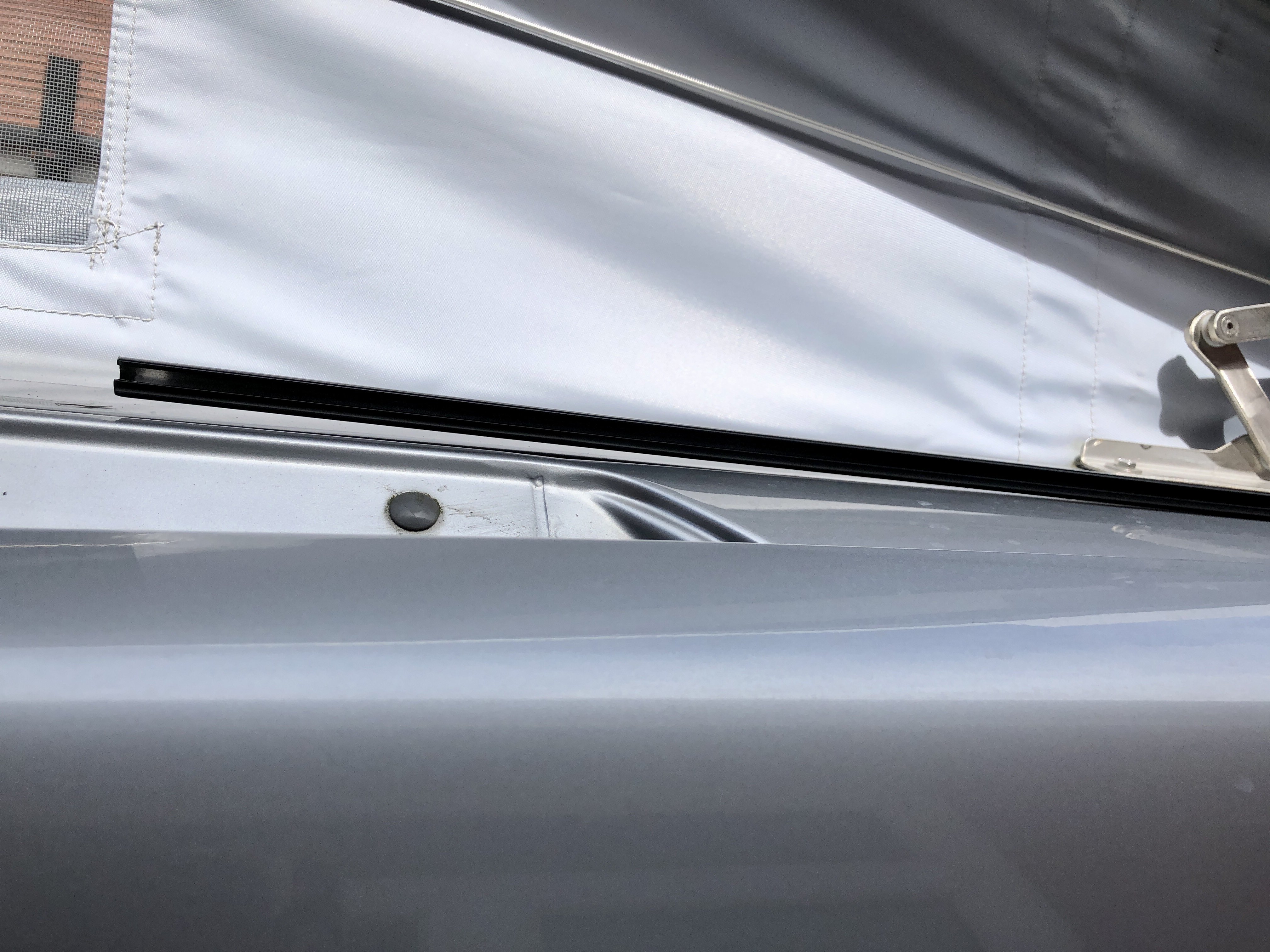

On 5/13/2022 at 2:39 PM, Pritch said:
Thanks Pitch, that looks the business. I think your roof cover may be a bit wider than mine looking at that.

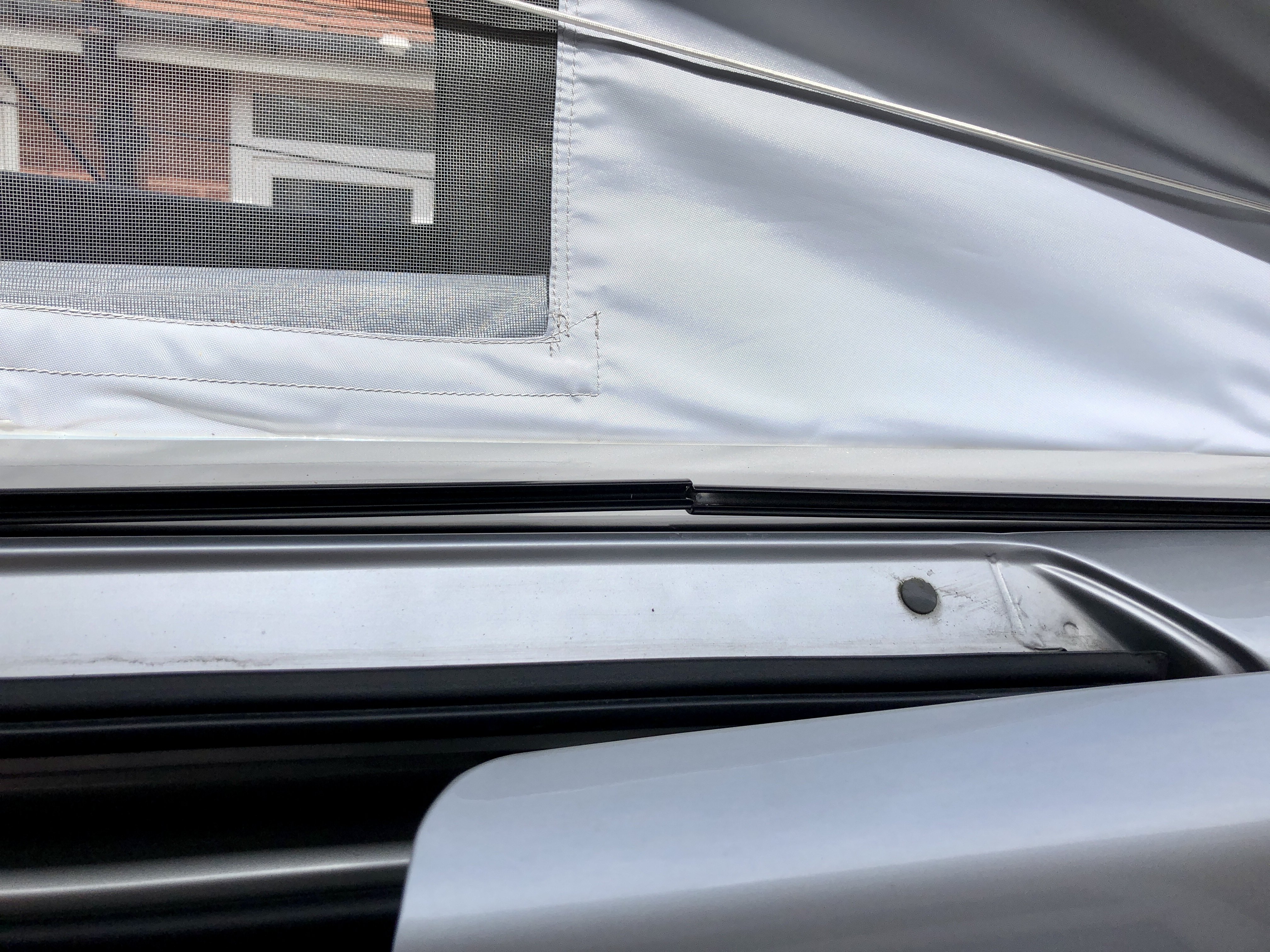

Ah ok sorry, hope these work :-
A question, is the rail in one length or in sections? Thanks.
Now there lies a tale......
We order (prior to build) the 260 length awning they said they could fit to the van & paid accordingly.
Once we got home we realised the awning was just 180cm, wont go into details of the arguments we had, but they agreed to fit the max length they could, that would stay inside the pop top once closed which was 131 cm...better.
Sorry long answer to simple question, but yes it is, it has an extra 51cm extension added to fit.

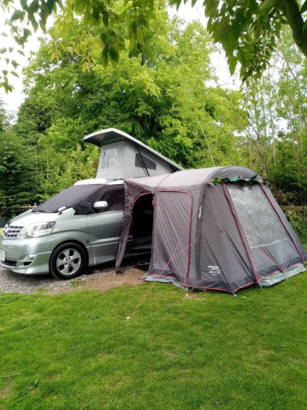

We bought the Vango Faros II Air, as the attachment strip is 2.4 w, so easy fits, but only with a small overhang.
We tend to attach the storm strap to the front end over the front behind the spoiler, and peg on drivers side, this just holds up the overhang, but it works a treat (see pic).

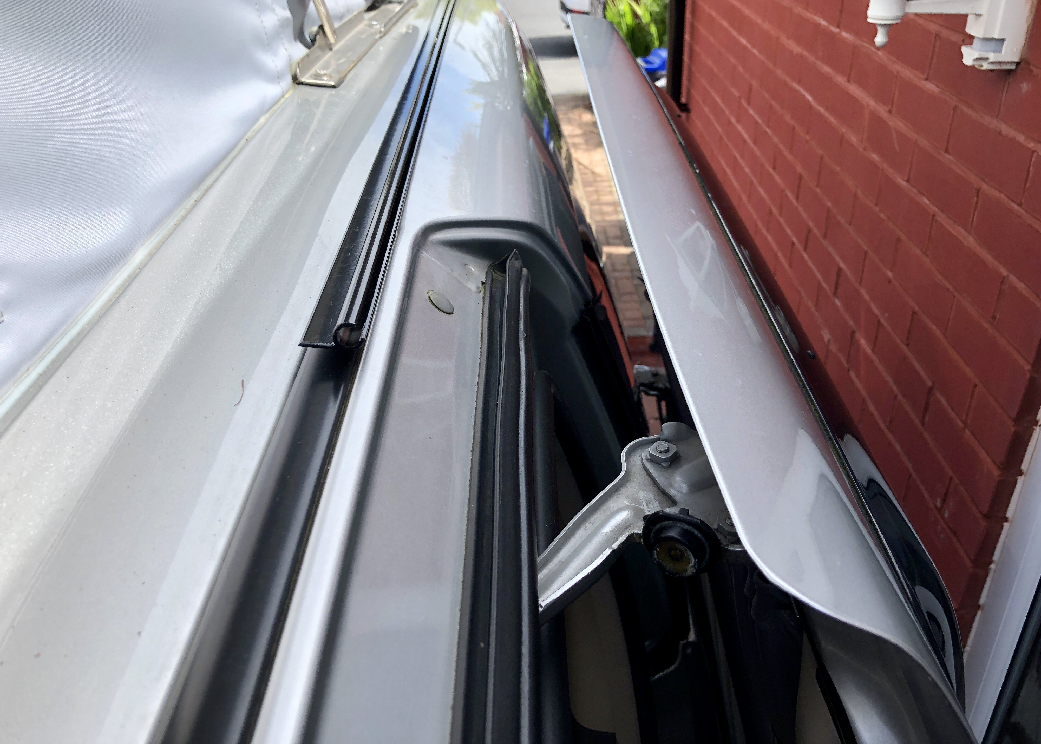

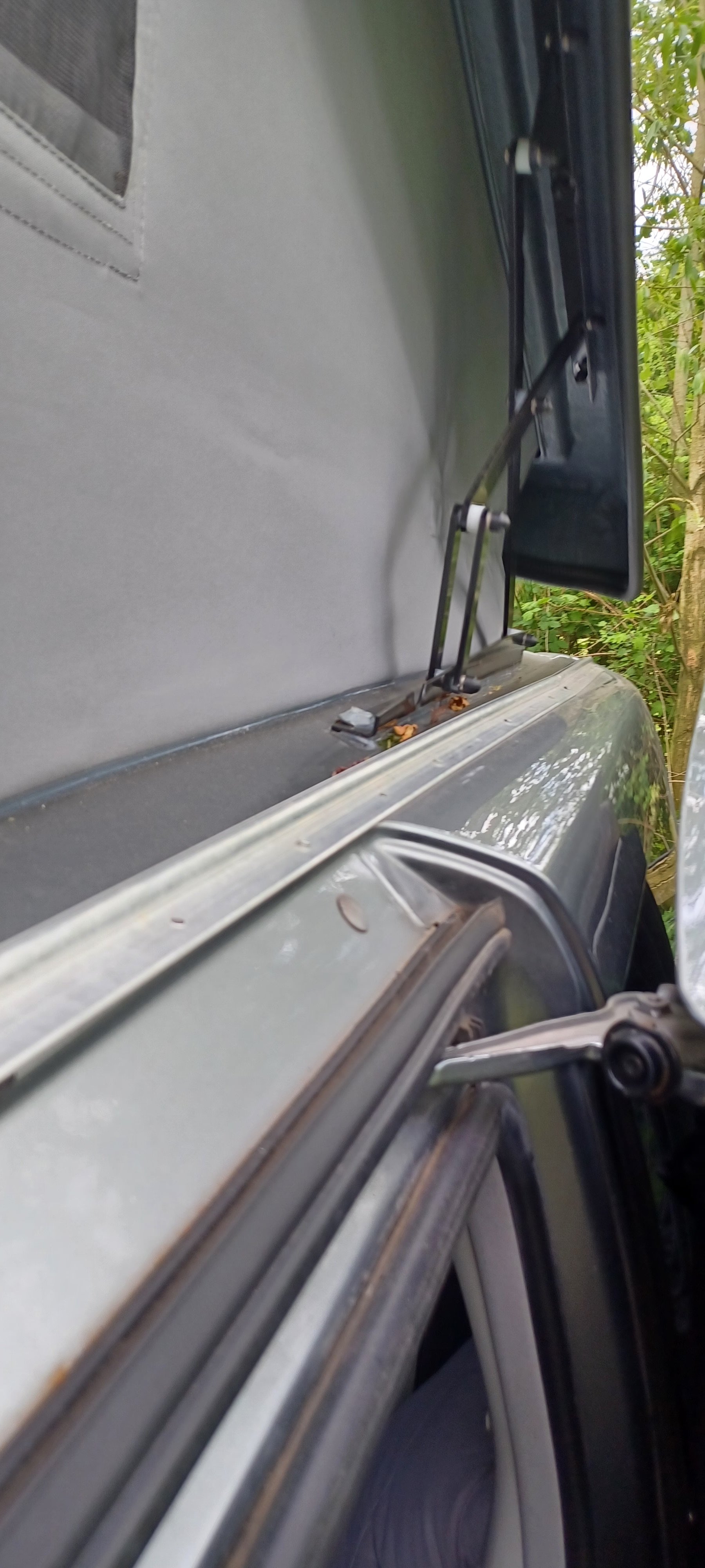

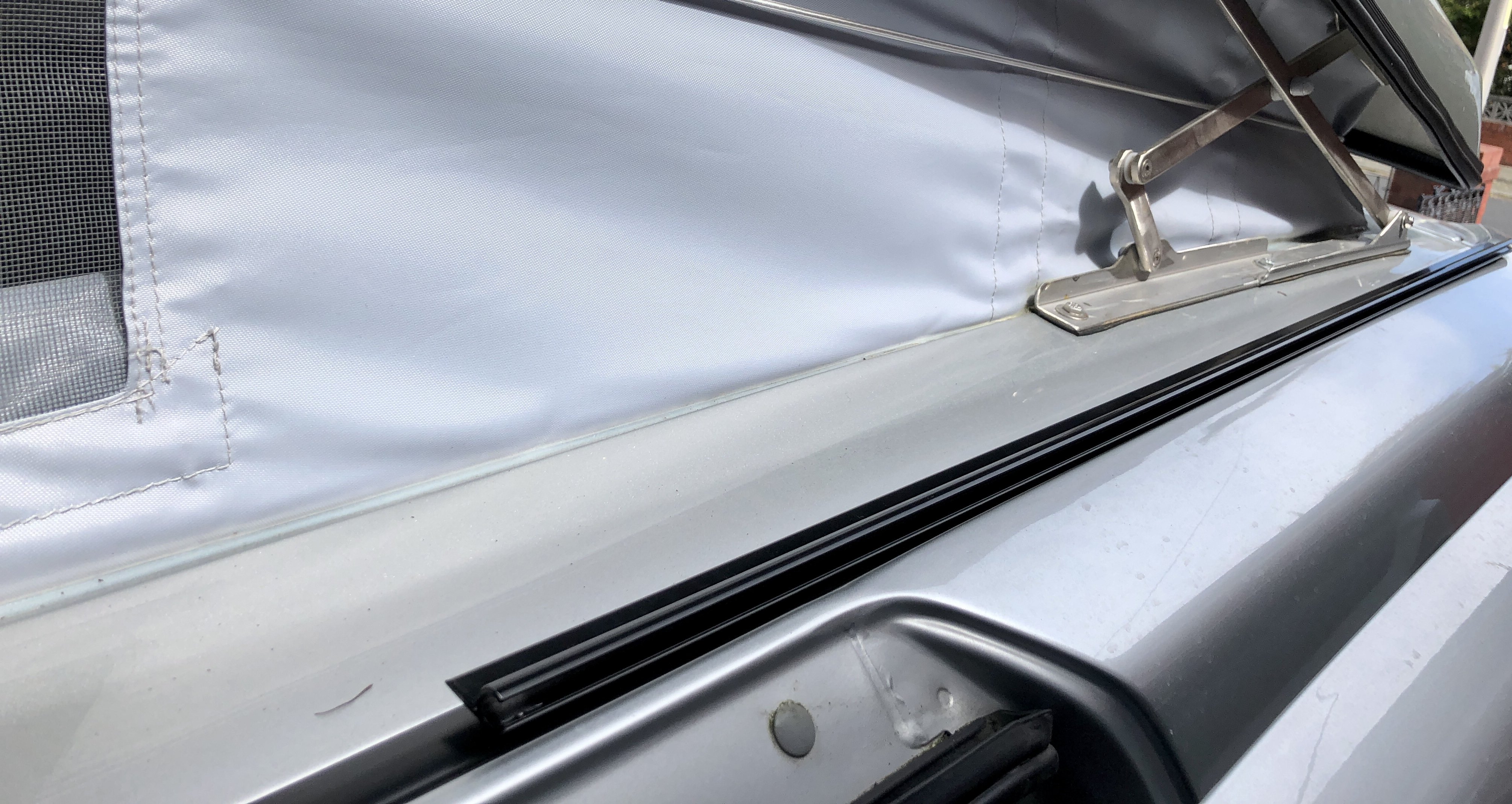

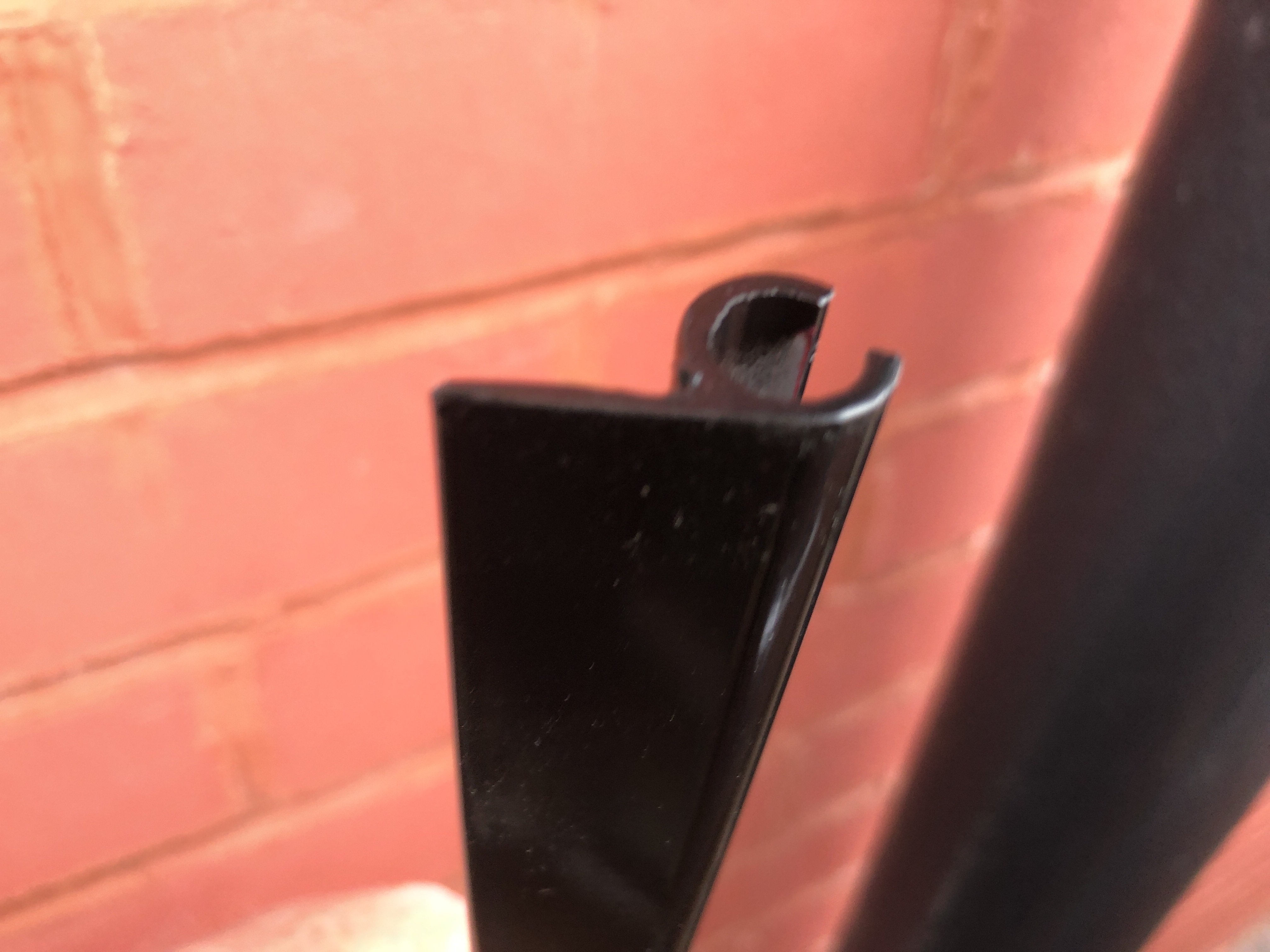

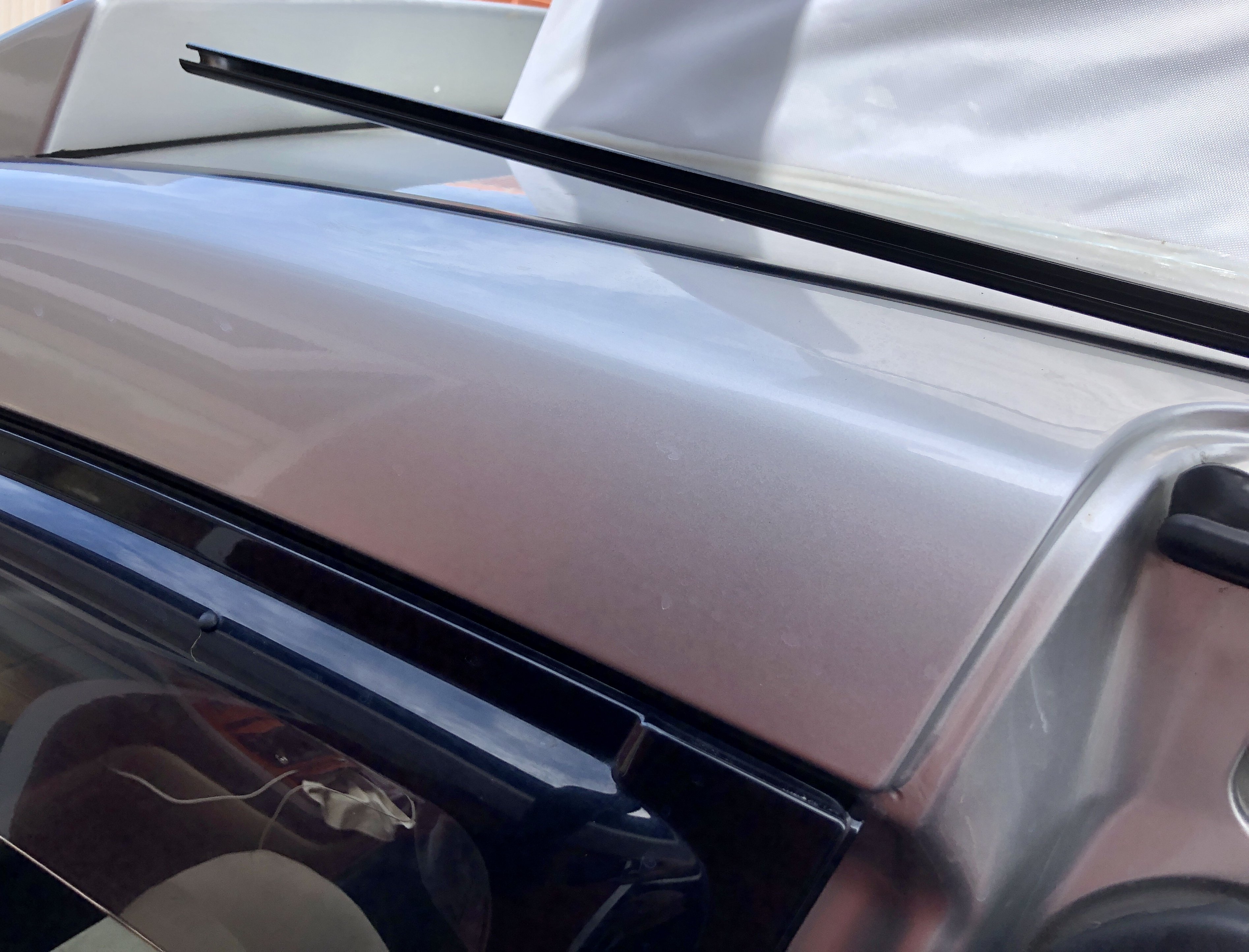

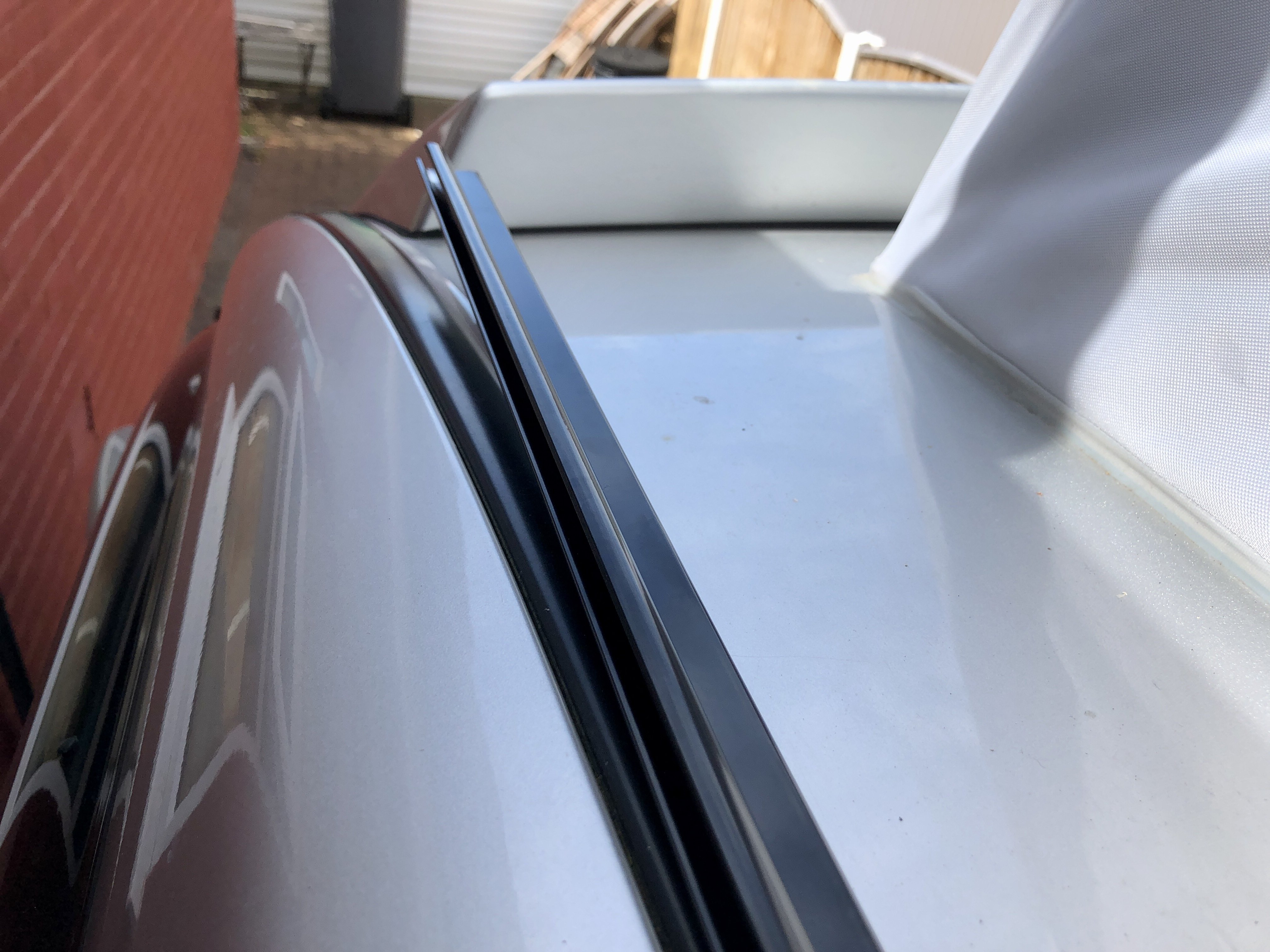

I've just offered up 2 x 1.2m C rails to the van to get my head round how I'll fasten it. The rubber trim that runs the length of the van roof is the perfect width to take the rail and it just pops in and out easily. I'm think about seeing if I can put some cuts in the awning rail to allow me to bend it to the shape of the roof where needed, then screw it to the black rubber trim and put that back in with added blobs of high strength adhesive of some kind. I think with it being laterally secure in the roof channel it would hold well with the added 'glue'.
Anyone got any tips they can share or a better idea where to fix?

Looks great, my only question is if your fitting to the rubber strip, its obvs there for a reason, so by covering it up will this not affect something else, water run off ?
Most people I have sen/heard tend to suggest Silkaflex Glue and galvanised (wont rust) screws, and affix to the bodywork (like mine) but so its sits inside, the pop top when closed.
Personally, I would get an expert to fit it, but thats just me.

It's a good question as to the purpose of the channel and rubber infill. I assumed there is a weld under it and it hides that join but not sure. I thought sika flex across the entire length of the channel insert would hold that pretty firm, but I'm not so sure the screws would hold well in just the rubber. Maybe need to use small bolts or rivets.
