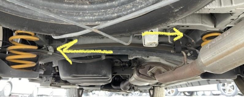

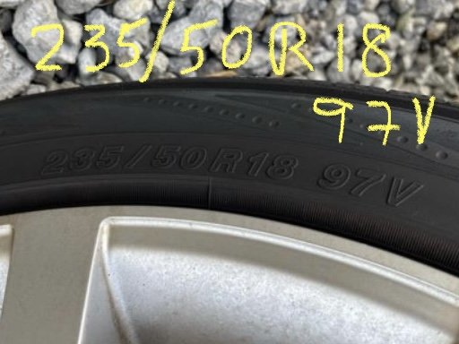

Some Alphards have 18 inch wheels? Why? I'm looking at buying one that has 18 inch and some funny YELLOW coil springs? Anyone knows what is going on here? Should it be a red flag? Avoid such car or are these desirable? It's Gen 2, 3.5L v6 if it matters. Please see the pictures! Thankyou 👍
235/50R18 97V
Wonder if 18 inch alloy wheels be used to put winter tyres on them? Traveling to Europe in winter you need winter ones. Are 18 inch any safer or unsafe than 16/17?

It is a common practise in Japan for Alphies to have more 'glamorous' wheels fitted.
With larger diameter wheels you need lower profile tyres, to maintain the correct rolling circumference / distance.
If you don't replace with very similar rolling distance you will change the gearing and your odometer will be affected.
Fitting larger wheels with lower profile tyres will make the ride harder.
Regarding the coil springs, these can be changed to lower the vehicle, that is to reduce the ground clearance.
When you come to insure it you should, probably, inform your insurance company as they may regard these changes as modifications !
If you need to alter it back to original; I think picasso recently advised about £1200 !

Just an aesthetic choice since bigger wheels became more popular. I prefer to have as big a tyre side wall as possible to improve ride and avoid any accidental wheel damage.
I'm not sure there are any downsides to having smaller wheels/bigger tyres but could be wrong.

There are web sites that will allow you to calculate alternate wheel sizes, tyre sizes, inset, offset, etc.
What is most important, is the clearances within the wheel arches under dynamic conditions.
Not only is rubbing dangerous, it can be costly in terms of renewing parts.
