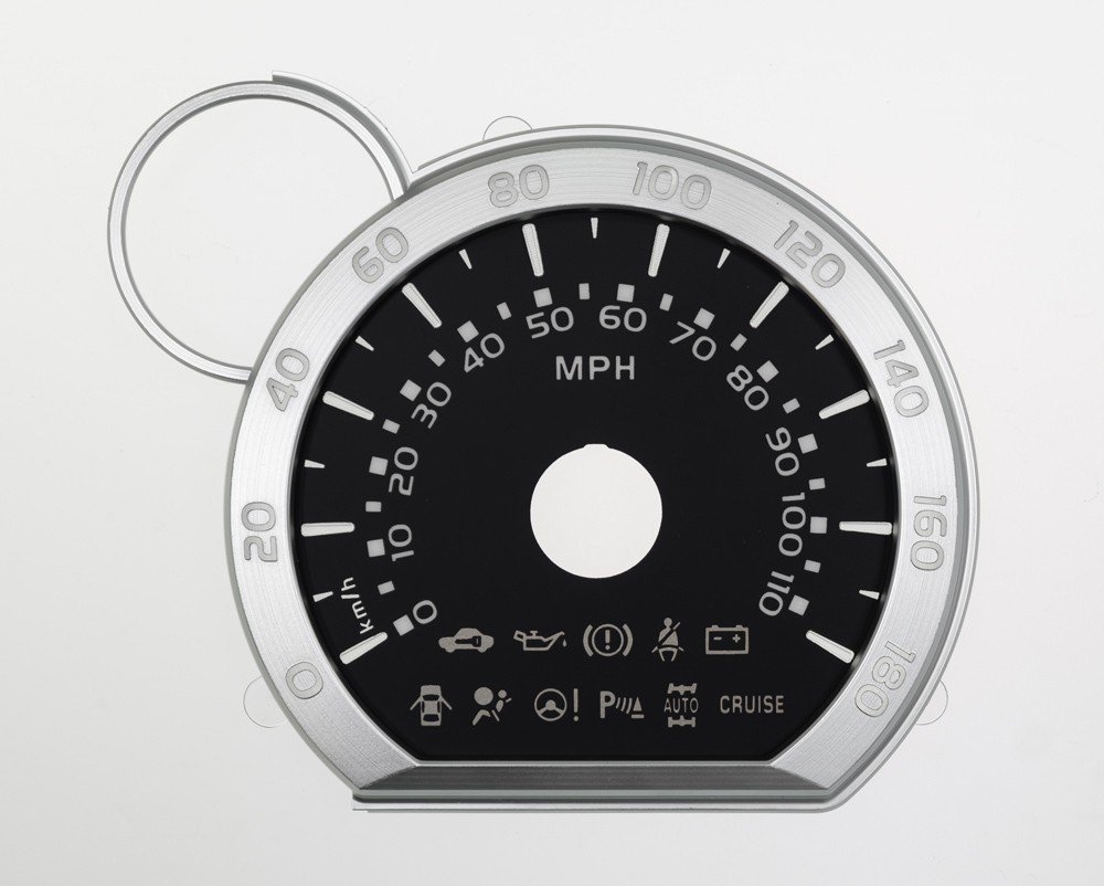

If the speedo has a bit of black tape over the "K" in Km/h, then its got a pulse converter on it (it reduces 4 pulses from the speed signal to 3), thus all the values in the cluster will be Miles.... Miles per Litre, the speedo reads mph, the odometer clocks miles.
If the cluster has this type of face, with mph in the middle, then all of the values read KM's... odometer, litres/km etc etc
I imported my own and did all my own conversion and registration paperwork etc - and I'm in the autoelectronics industry so know exactly how the cluster works etc.
