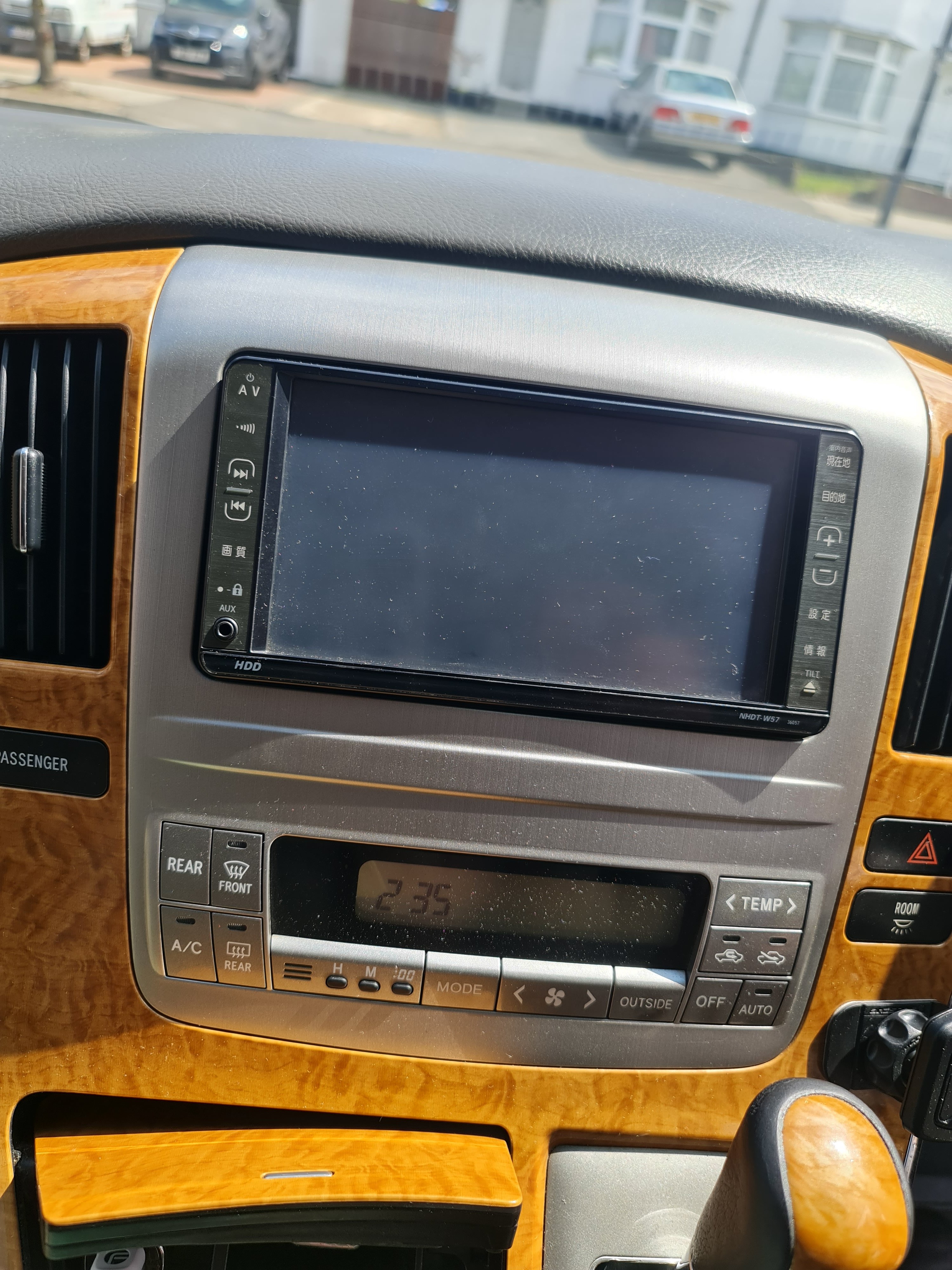

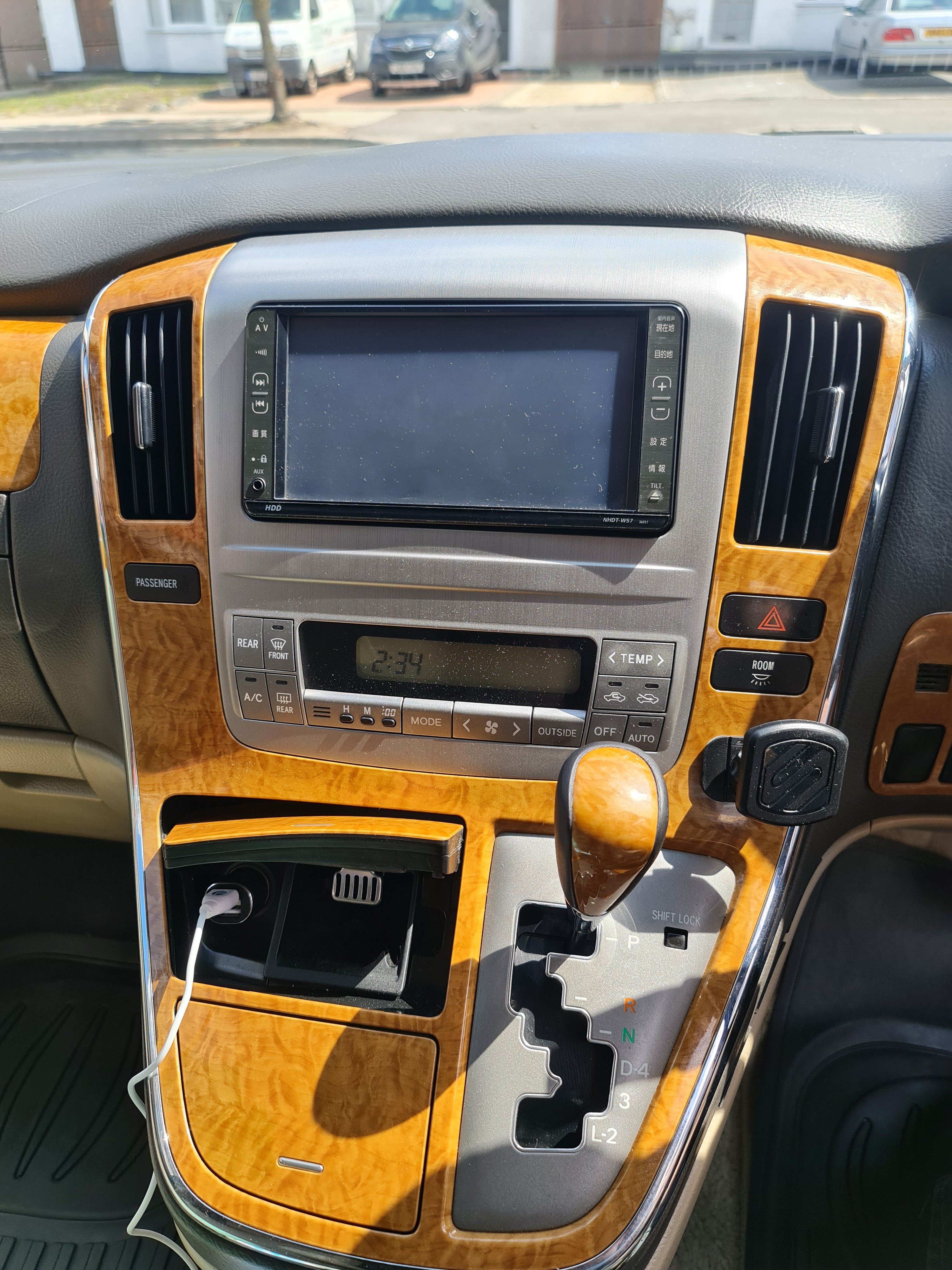

Hi everyone,
I would like to swap over a double din radio CD/DVD, as the one I have is in Japanese and I do nit like it.
Is anyone here to direct me in the right direction how to retain the rear DVD working? What is necessary is I buy Pioneer unit for connecting with the rear DVD
