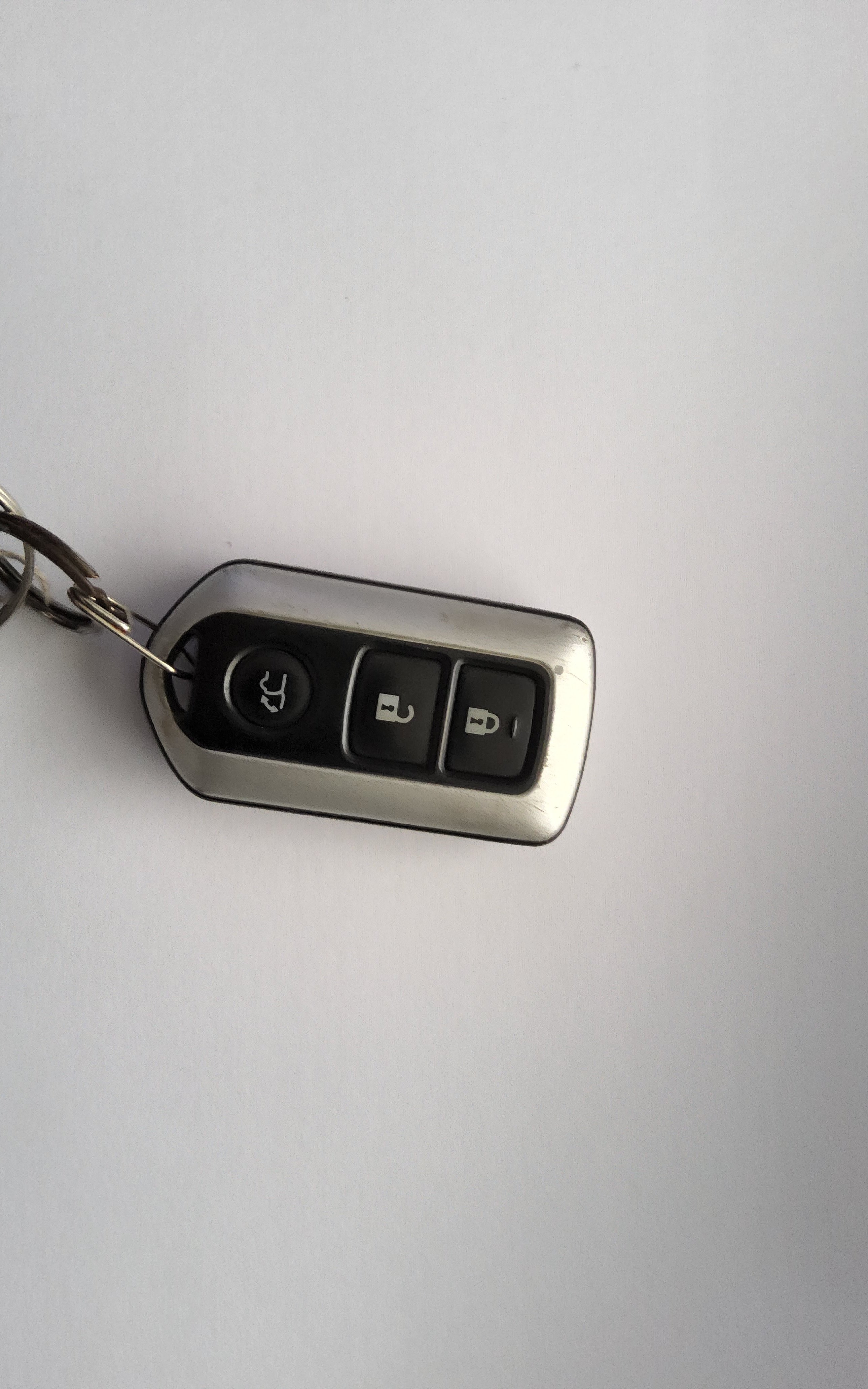

Thanks for that. The jpnz English manual I have suggests I have the incorrect key fobs as no boot function on it......will annoy the dealer who supplied for advice.

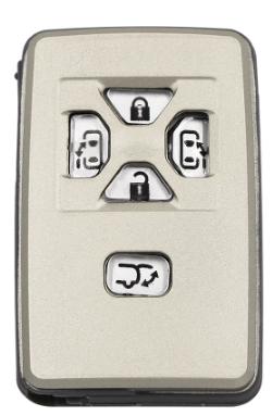

This is the key fob you should have its also a smart key for keyless entry the bottom button near key ring is the tailgate button

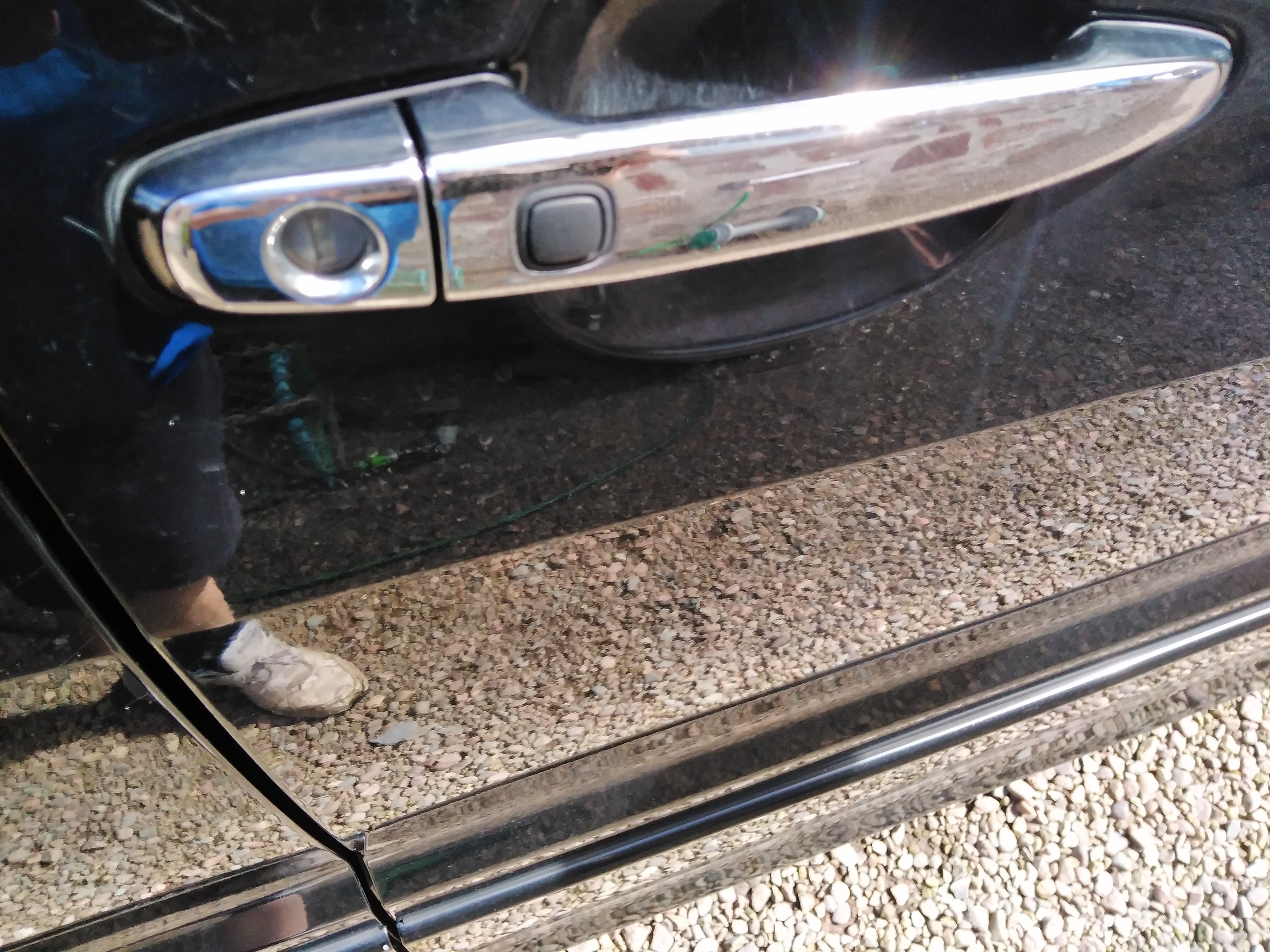

Thanks again. Have attached the keys I have. It wasn't sold as having keyless but I'm guessing from the button on the door handle it does? Is that a right guess do you know?

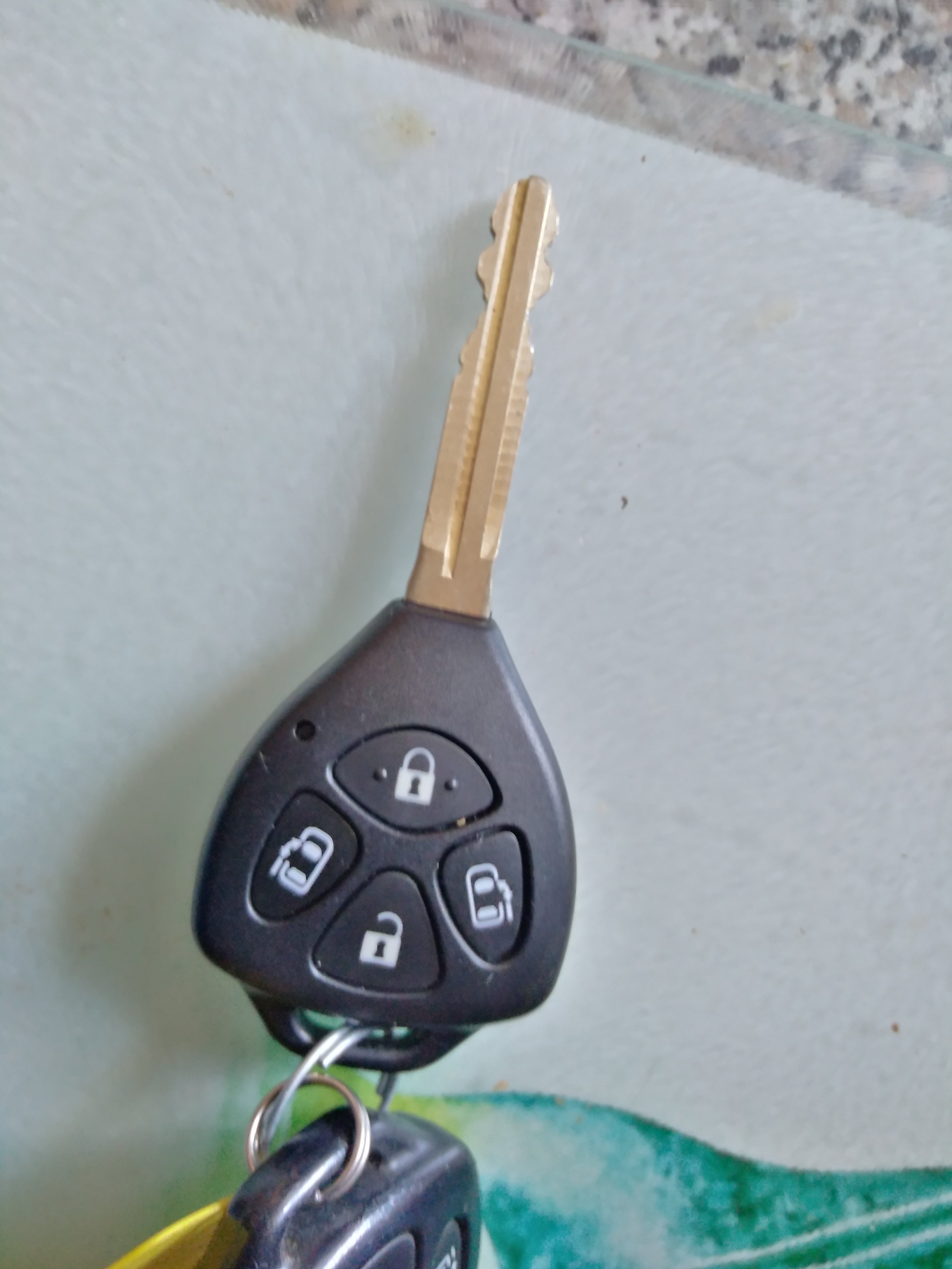

I have a 2009 which has remote boot. It will close electrically in the car, with the keyfob and with the button on the boot, but will only open electronically with the keyfob or in the car, which is strange in itself but normal. I don't know why they did not wire up the handle as they did with the rear sliding doors.
This is my keyfob. You can get them cheap on Aliexpress and code them, but not sure how. I am sure there is a post on here to tell you somewhere.

The Gen 1 and Gen 2 systems are different.
Lanciaman needs the one that is in the Picasso photo
In that case I have no idea where to get one lol
Thanks both.  I can get the smart key. However, zero idea how to get it programmed or to match my own Alphard.... At least yet.  I shall persevere.
OK. A good starting point.....
Thanks to all and drahpla on this. Smart key obtained and getting programmed this week.

Hi. I am a bit late to this, but can I ask where you got the smart key and programming? I have the same key and button on my driver's door and tailgate on my 2008 series 10. I am not actually sure if my tailgate is auto as there appears to be no button in the car for this, and I do not have the fob. I'm based in Glasgow. Any guidance would be great. Seems quite a few owners have a similar issue - a mysterious black button but no fob.
