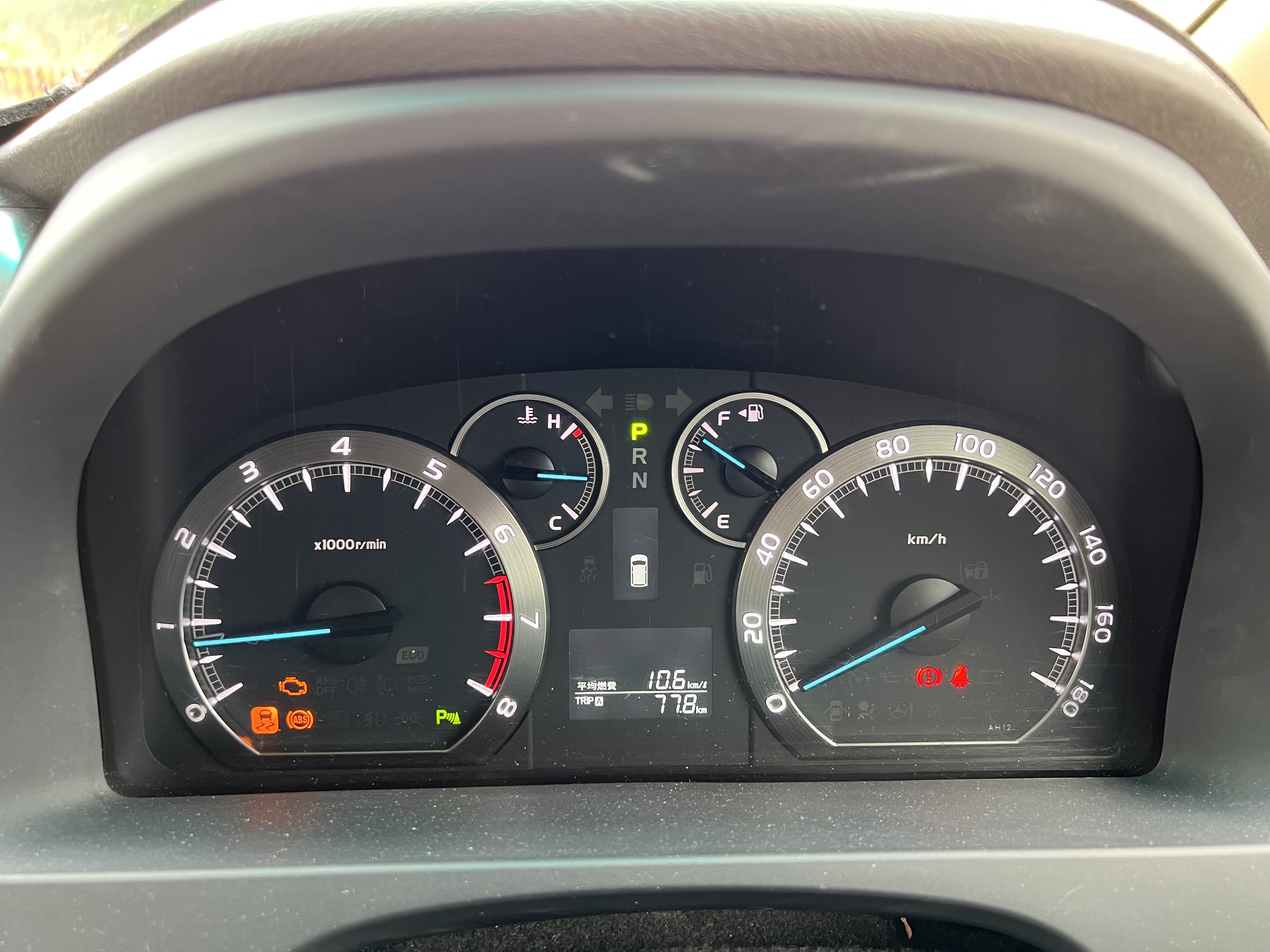

Any garages are close to Oxford and know well about Vellfire and can help me fix my problem??

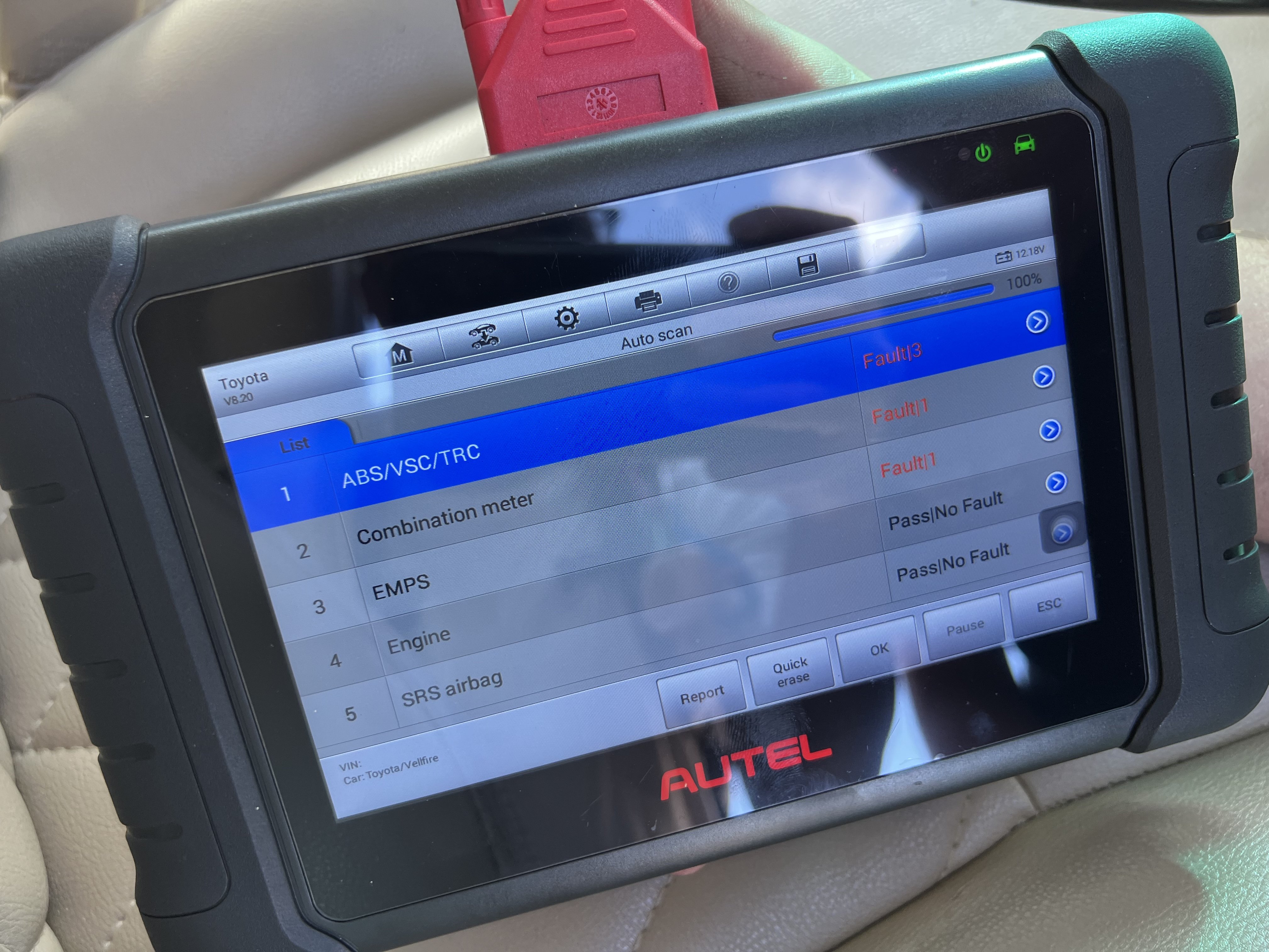

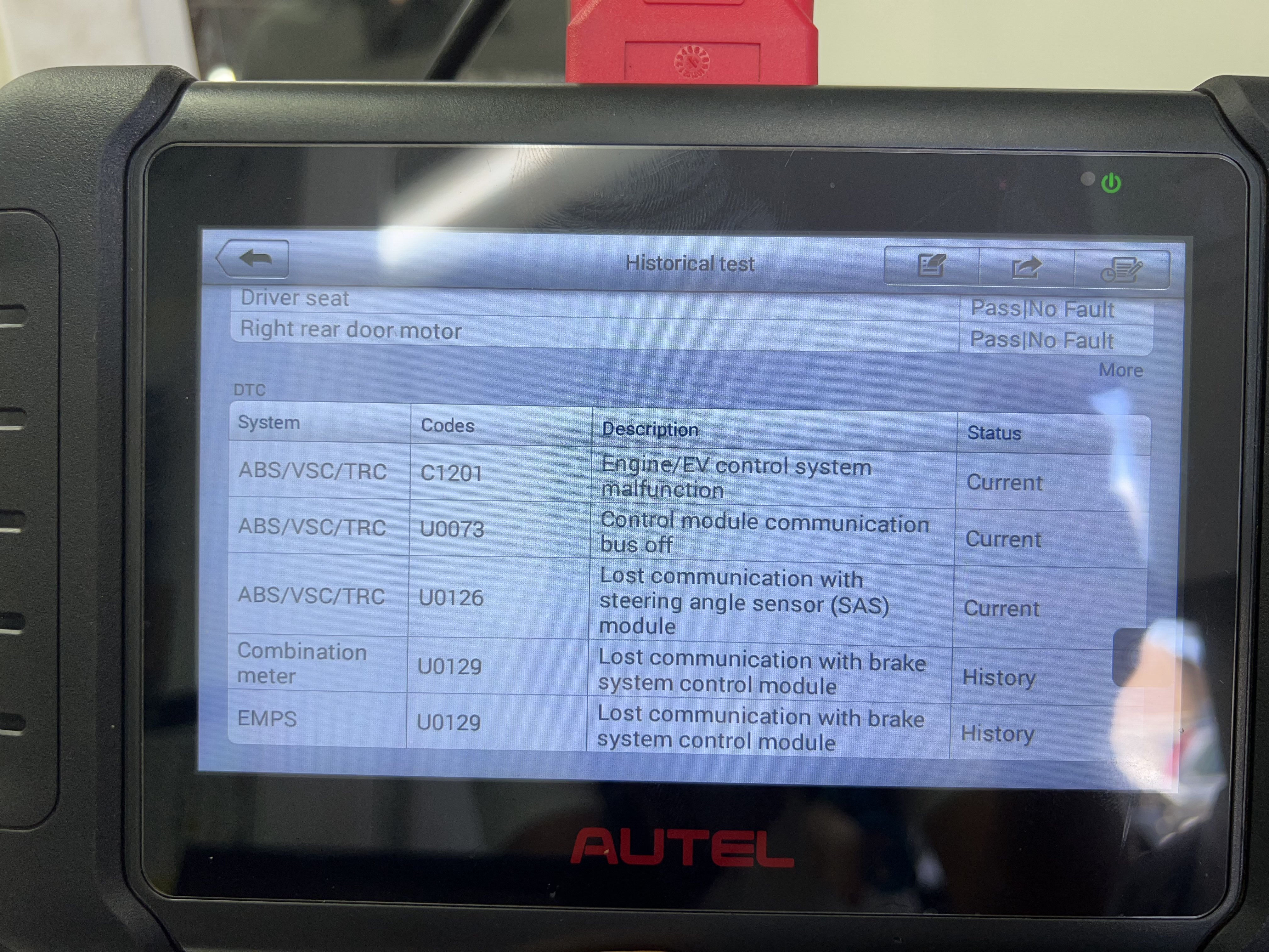

Error codes on the 'U' range are usually canbus related communication issues, and not actual sensor data - so any electronics fitted after car was bought may be shorting something or introducing noise on to one of the signal paths

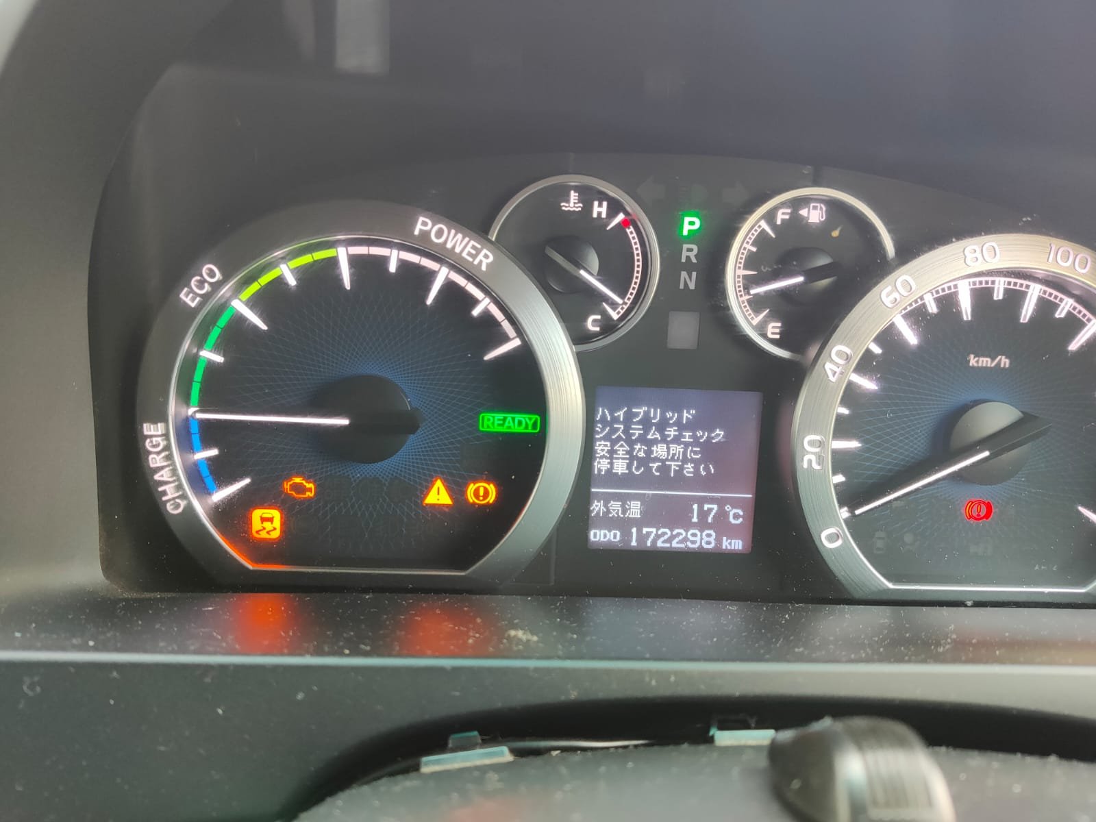

I installed a new battery recently, genuine Panasonic one....I'm getting similar alerts on dashboard, all pop up at same time. I can get rid of them by disconnecting  battery for 2 mins. But they re-appear after a couple of days, and then electric motor doesn't kick in...only petrol engine works.
Any thoughts plz?

I still think it was related to some device fitted, either that or there is some part of the wheel speed sensors not sending the correct data to the ECU, a dodgy converter for the km/H to mph could do this, maybe some poor installation done with those cheap wire splice connectors rather than soldered joints.
All the errors point towards something like this.
Function
(Function Description)
Control Master System Related Fail-safe Operation
DTC
(Driver Detectable)
ABS control
(Controls driving force while ABS in operation)
Skid control ECU
  • ECM
  • Yaw rate and acceleration sensor
ABS control is inoperative
(ABS control gradually stops)
U0073
U0100
U0124
(Warning and indicator lights come on)
TRC control
(Engine power control by VSC/TRC)
Skid control ECU
  • ECM
  • Steering angle sensor
ABS/VSC control is inoperative
(ABS/VSC control gradually stops)
U0073
U0100
U0123
U0124
U0126
VSC control
(Controls driving force while VSC in operation)
Skid control ECU
  • ECM
U0073
U0100
U0123
U0124
U0126
Cooperative control
(VSC with EPS-VSC integrated control)
Skid control ECU
  • Power steering ECU
Vehicle speed sensitive control is inoperative
(Control is performed with assist force equivalent to that of driving at 70 km/h (43 mph))
U0073
(Warning light comes on)
Electric power steering control
(Speed of vehicle induction type torque control)
Power steering ECU
  • ECM
  • Skid control ECU
Depression of EPS assist
(Deterioration of steering assist)
U0100
U0129
Headlight swivel/Leveling control
(Headlight control)
AFS ECU
  • ECM
  • Skid control ECU
  • Main body ECU
Swivel control stops
(Leveling control remains on)
B2427
(Indicator light blinks)
Air conditioning control
(Air conditioning control is cabin)
Air conditioning amplifier
  • ECM
  • Combination meter
  • Main body ECU
Air conditioning function and PTC heater function stop
(99)
U0100
U0131
U0142
U0155
(Air conditioning is inoperative)
Clearance sonar control
(Inform that an obstacle is detected)
Clearance warning ECU
  • ECM
  • Combination Meter
  • Main Body ECU
Clearance sonar control does not operate
U0101
U0142
U0155
(Clearance sonar is inoperative)
Entry function/Power door lock control Certification ECU (Smart key ECU assembly) Main Body ECU Unlock permitted
U0327
U1002
(Wireless door lock cannot operate)
