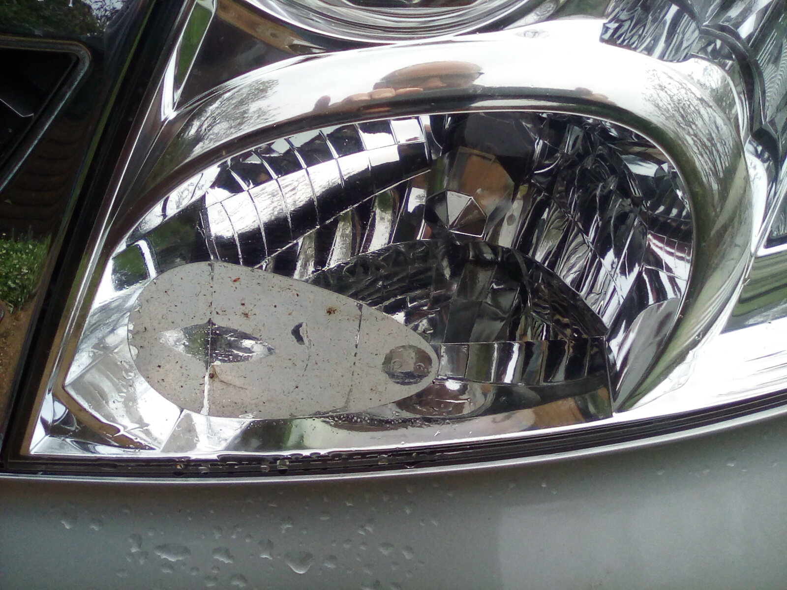

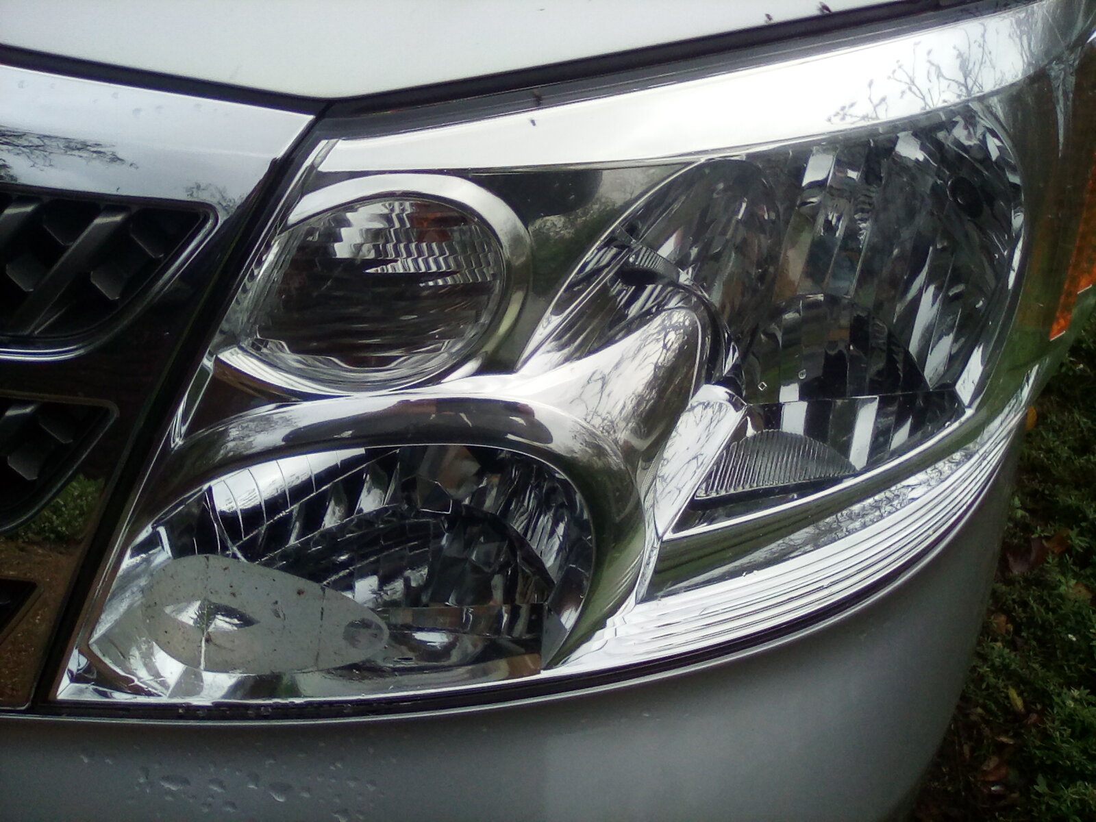

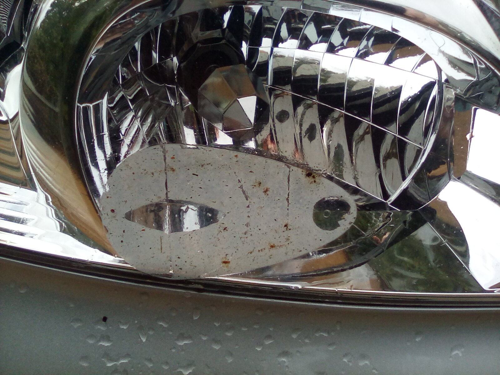

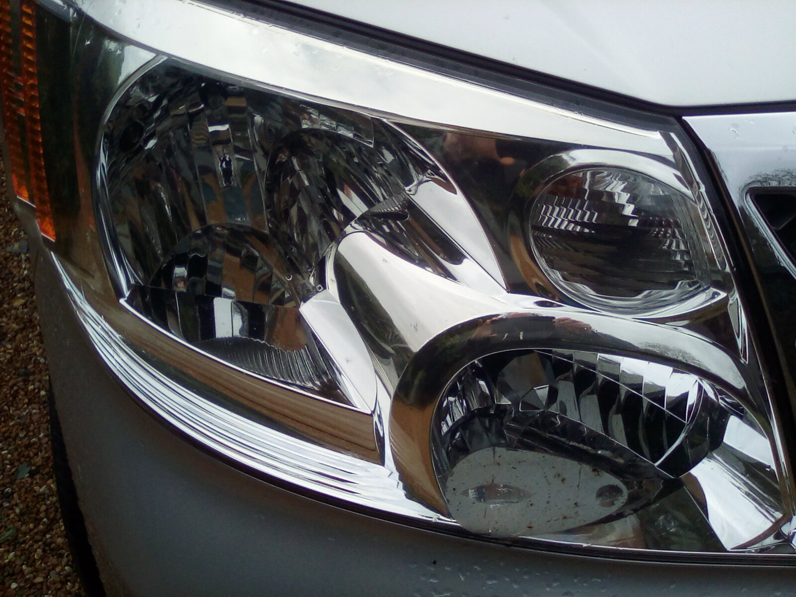

Hi all, and specifically Alfie, here is an idea of the positioning of headlight beam deflectors for European driving, I had these fitted at my local garage and as you can see I have since removed them, but fortunately haven't cleaned off the residue, hopefully this may help with members fitting for themselves.

I think I mentioned in another thread, that you align them with the mark on the headlamp lens (in your photos, you can see a small round circle on the headlamp glass.
That's the beam centre, so glad that aligns with the garage beam adjuster equipment!
Might have been on a 20 series post, the 20 series has small dimple marks on the inner surface of the lens.
Is that the small circle inside the larger circle Chris?.
