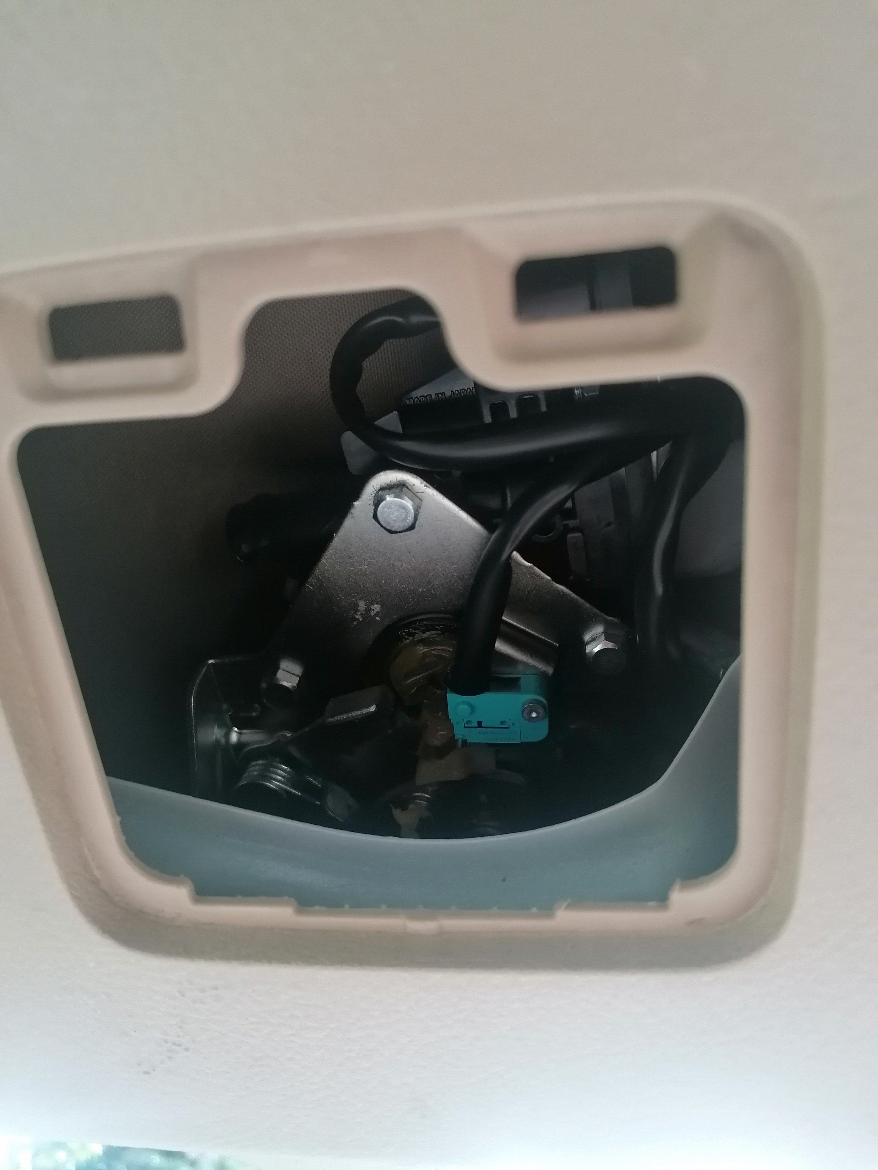

I suppose you cannot access the lock panel cover, if bed in way?
Lock panel cover?
3 hours ago, Chris.ac said:
on the rear panel, there is a panel that is removed to access the manual override with a screwdriver

no, gen 1 is a single panel, and because it's held by two screws on lower rim is not possible to remove without damage, whilst door closed.
20 series has 4 removable panels to access the bulbs and lock
