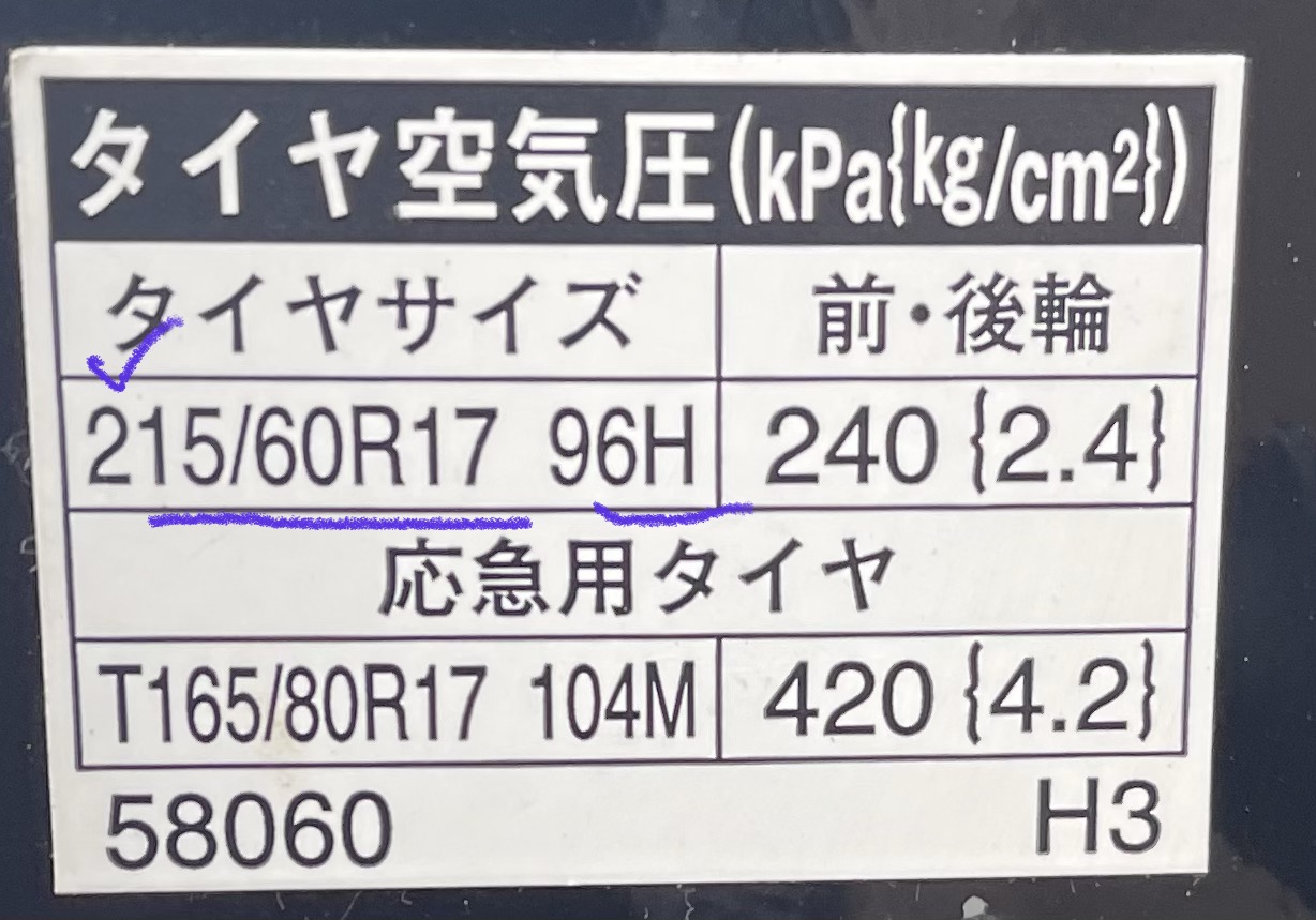

Factory suggested size is 17 inch as pic below. Will 16 inch alloy be safe?

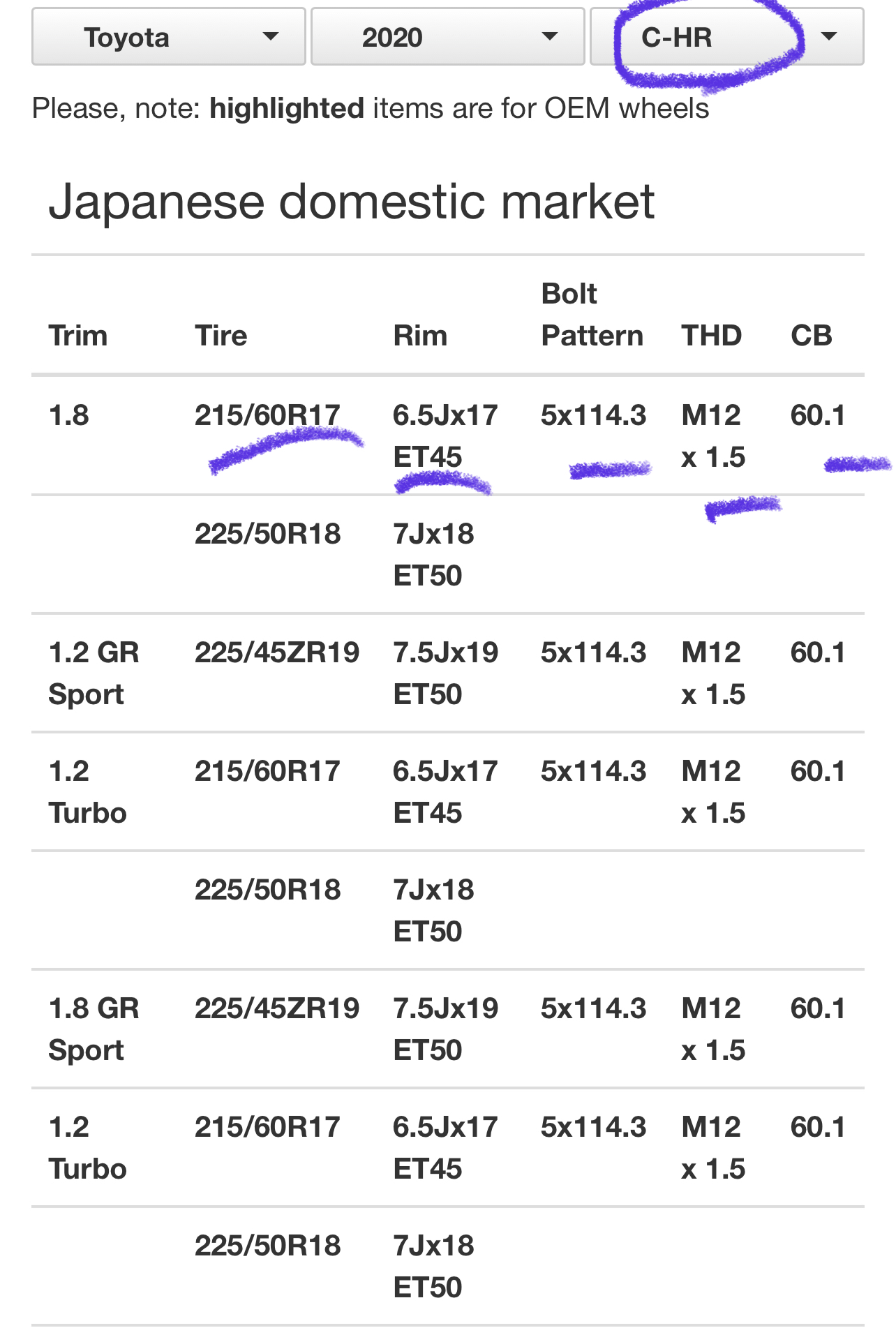

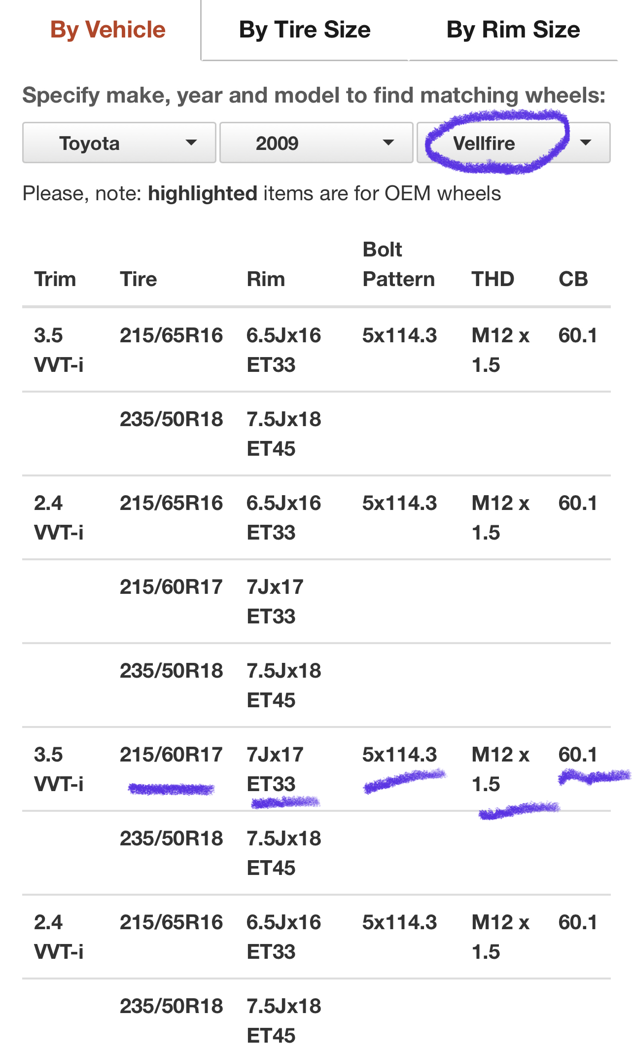

Thankyou Arthurj that's what I thought that it might work. Looking at https://papasmith.co.uk/alloy-wheel-fitment-guide/ looks like even other Estima Rav 4 C-HR wheels might fit too? Look at the pictures. Everything is same except the rim numbers. It might be stupid to try if they are interchangeable but I'll to find all facts and then make decision. I want original 16 or 17 inch Alphard or Vellfire alloy but they're rare like unicorn
13 hours ago, Rojie said:
The papa smith guide (above) is the type of guide I have previously recommended.
Please don't overlook the Wheel Offset column
Looks like my screenshot is from same site. It is pretty clear and convinced me to stick to oem.

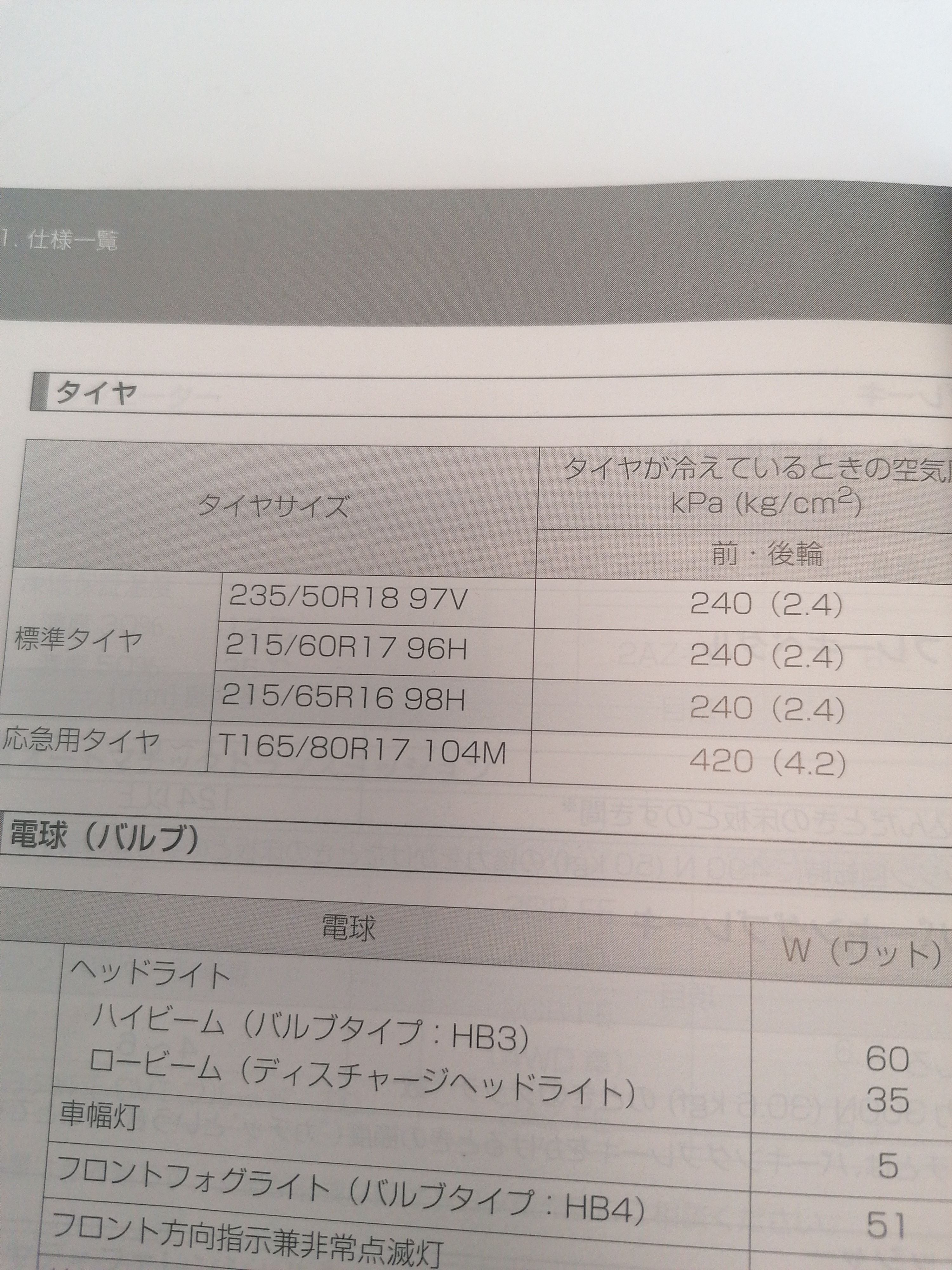

In a bit slow recently, but the official owners manual lists 16, 17 and 18 inch
Wow that's like original Japanese manual. I'd love to get that. May be someone wants to sell it?
