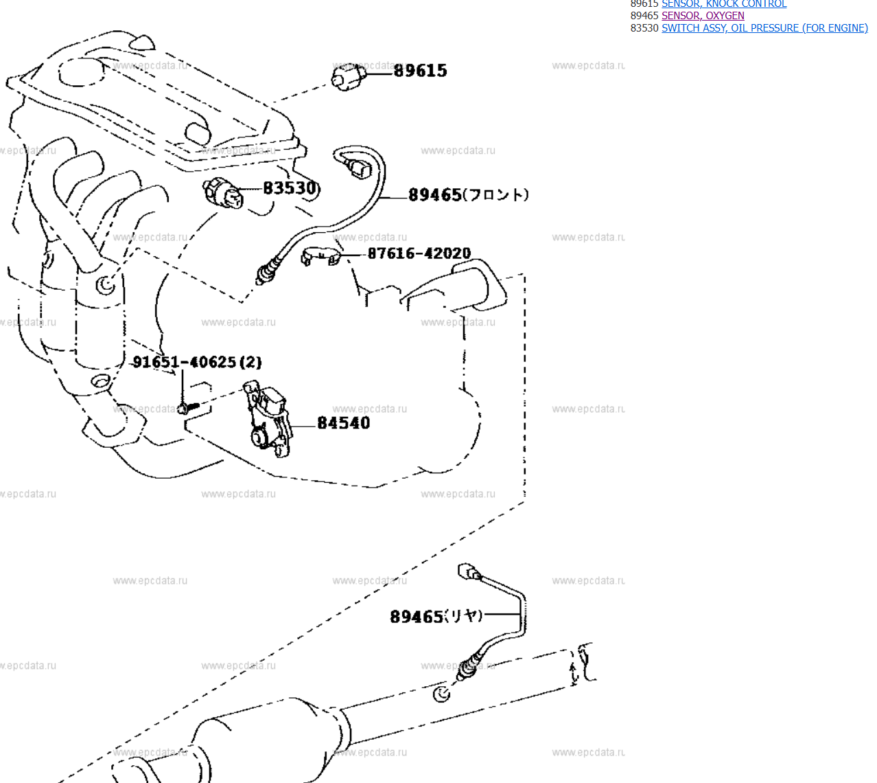

Front lamba sensor top one at manifold

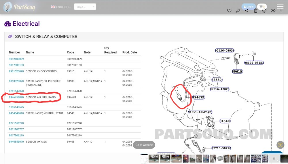

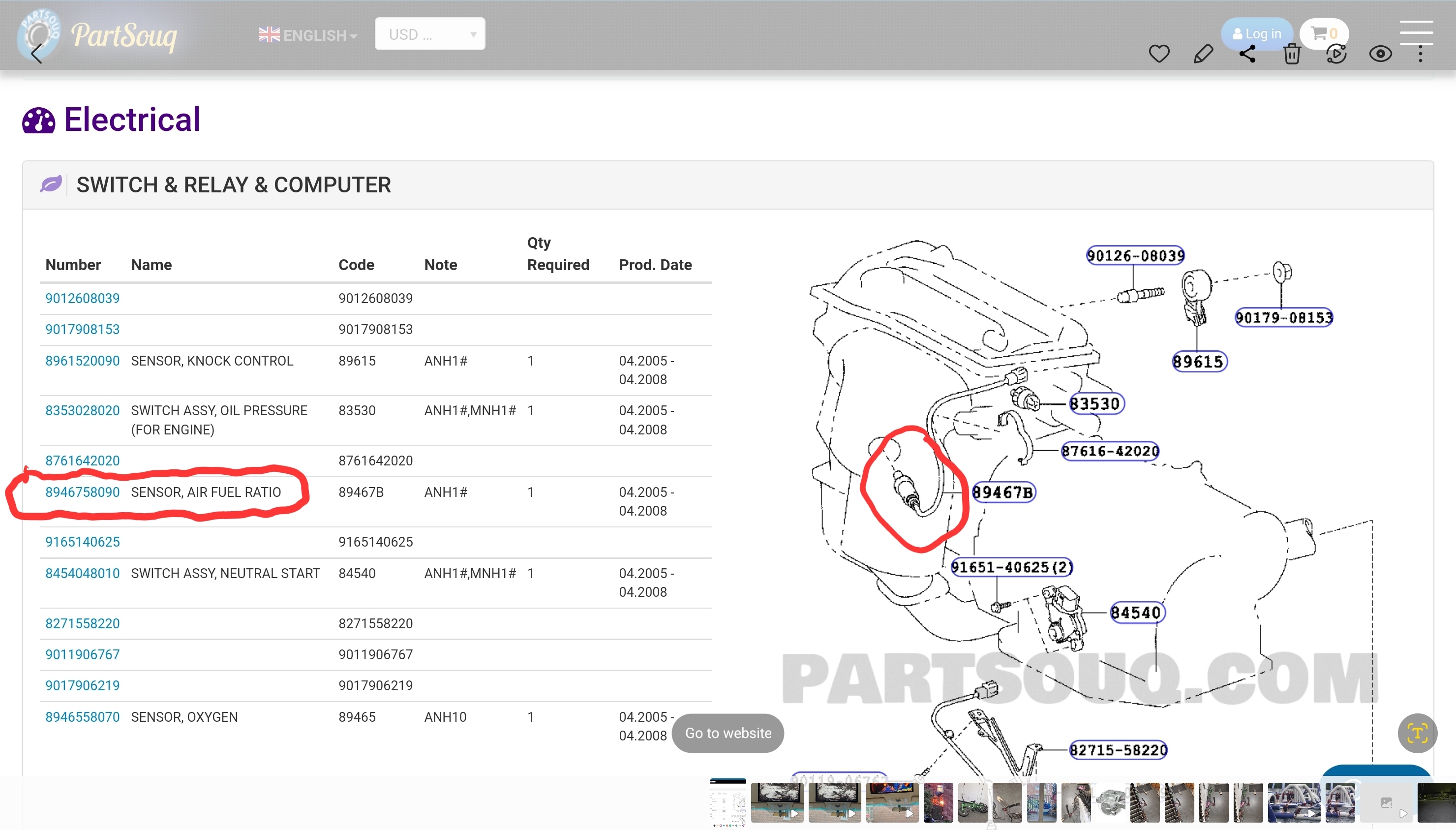

1 hour ago, Picasso said:
Hi oe part no. Is.   8946758090. Put into ebay about £55.00 picture attached showing location and circled in red

Hi Michael did did you replace the upper lambda sensor with a aftermarket or genuine one reason asking is the upper one is a fuel ratio sensor not a lambda sensor
