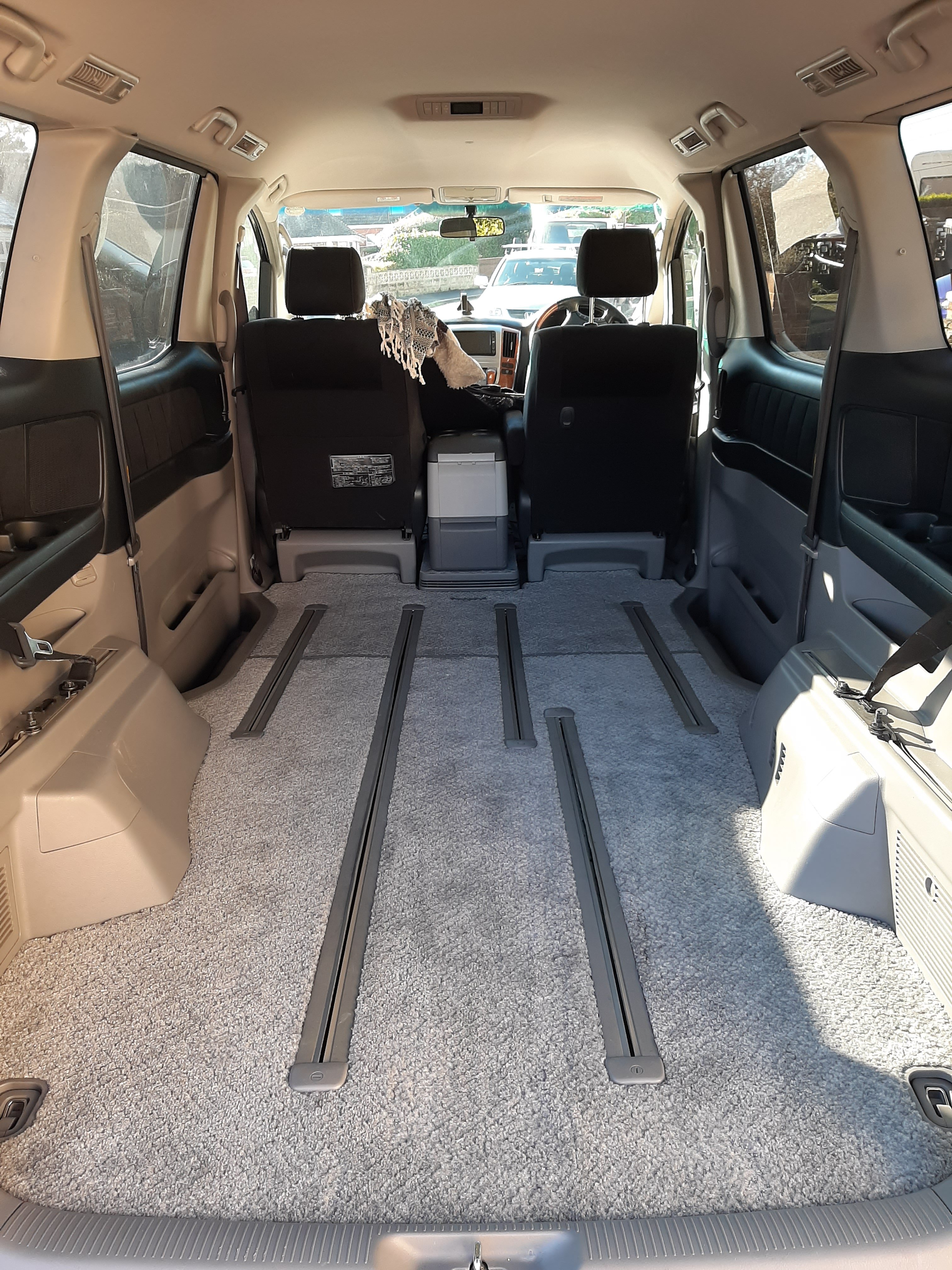

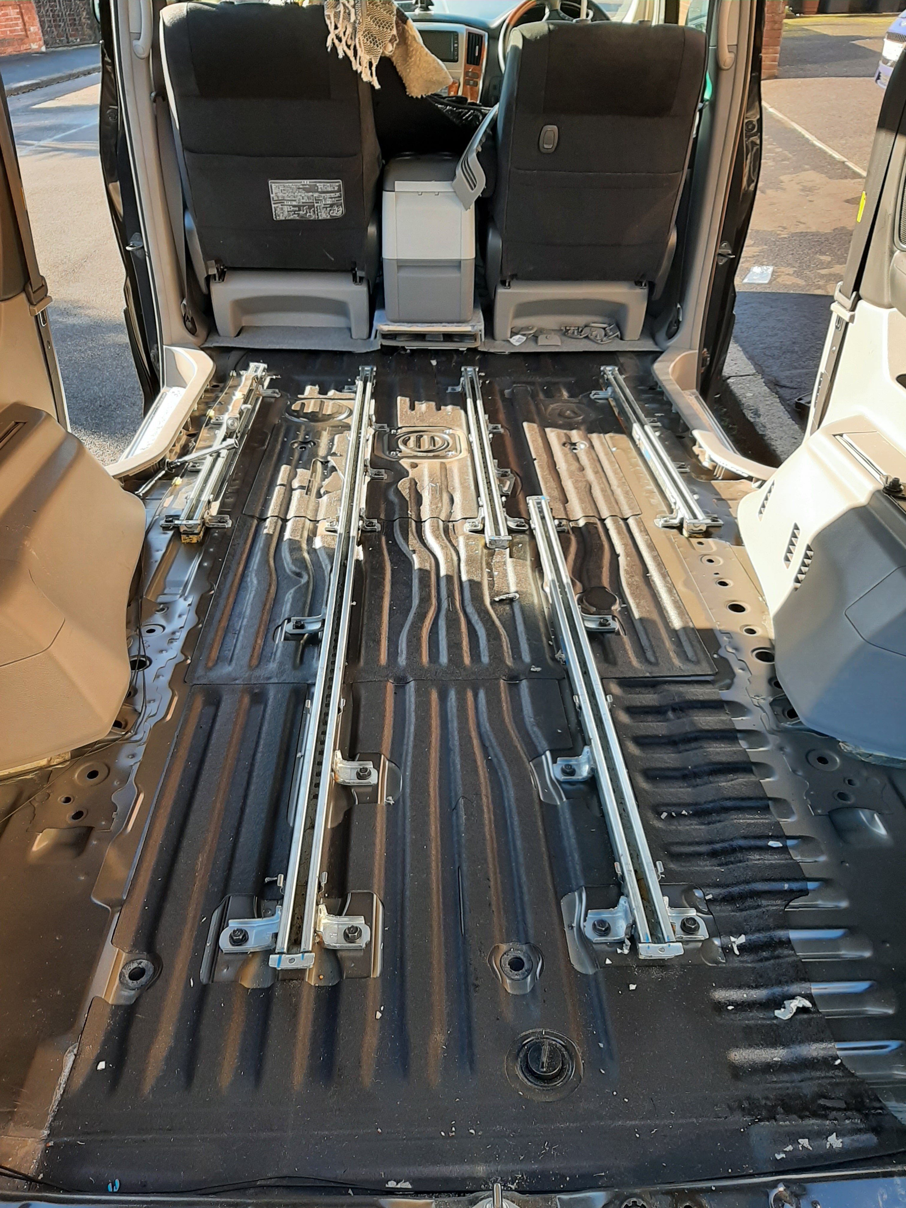

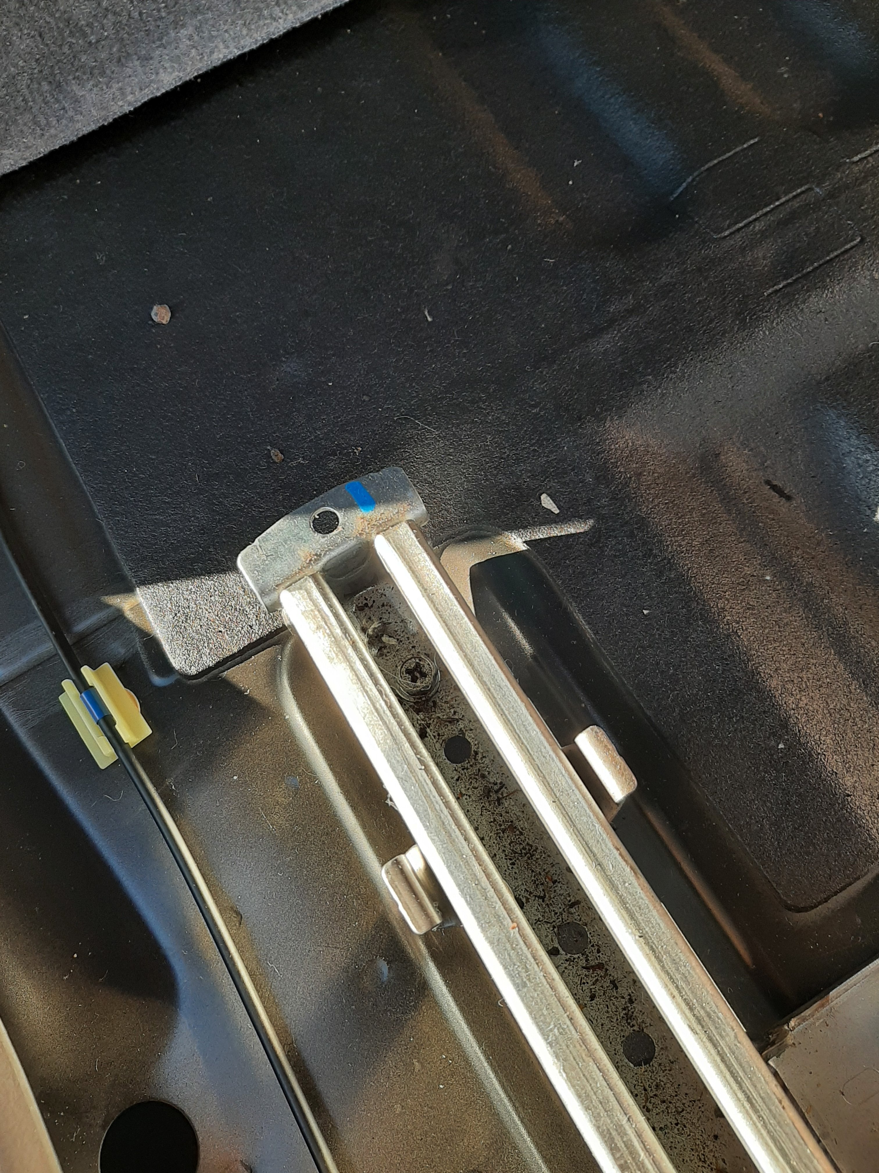

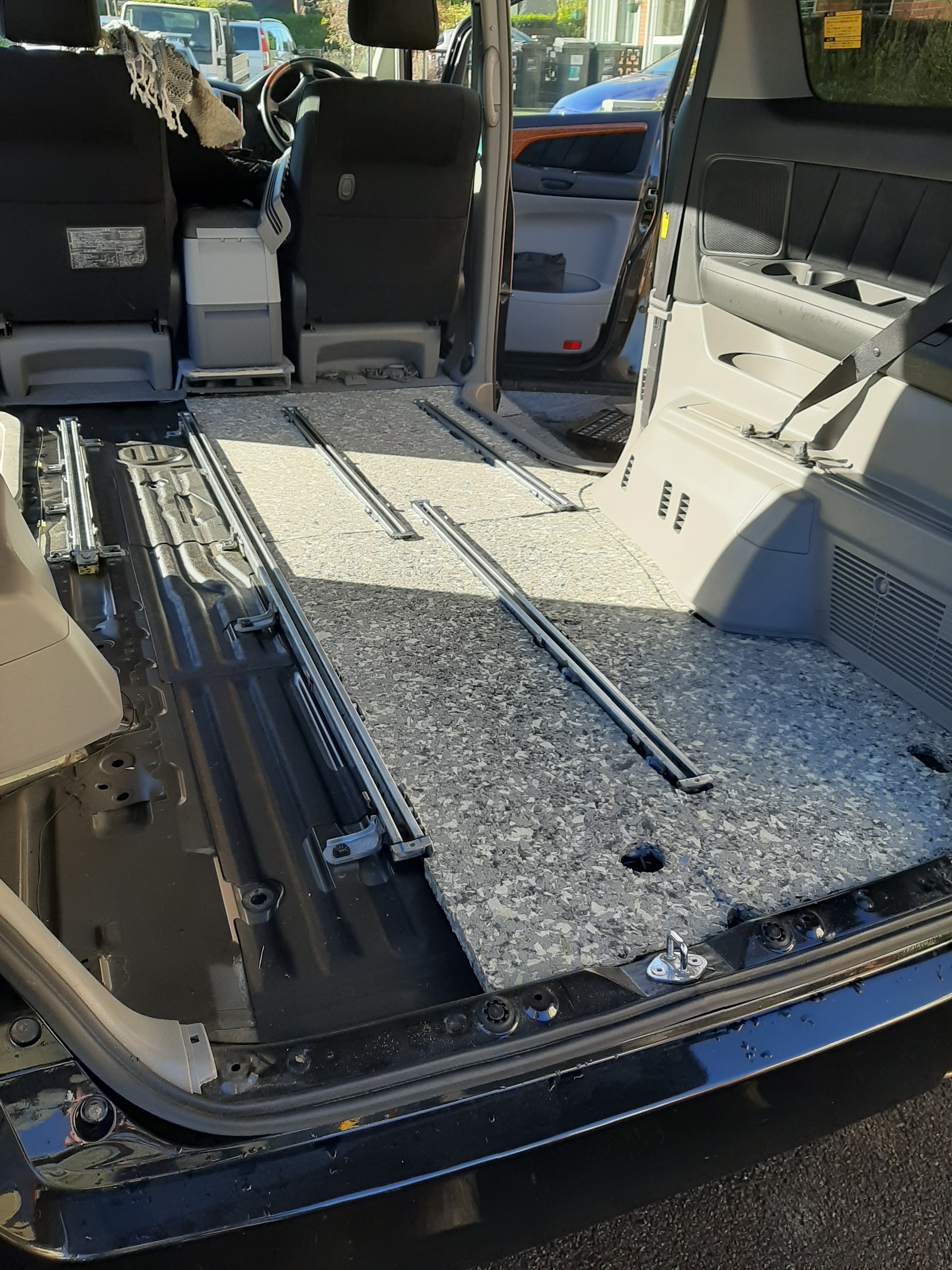

Hi, I removed the seat runners yesterday. Actually pretty easy. I found it best to just lift out the carpets and insulation, just held there by gravity, and then just get on with it :).  Tracks easily unbolt, end cap needs removing then runner slides out. Then reinstall. Took me about 3 hours on my own. Not as scary as I thought it might he.

Hello Dean,
Good job. Thanks for the photos.
They clearly show the difference between an 8 seater (which your is) and a seven seater.
In each case the rearmost seats seat three.
On the seven seater there are only two long centre rails; i.e. there is no  'split' centre rail (rhs middle) as in your photos.
To change the seating arrangement those two rails need to be removed and replaced with one continuous one.
I believe the rails are 'handed', so someone wishing to change their seating will need the correct rail(s).
