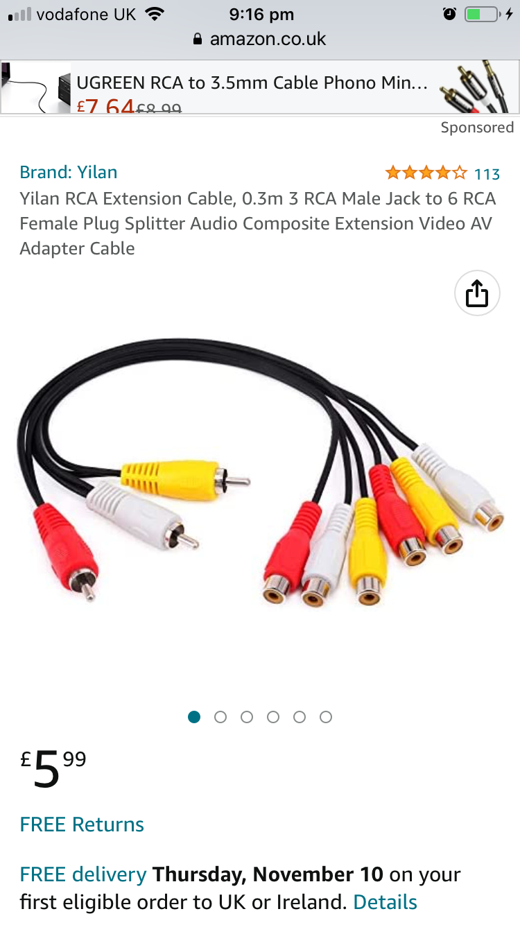

To get the uk head unit to work it needs 2 video outputs most radios have 1 video out put which the installer will plug in the reverse camera so ideally when buying a upgrade head unit buy one that hase 2 video out puts .
Ok will have to check the back of the head unit that been fitted to see. If not only one can you buy a connector to get two coming out?Ā
Not to sure I know when I had my alphard head unit changed and had it fitted in a garage who specialises in fitting car audio they said that I would loose rear monitor due to one video output I guess if there was a adapter they would had done it .
Just found this on amazon so I will look at back of my head unit and see how many video outputs if one I might buy cable and just try it see if works šŸ‘šŸ¼
Hi
I'm having the exact same issue with my monitor. Did the cable work and fix the issue?.
Many thanksĀ
