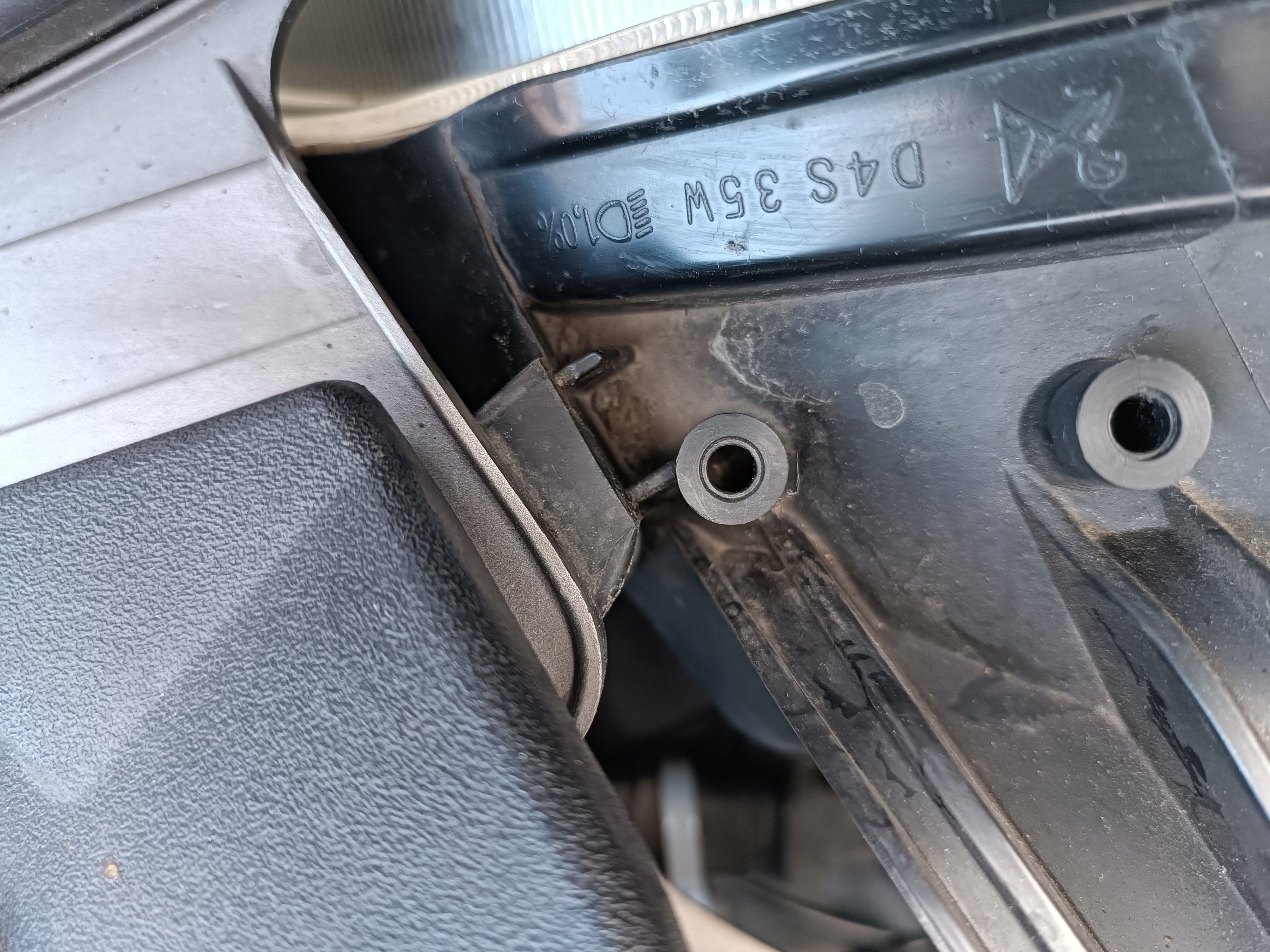

Check if you have a projector housing, as it would be D2S.
D2R has a small shield on the bulb to prevent light being emitted forward, as it uses a reflector housing.
If not sure, attach photo of headlamp and we will tell you.
On 20 series, it's easy as the bulb is printed on top
Example
