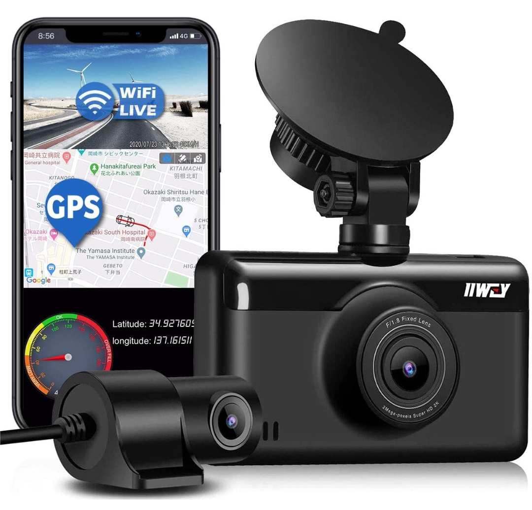

I would like to fit a rear dashcam onto my 2010 Vellfire. One way I could do this is to feed a wire from the middle console unit usb, under the floor mats and then up along the side and along the ceiling.
The dashcam isn't an extension of the main dashcam, like this
Screenshot_20221228_113301_com.amazon.mShop.android.shopping_edit_5130172139841.thumb.jpg.7fb2b293f25d0bb0751a2efd96eb5275.jpgbut is a seperate dashcam unit.
I can only think of this method, apart from using the power from inside the boot (which I don't know how to do).
What other methods could I use to install it?
Normally the rear dashcam takes power from the front camera which also does all the recording. By your description, you have two separate dashcams. If that is the case then I would probably just take a power and earth from something in the tailgate. You will have to make sure that the power comes from something that only comes on with the ignition, otherwise it will just drain you battery. Just make sure you run an inline fuse.
