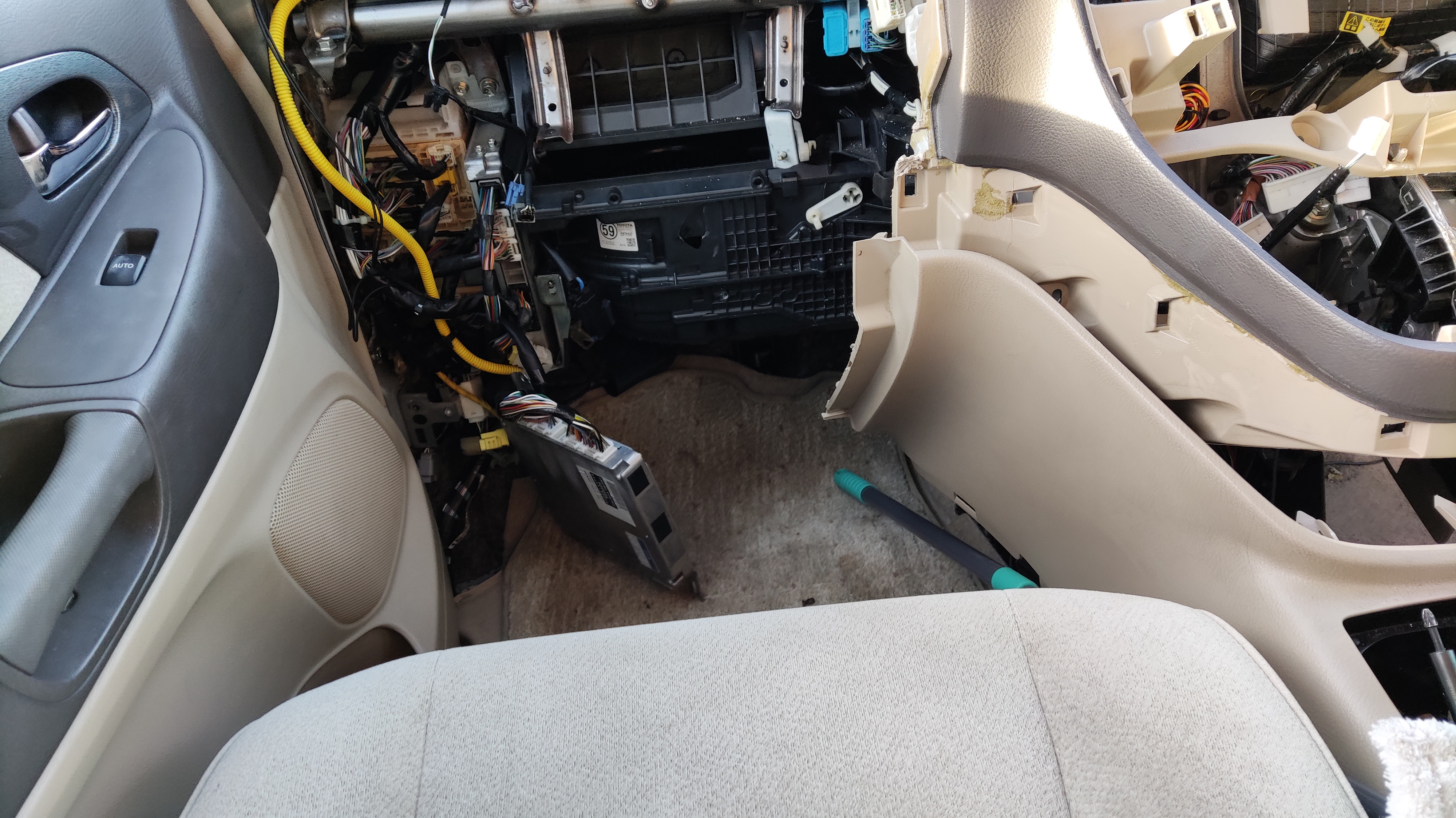

Hi can anyone help me to find the fuse for the audio, I have checked the two boxes under the bonnet and the drivers side. I have removed the lower glove box on the passenger side but can't find a fuse box.
Hi, they should be fuses 6-acc & 9-ign in the engine compartment, the hybrid also has a fuse box on the tunnel beside the driver's seat. Hope this helps.

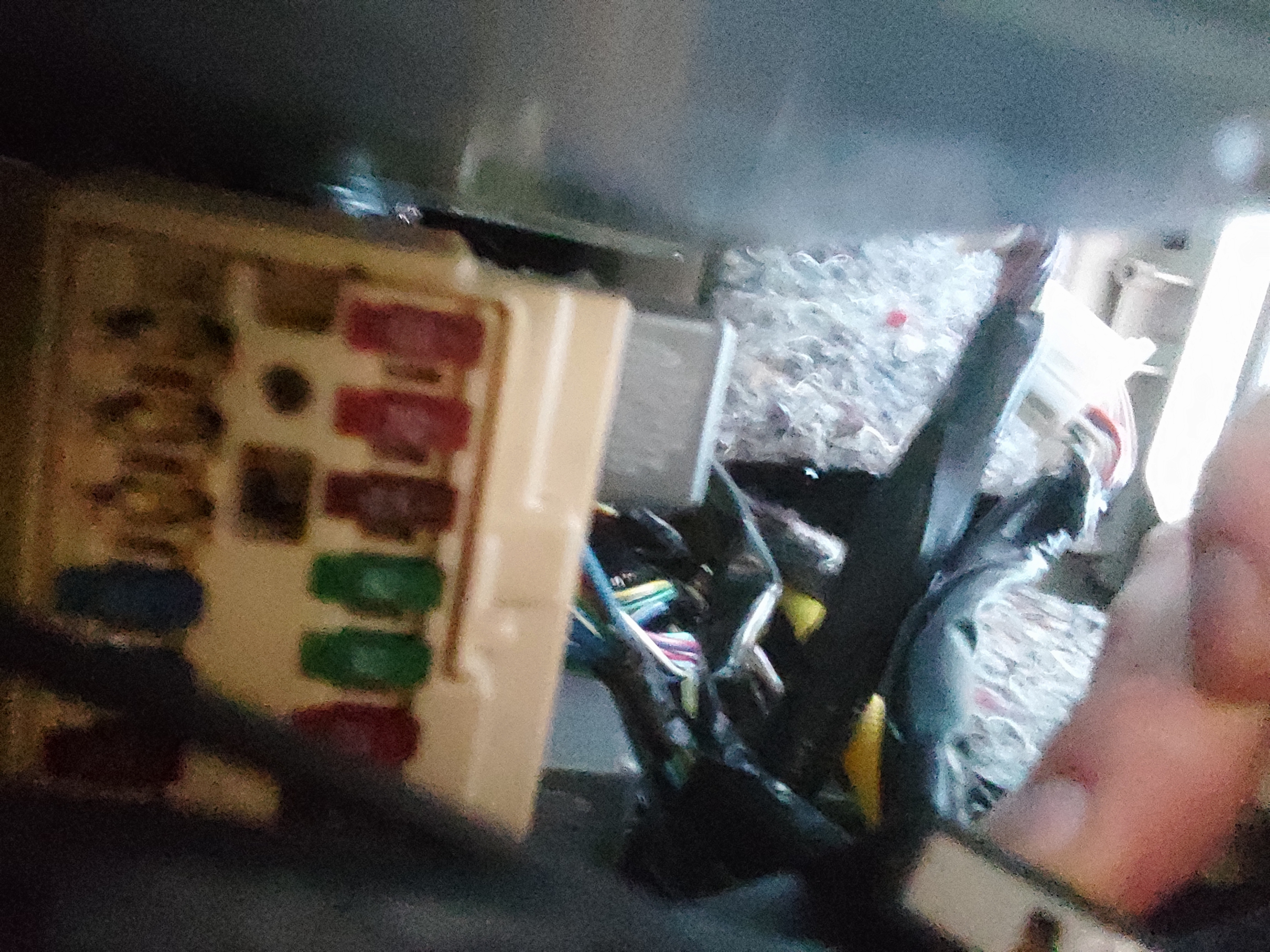

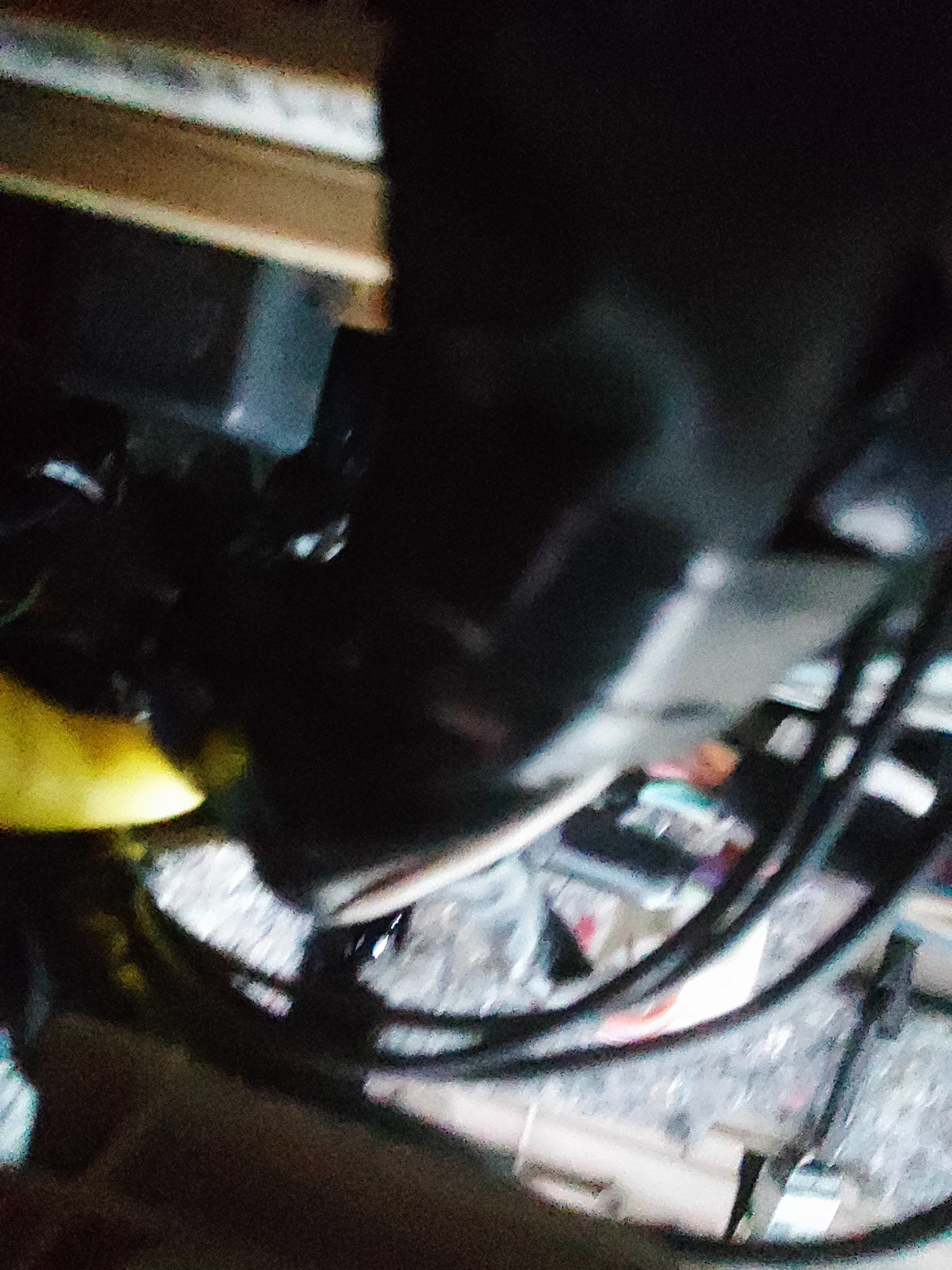

Hi Gary, I found it extremely difficult to find and get to!
Looking straight at the hybrid controller on the passanger side behind glove box.
It's on the left tucked behind, you can just see the larger fuse blocks on its front face but the actual small fuses go underneath. I'll see if I can link pictures!
The photo where you can see the blade fuses I had to stick my phone in to take. Very fiddly.
