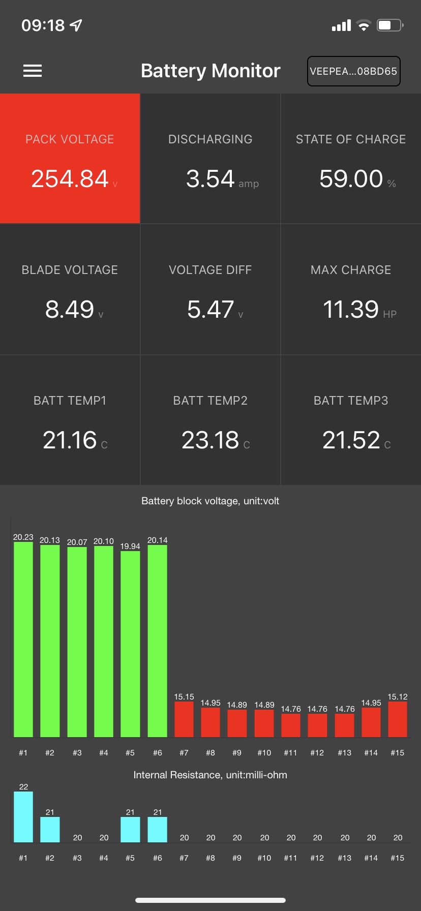

As I mentioned in the other thread, I contacted the author of the app because it wasn’t showing the correct readings for the battery cells. I don’t think the app supports JDM cards. When I use the app it looks like this. The number of cells are wrong and so are the voltages, though they do seem to change as I drive.
Thanks ArthurJ - good feedback 🙂
