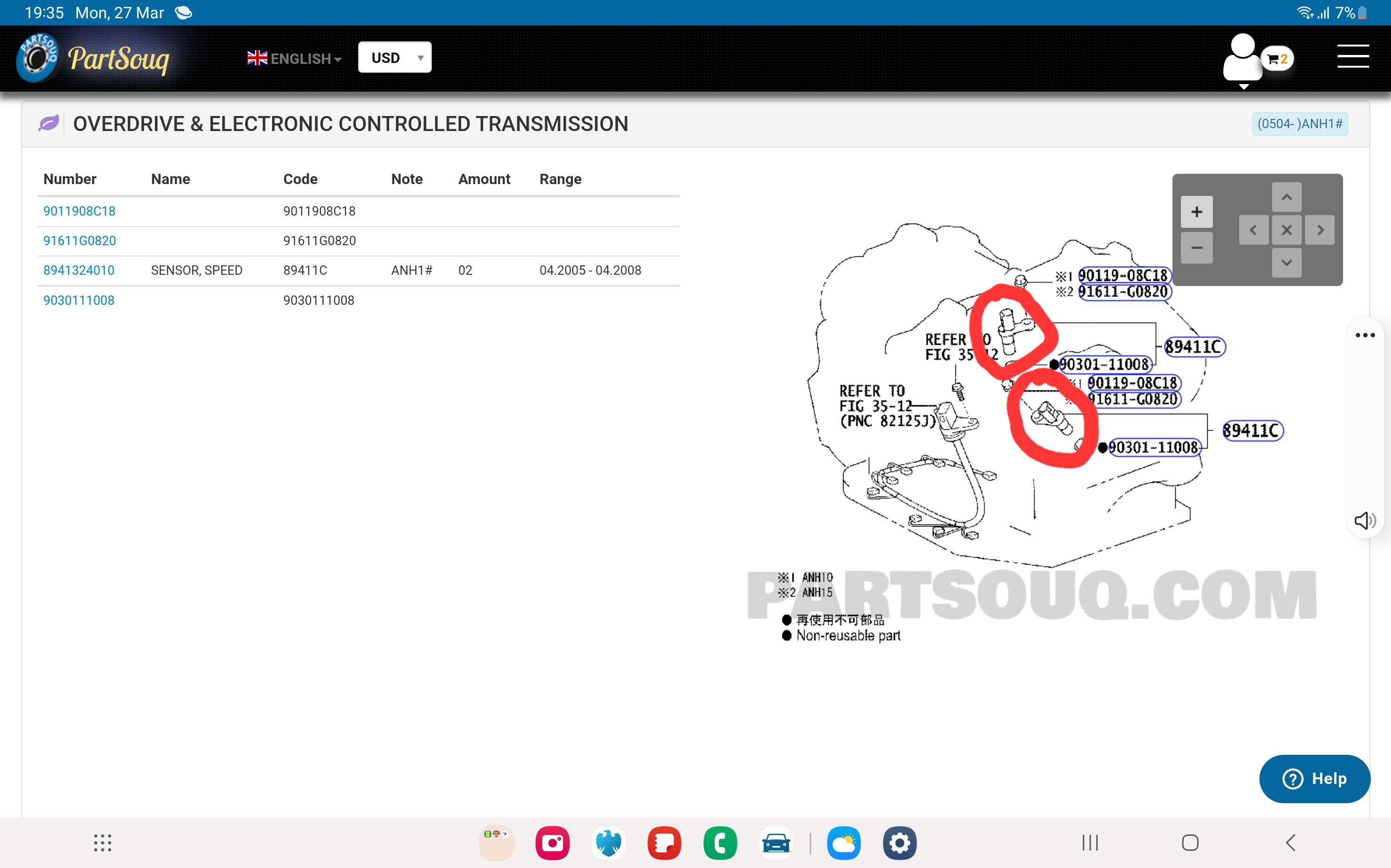

It's speed sensor on the transmission there is 2 both the same part no. If you pm me your vin no. I will confirm for you and let you know best place to buy
ANH10 -0174826
Can you tell  me the location of the parts
Hello that's wrong part no. Your part no. Is 8941324010 they located on the transmission 2 same part no. My advice is replace both at same time

Could you tell  me where abouts the sensors are or a picture
Hi Picasso ,I still have the problem  after fitting a new sensor its still showing the same fault  no signal. on the scan tool
I put a tester on the connections with ignition on and there is no voltage ? any ideas wold be helpful
