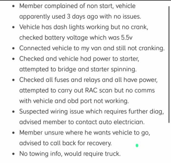

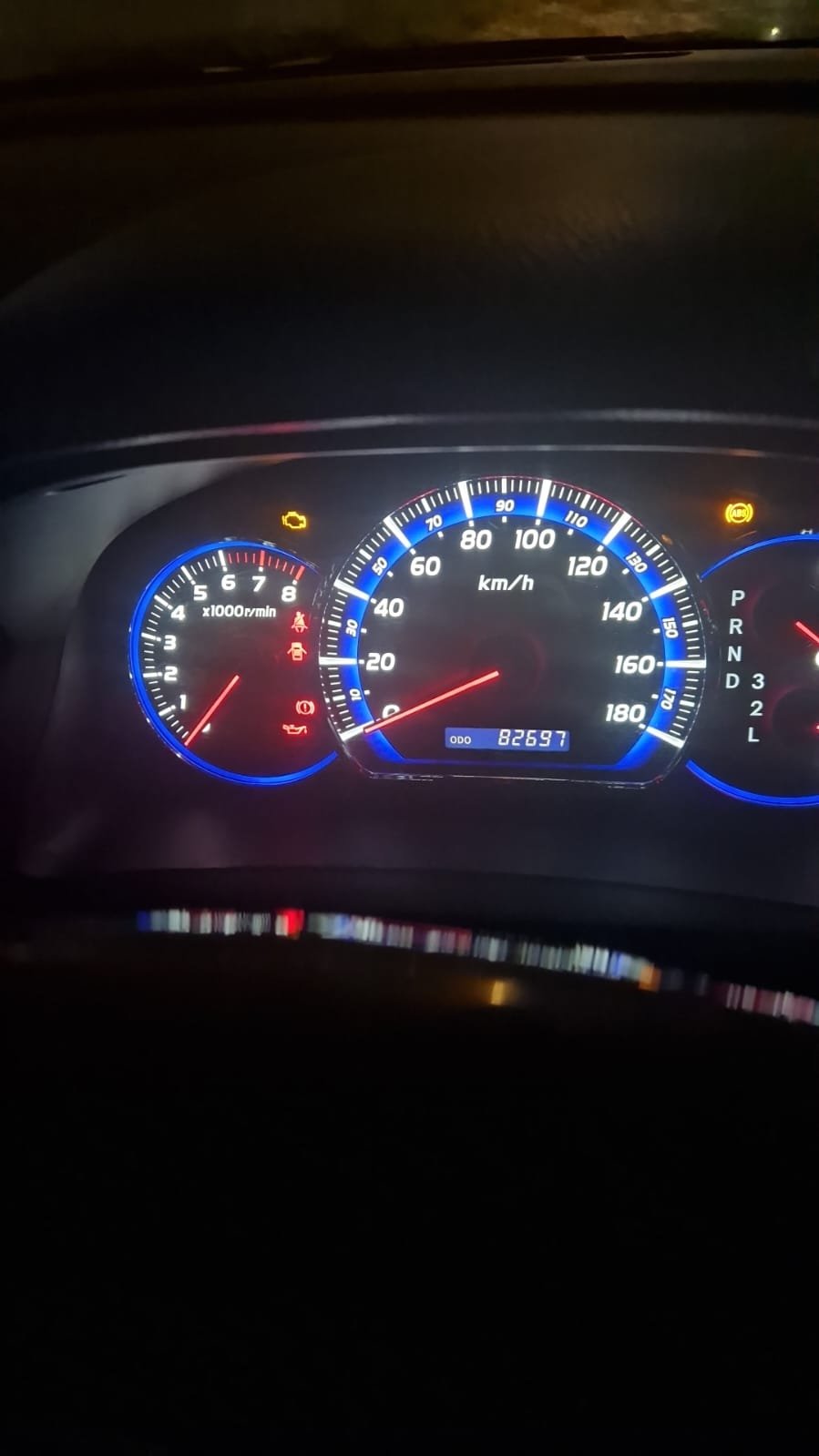

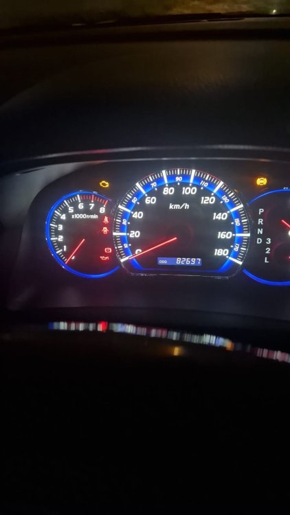

Hi I have toyota Alphard 2008 . Engine not starting no crank . All dash lights on. Called Rac they are unable to start it. I add 2 images. Can anyone help me what the issue.  Thanks
first things first get the battery checked as it may be a dead battery a alphard needs a good battery as there is a lot of electrics so get that done first and let us know how you get on if rac tried to charge from there van and battery no good it wont crank
Kwik Fit will test your battery, under load (which is very important) for free with a printout.
Your alternator will also be tested.
As Lee says, your battery needs to be in tip top condition at this time of year.
Thanks for the rey. Hi its been  not driven for 3 months . I will change the battery.  It's alphard 2008 2.4 petrol
Hi I put new battery in. Change the relay and the fuse. But still not starting up. It's now cranking but not starting up  . Any suggestions.
I understand your engine will not start, but each time you try and start your (new) battery will lose it's charge very quickly (assuming it was fully charged when it was fitted) as the alternator will not maintain the charge.
You need to ensure you keep charging, trickle is best, until you manage to get the engine running again.
Hi  I got checked from mechanic.  He said need new fuel pump.
