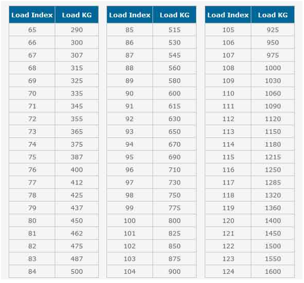

You're probably already aware that tyres are weight (and speed) rated, so assuming laden weight is evenly distributed between front and rear, you would need a minimum load rating of 93 front and 84 rear (remember to multiply the tyre load-rating by 2 to get the total for each axle – front and rear). In reality you have to allow for unevenly distributed load when laden and also allow a further margin so that tyres are not working at their maximum rated load.  I think our Alphard before campervan conversion had 95 load-rated Yokohama tyres (which allows a front axle load of up to 1380kg).
Because of our additional campervan load we went with Falken front (101 load rating) & Nokian van tyres rear (109/107 rating), which works well as a combination; although next time round I might consider the Nokians both front and rear. We messed about on a weighbridge several times, putting the whole vehicle on first, then the rear only (and subtracting the difference), to work out the true unladen and laden weights for each axle. Divide the axle weight by 2 to get a load for each tyre...
Here are the tables for load and speed:
