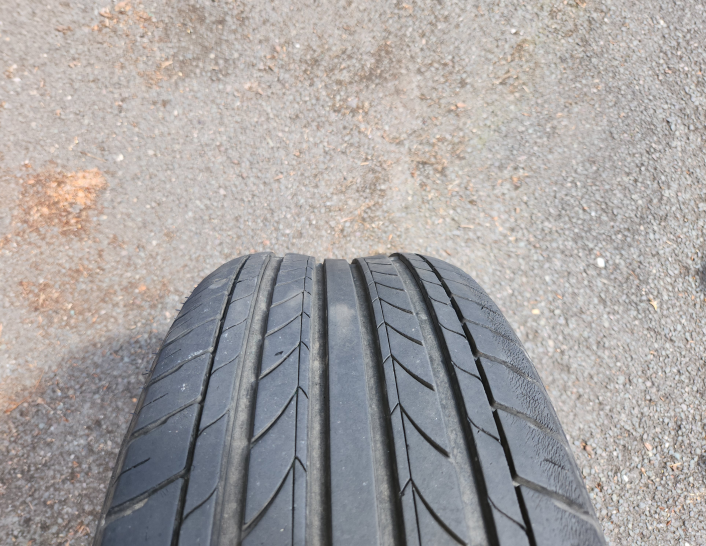

Just a word of warning. My camper steering wheel started wobbling. The problem was a deformation on one side of one of the front tyres in an otherwise correctly inflated tyre.
I think (but not certain) it was caused by my parking up for a few nights on one wheel ramp which is about 2/3 the width of the tyre. I suppose I should have got ramps which are at least the width of my tyre but these would be too bulky to transport.
Instead I'm going to carry a couple of pieces of wood to sit on top of the ramp to spread the load across the whole width of the tyre.
