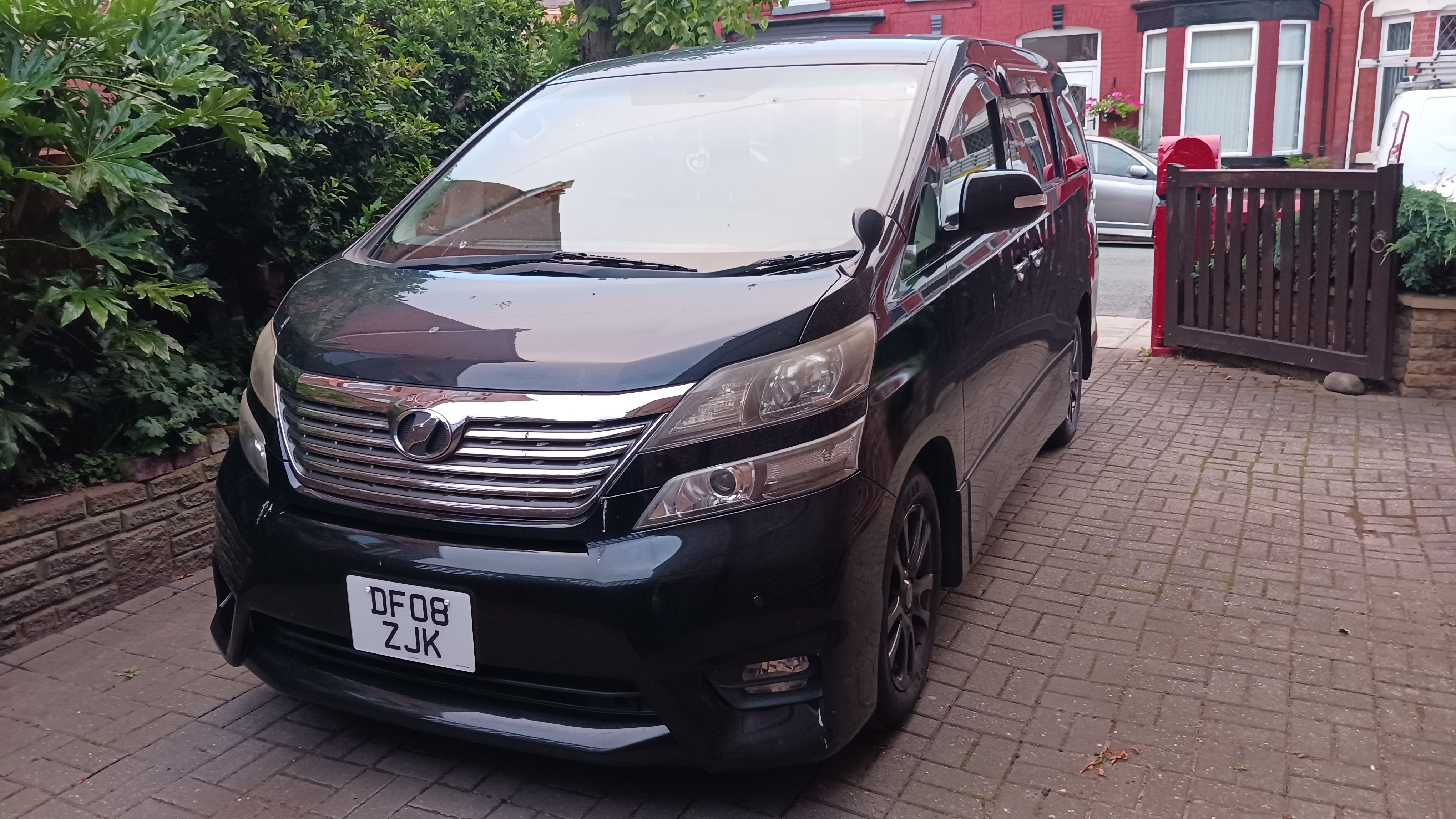

Hi. My 2008 (AH20) Vellfire 2.4 has a timing chain. I'm pretty certain all the 2.4 models have them?
