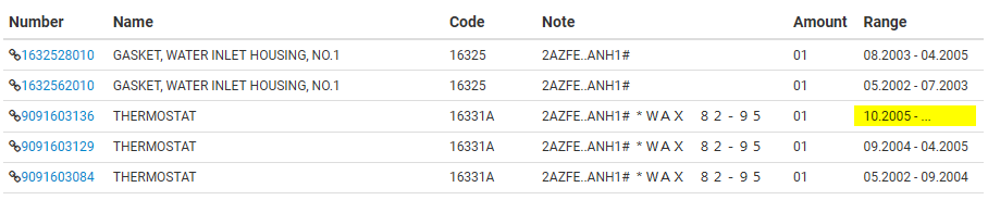

Can anyone advise what the part number is for Alphie 2007 2.4 2WD coolant thermostat? The internet is giving me two different options.

Looks like the thermostat had several changes for the Gen 1 which might explain the multiple part numbers:
Your 2007 therefore most likely uses 909160316. Not sure why there's no third gasket part listed. For the avoidance of doubt, put your VIN into Partsouq: https://partsouq.com/en/catalog/genuine/locate?c=Toyota
