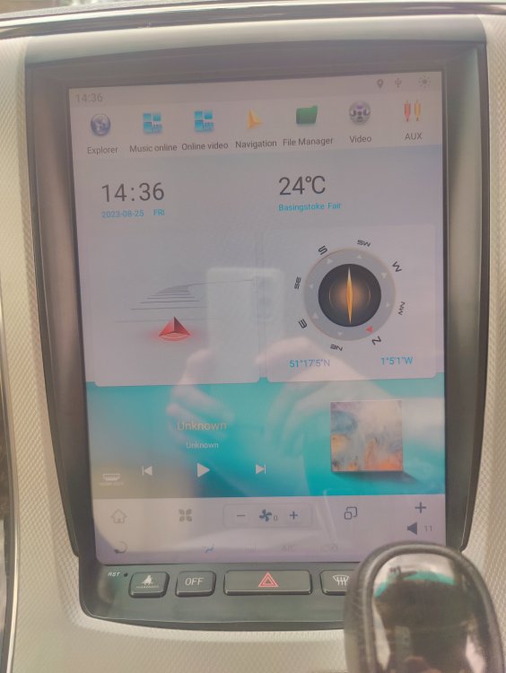

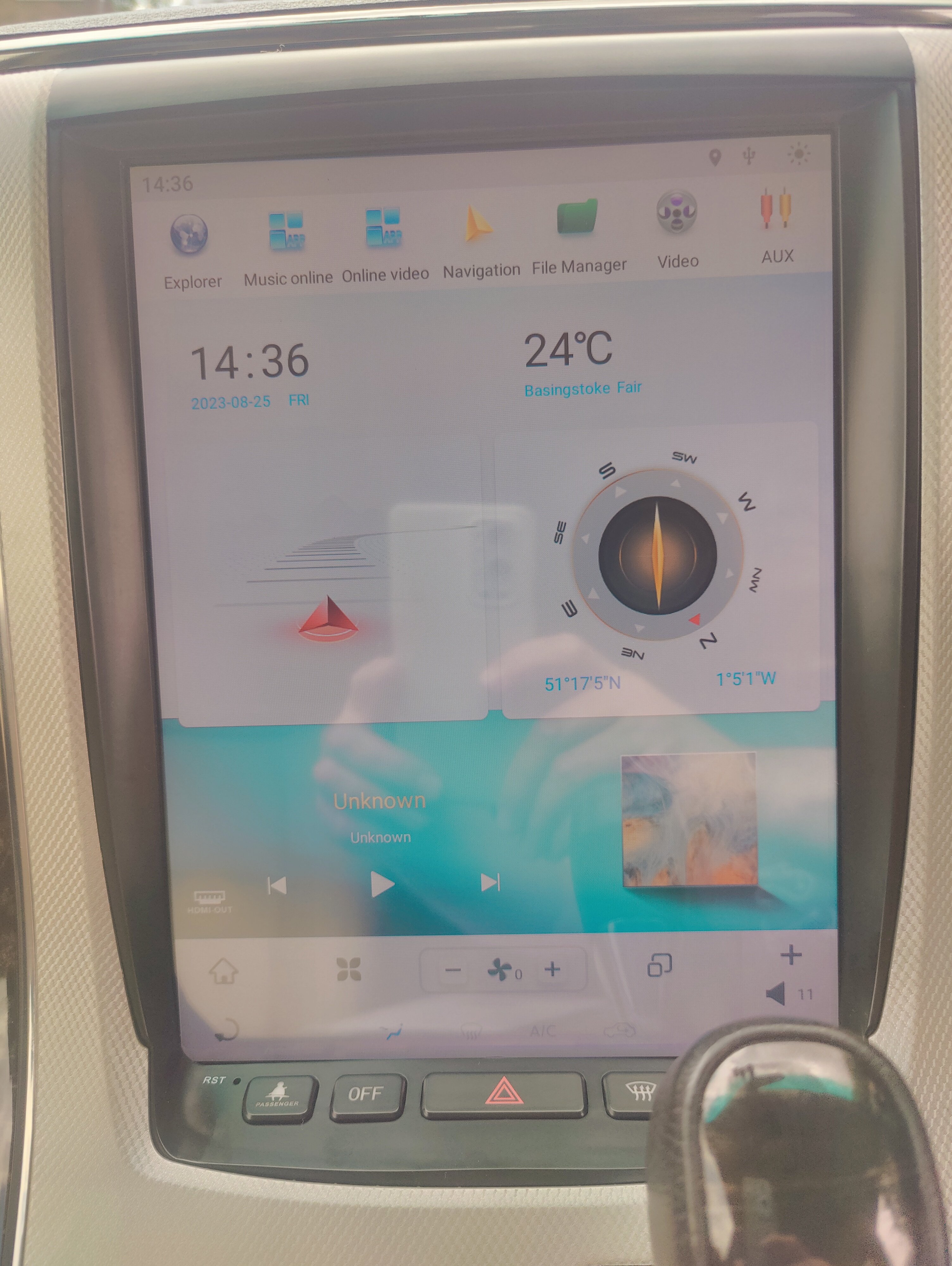

Hy all, has anyone any idea how to get the compass on the home page working? Everything else seems ok but this doesn't move which is a pain as it's there all the time.
Thanks for your reply. I attach my mobile hotspot to this after market headset and location is set to my home town. Satnav and other things that should require location work fine so 8m at a loss here
if it anything like other tablets/phones (which this is basically) the compass needs calibrating by moving and rotating the head unit in a figure of 8 - practically impossible of course.
I noticed that Google maps wasn't working correctly and found that a cable at the back was in the wrong hole. I put this in the right plug and both maps and the compass works nicely now. Thanks for everyone's help.
