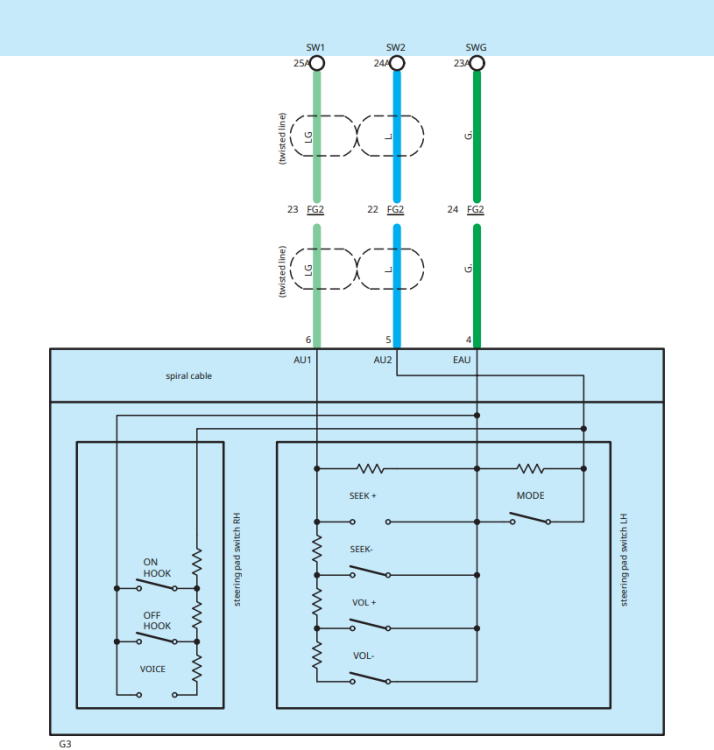

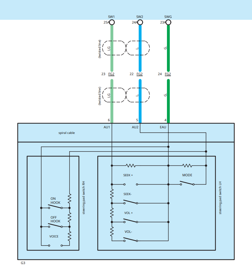

20 series steering controls are 3 wires Gnd, and SW1 and SW2, using resistive differences to determine which keys are pressed.
The microphone is situated near the dome lights, but this is unlikely to be connected up to the aftermarket unit - should be easy to do though, as it is just a condenser.
Usually aftermarket, they will mount the mic on the steering wheel shroud.
I will hazard that they did not connect the right side steering controls to the new headunit, so you only have the leftcontrols working.

Thanks Chris. I’ll admit I have no idea what I’m doing so I’ll probably have to leave it. I’ll have to see if I can get the unit out and fit an external microphone at least.
