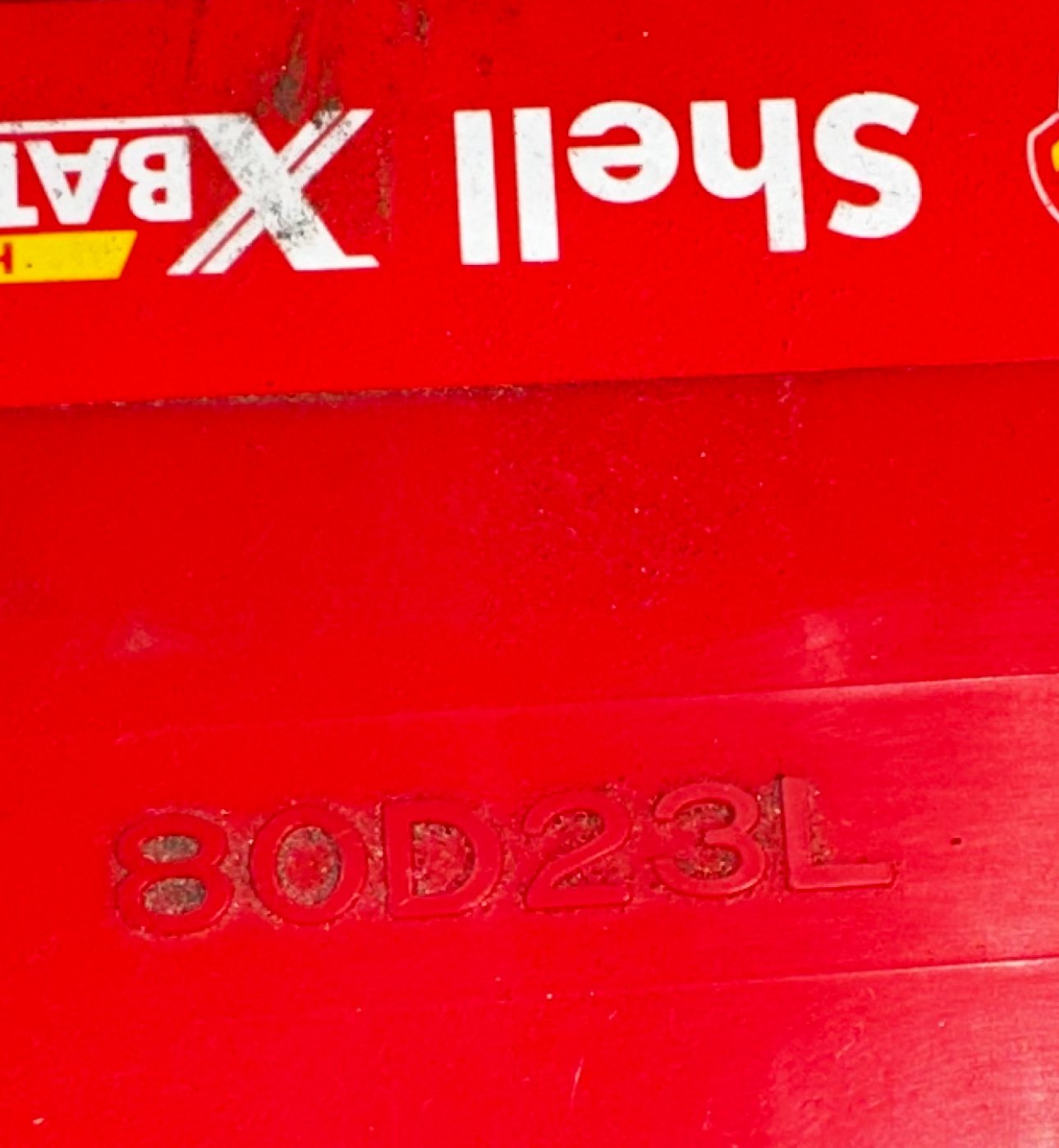

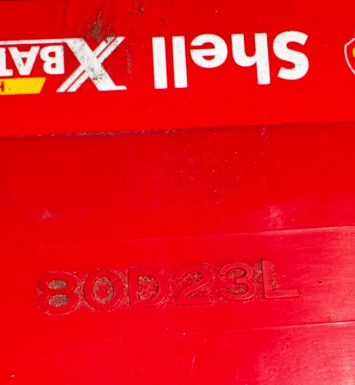

I noticed mine has battery with a number on it  80D23L and I was told this is the number used in Japan to find replacement batteries. I was also told mine is Diesel engine battery as it has D in it. Crazy..
Btw Mine is 3.5L Vellfire.
20-series hybrid original is a Panasonic S55D23L AGM. The Yuasa HJ-S55D23L is a perfect replacement. Not sure if the same battery is used for non-hybrids.
the D refers to width and height, not diesel.
80D23L = Performance score (based on capacity and cranking(80) Width/height (173mm x 204mm) length (230mm) left terminal -ve (L)
Try to get the performance score as high as possible, the D23L part are important to ensure it fits in the battery holder and clamp.

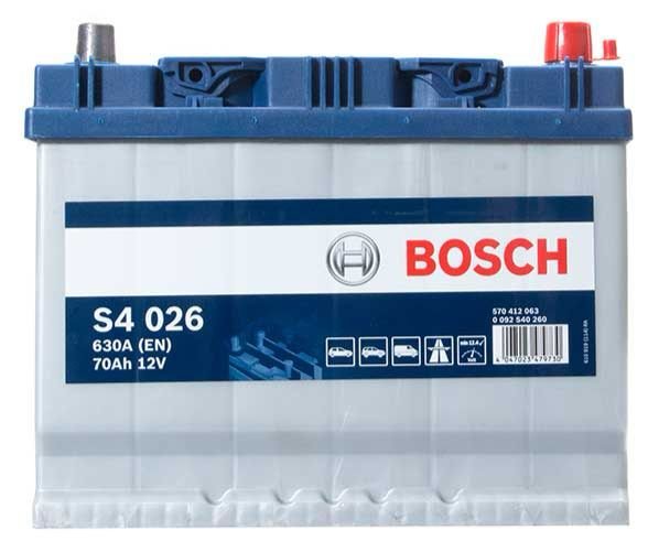

Bosch S4 026

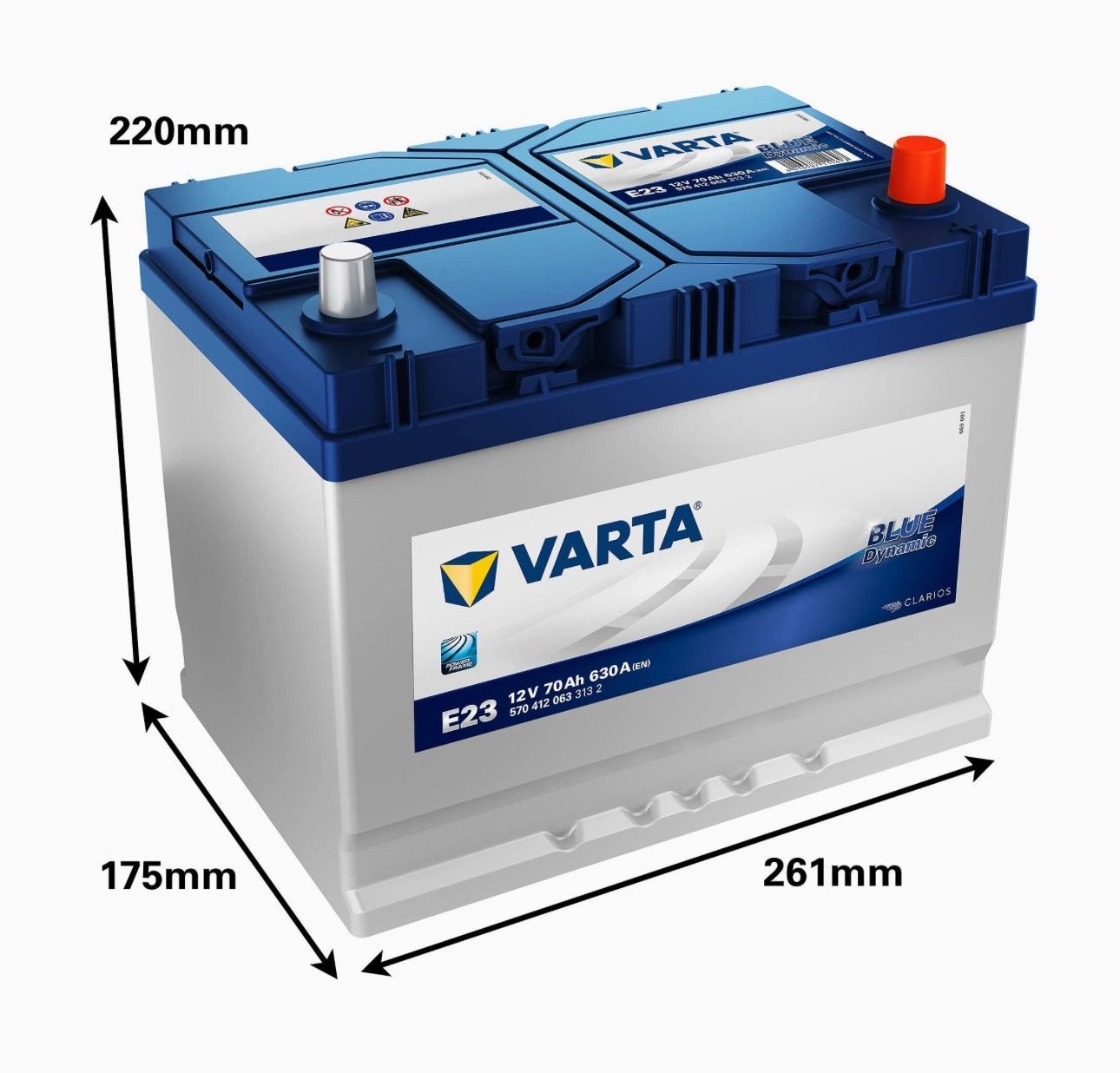

Varta E23

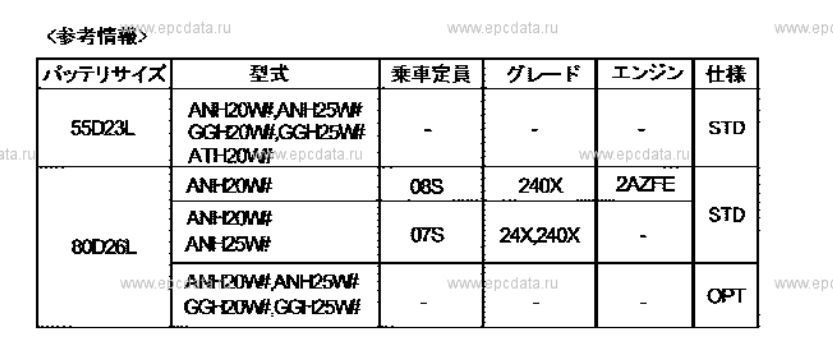

Both are suitable replacement for 20 series 3.5L engines. Pictures attached of batteries and also better spec page suggesting 55D23L or 80D26L.
nice, i have a 75D23L installed, max I have seen online in a D23L size was 95A (95D23L) - moving to D26L may be the way to go.

Bosch s4 026 worked right away 👍

Just as another reference, I just replaced by original factory fit Yuasa Battery GS 90D23L with
Bosch S4 026 Type 068 (70Ah 630cch)
It fits like a glove !
Original Battery Dimension(appx): L230 x W170 x H200
Bosch S4 032 - 068 Stated Dimensions: L261 x W175 x H225
Its fits fine as the H225 relates to the top of the terminal , the actual height to the top surface is as original @ 200mm
The tray easily accommodates this slightly Wider and longer battery no issue....... only thing is, the insulation wrap around card thing that you have from original , is for the bin !
