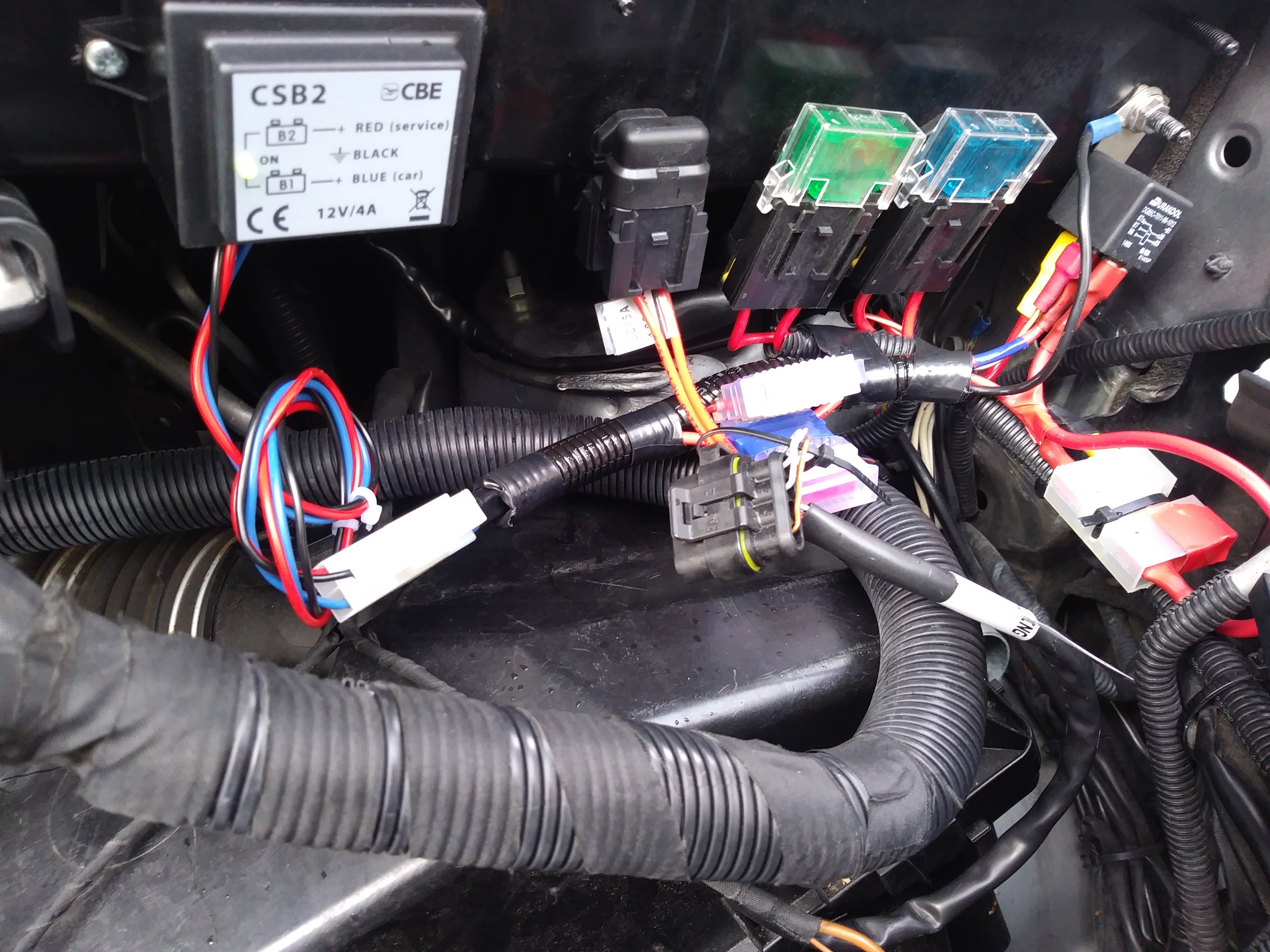

Hi Jan,
Not related to your head unit problem, but if you have a leisure battery and split charge relay as part of your campervan conversion there's a modification which might help address your battery discharging between trips out.
Our campervan conversion included a split-charge relay (SCR - far right in photo), which is fairly standard, to split the charge from the alternator so the leisure battery is charged alongside the starter battery when driving. Our van is kept outside, so over periods when not in use, we use a short mains-EHU cable (from waterproof outside mains socket, of course...) to top up the leisure battery. So, to split this charge to also top-up the starter battery, we installed a second relay (a CBE CS2 - left in photo) in parallel with the existing SCR, which tops up both batteries when EHU is connected (i.e. over 13.6v), but switches off when the leisure battery voltage drops (to avoid the leisure battery discharging totally in the event of a faulty starter battery). It uses the existing cabling between the two batteries, so the only new cabling required was under the bonnet next to the existing SCR. Works a treat when at home, just plug the EHU in for a day once a week or so....
