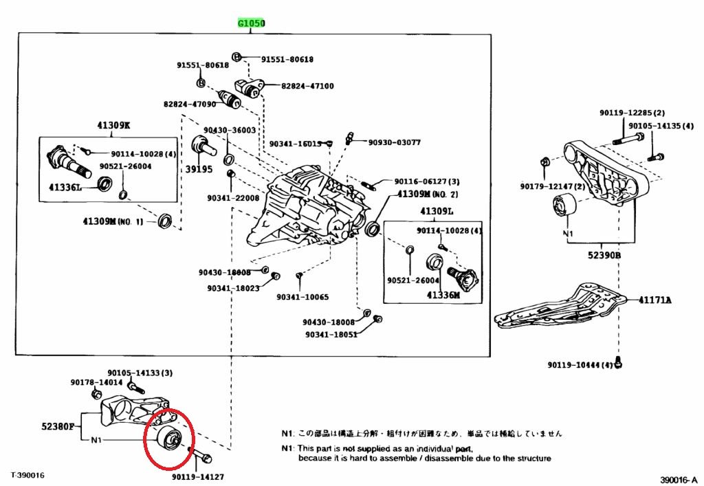

A follow up on this,
The part number for the Rear Differential is G105058021 and is available (new) for a tidy sum over at Amayama Trading Co.
Thankfully I heard from my mechanic today that the clunk is actually just a worn out bushing on the rear differential, which is a HUGE relief.
