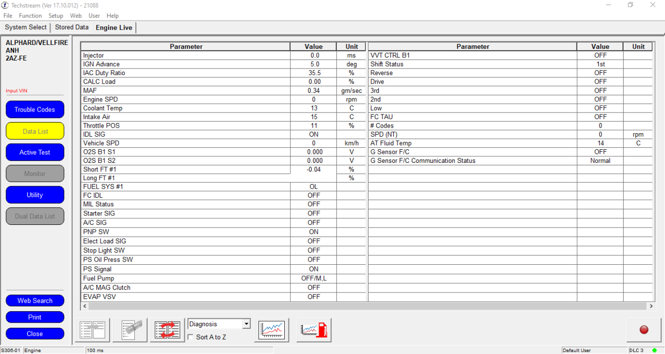

OK, my JOBD reader (Ancel JP700) only reads and clears fault codes. I must be getting confused with the OBD tool for my other car.
I checked with Techstream and there's no fuel pressure PID as you can see in the screenshot. I checked the wiring diagrams and there's no fuel pressure sensor anyway, on the 2.4L at least, so that explains why there's no reading and may also explain why @Sixfeetofjdm may have low fuel pressure but not have any diagnostic codes.
