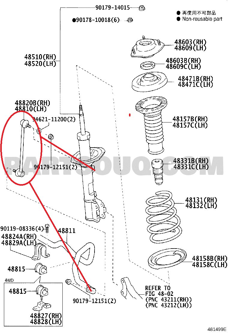

Front drop link take wheel off do yourself easy job what's your reg no. Will atatch part no. And drawing where located
Wow, that would be so helpful. Where do you get such drawings and part numbers??
Hello as you will see i have circled the link in red this is the part that needs replacing where the red lines go to is where the link is fitted to each end of the link is a ball joint this is where the rubber boots perish here is blueprint no. for the link   adt38520  put that into ebay or go to any local motor factors .
