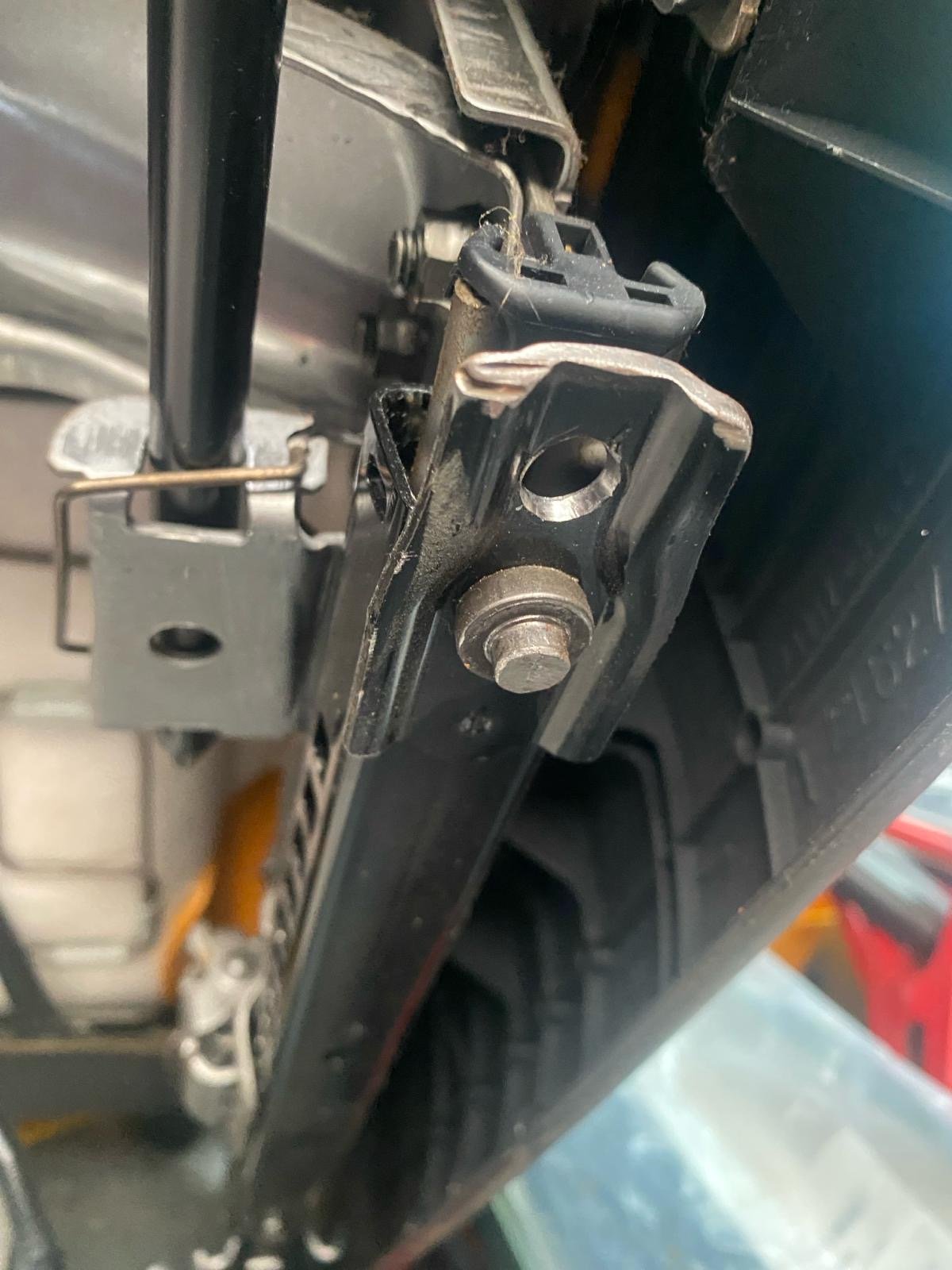

I now have the rear seats on the workshop floor but cannot see how to extract the sliding bearers from the tracks. I have removed one of the front "stop ends" held by a single M5 hex screw but that doesn't help and so I suppose I'll have to refit it. I cannot see how to dismantle the seat carrier/fore-aft sliding base mounts. Any help or tips gratefully received...

I haven't done this myself, but I seem to remember my convertor having to remove, or partially remove, the seat rails to slide the seat carriers out.
On your model the seat rails are accessible from inside the van, but, the carpet and sound deadening underfloor material will need to come out first.
I believe the nuts are captive, so refitting the rails (if that's what you intend, should be straightforward.

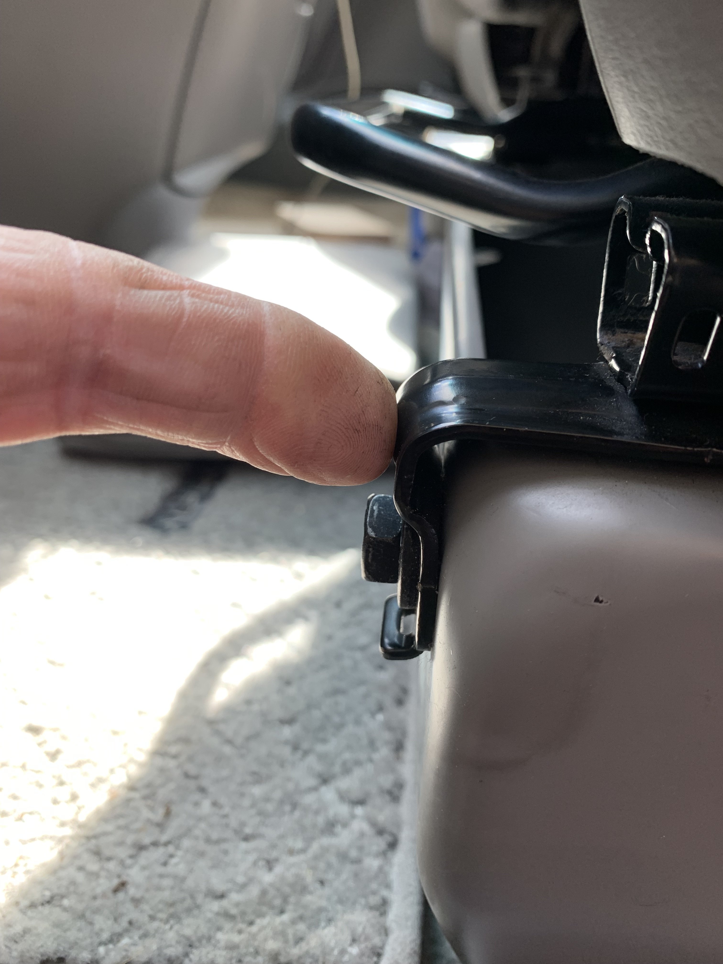

I ordered a turntable for the front seat(£250 inc. postage) from Autocraft, they were out of stock but it arrived last Thursday, with no fitting instructions.
On Friday I spent a good while staring it into submission and trying to work out how to fit it and eventually called a pal who did his a couple of years ago.  He confirmed my conclusion that I had to remove the downturned mounting on the forward end of the sliding mechanism. Saturday  I took the seat out having removed the plastic filler panels and the wiring under the seat. There seems to be only a pair of wires actually in use on the seat and I removed them as far back as I could from the connectors.
Cut the downturn off and reduced the height of the location pins from 30mm to 8mm to allow rotational clearance on the turntable, 4 short M8 Allen countersunk screws and locknuts fitted to hold it on. Two 8mm holes are needed in the slider track to replace the holes lost on the downturn. I then replaced the whole assembly on the seat bearing frame using the original mounting hex head screws. 3 1/2 hours (which could have been 2 1/2  had I not been interrupted) and job done.The wrap-around rear plastic trim needed to be cut down and its two locating pins pop into the rear off the frame and give a tidy finish.
