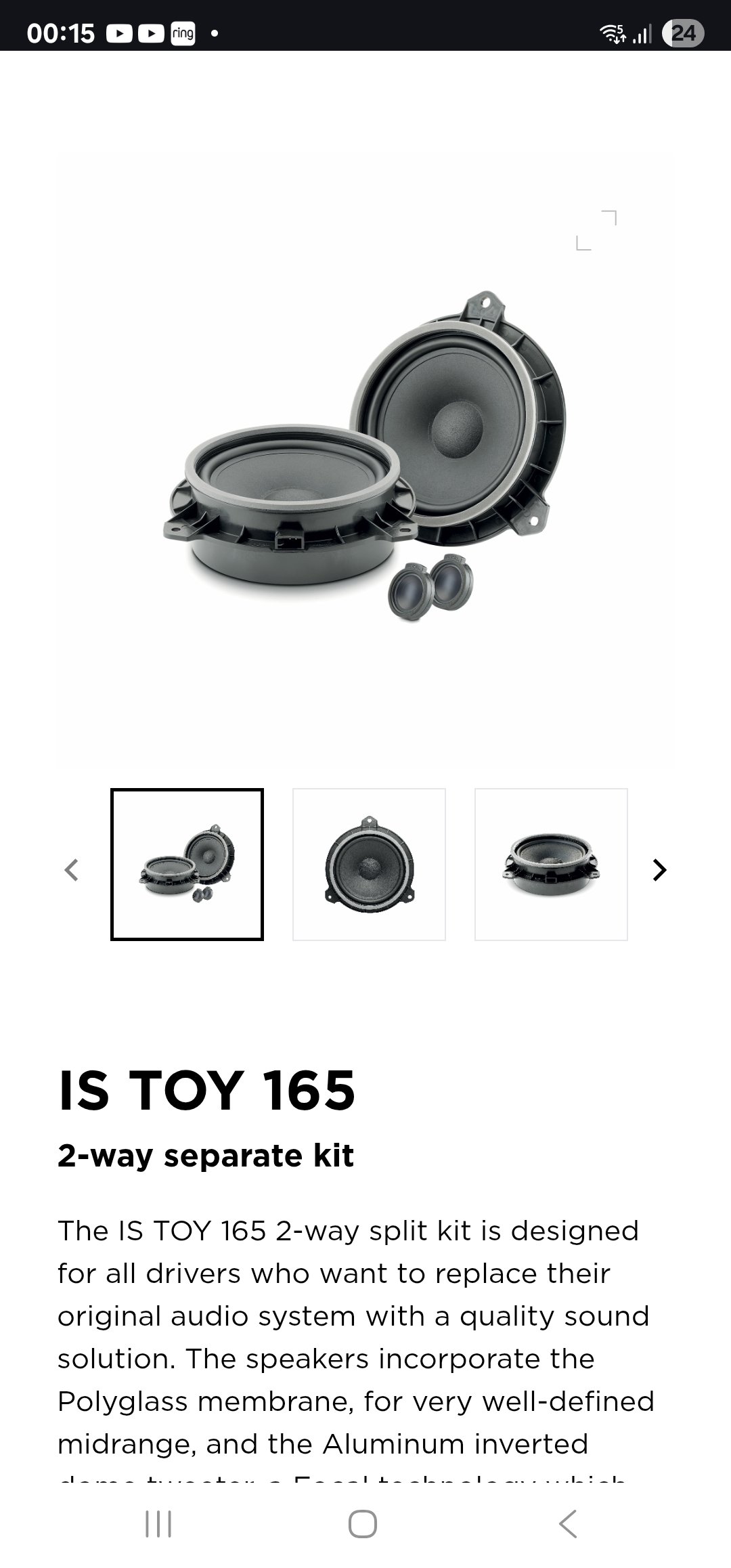

I have just installed a pair of Audison 6x9's in the front doors powered by a Focal Amp fitted under the front passenger door next to the factory amp.  It sounds much better now.  I am also fitting a pair of Focal component speakers in the sliding doors.IMG-20250519-WA0018.thumb.jpeg.6f6f6a1f4c277666858084e963c5c3ef.jpegScreenshot_20250522_001511_Chrome.thumb.jpg.a8079341e232559d41fd2caf922300ee.jpg

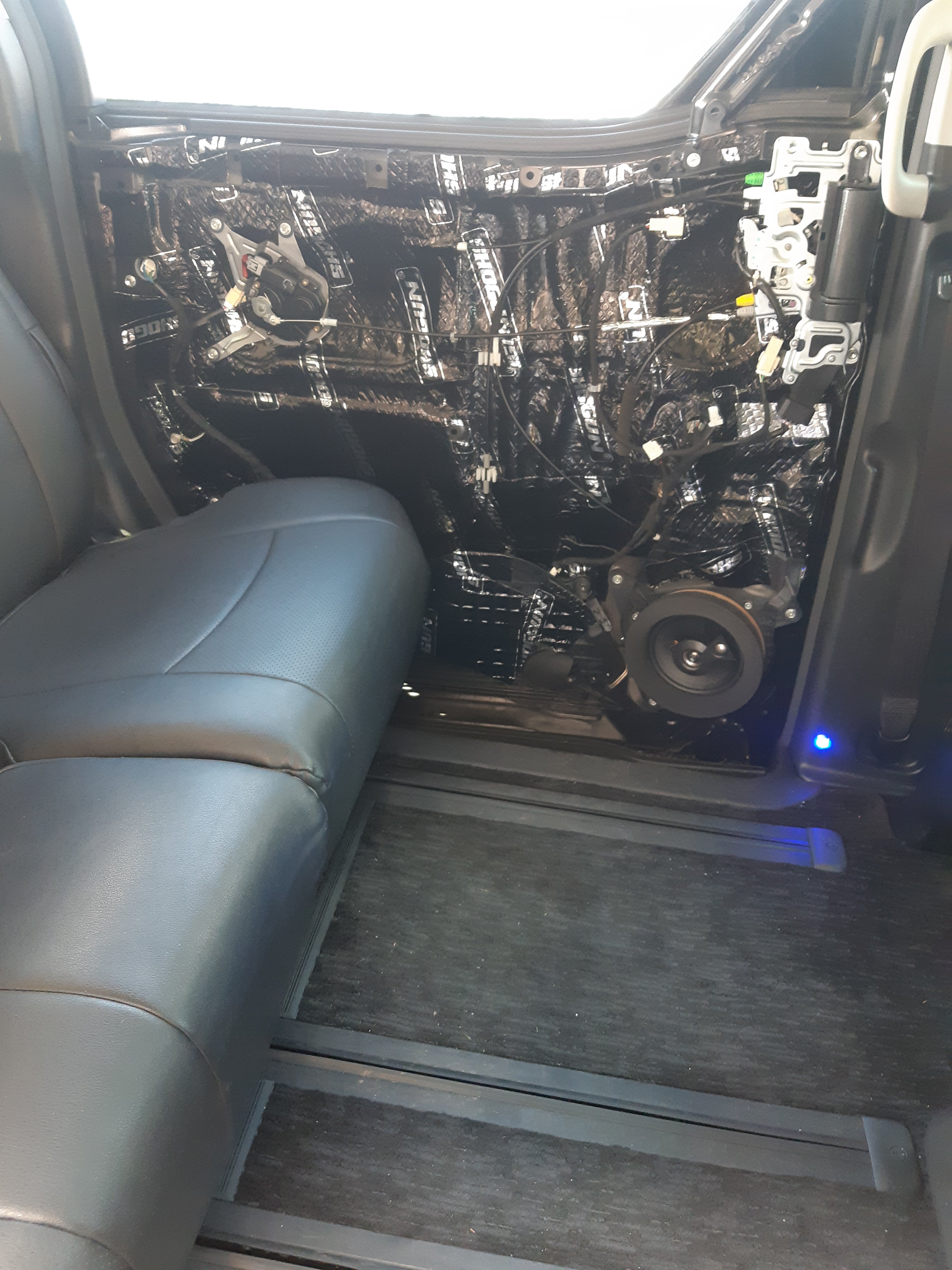

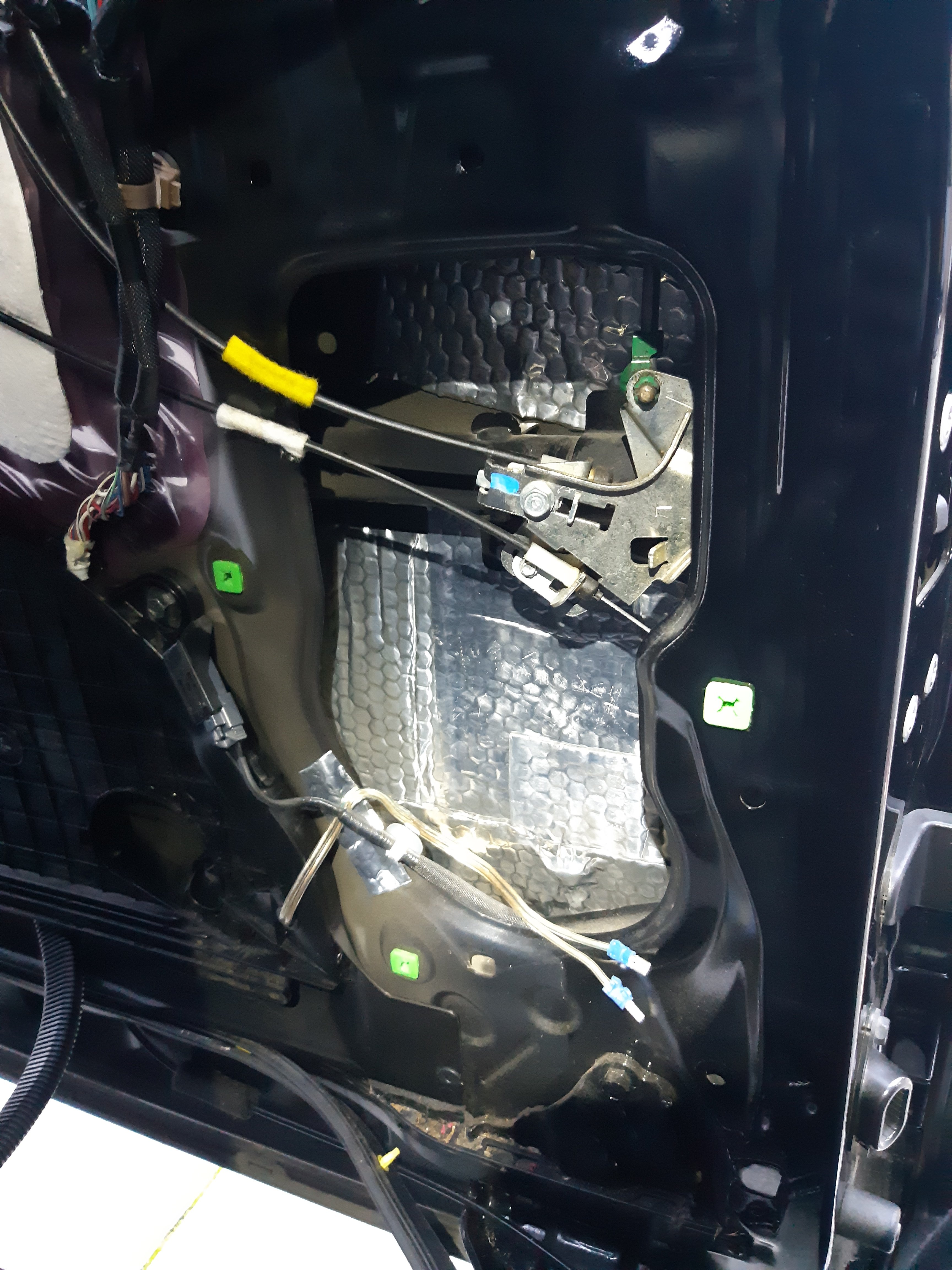

You may be able to fit them but you would need a well thought out adaptor, the sliding doors are very shallow and the door mechanism is hiding behind the factory adaptor also. These photos should give you an idea with shallow mount 6.5" 2 ways. 20240630_161959.thumb.jpg.bec40d929fe2aaa330948d3d6ad8f1c7.jpg20240630_162012.thumb.jpg.ccc31b3cd84d4d955af98dd56a858bee.jpg20240630_162611.thumb.jpg.f2a94c74668156f5bf9ef6024fe7398e.jpg20240825_111439.thumb.jpg.9ee2b75465095c70ffcdd2e9ff985936.jpg

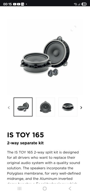

The ones I am planning for the sliding doors are designed for the Toyota, they are plug and play.  I hope they fit.
