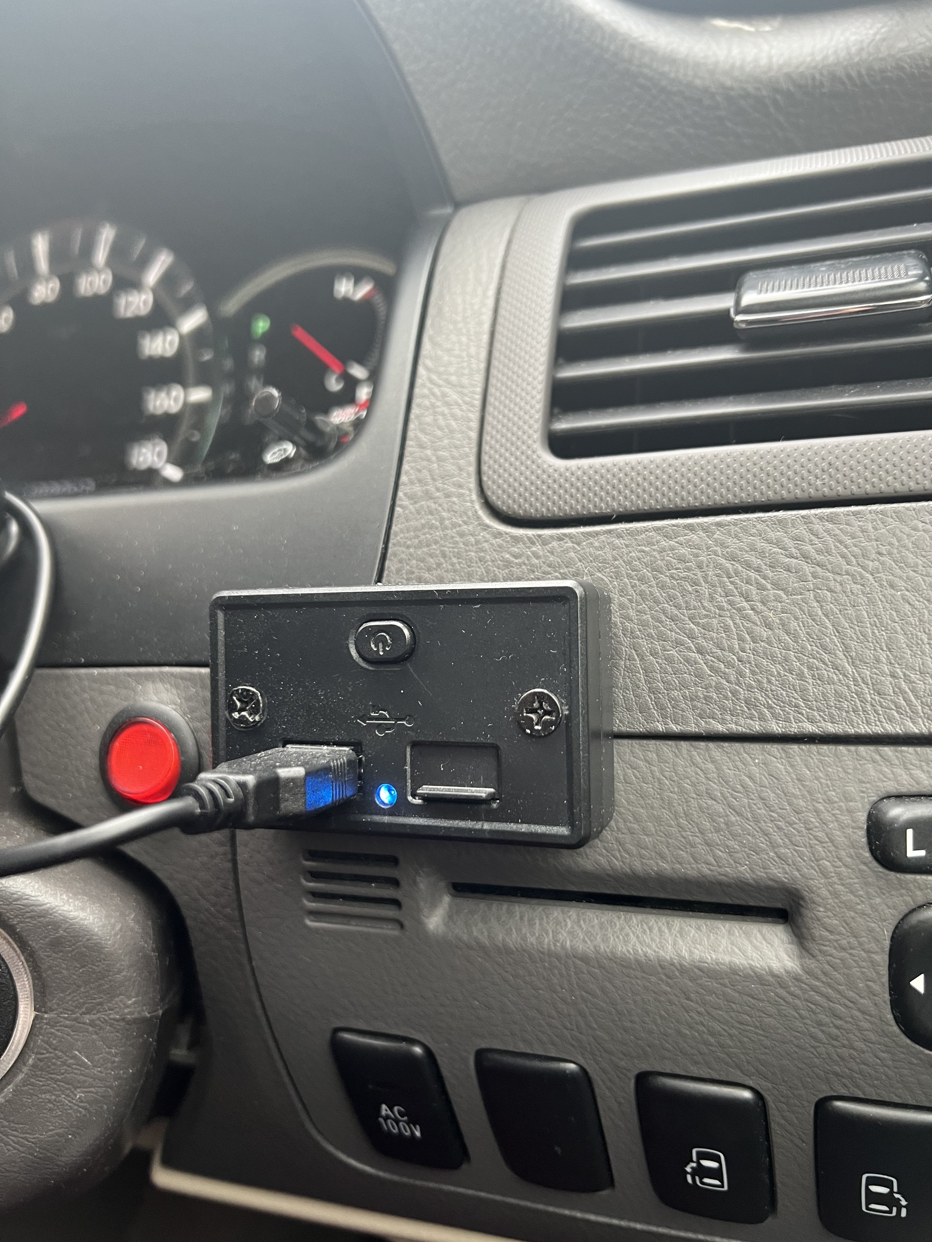

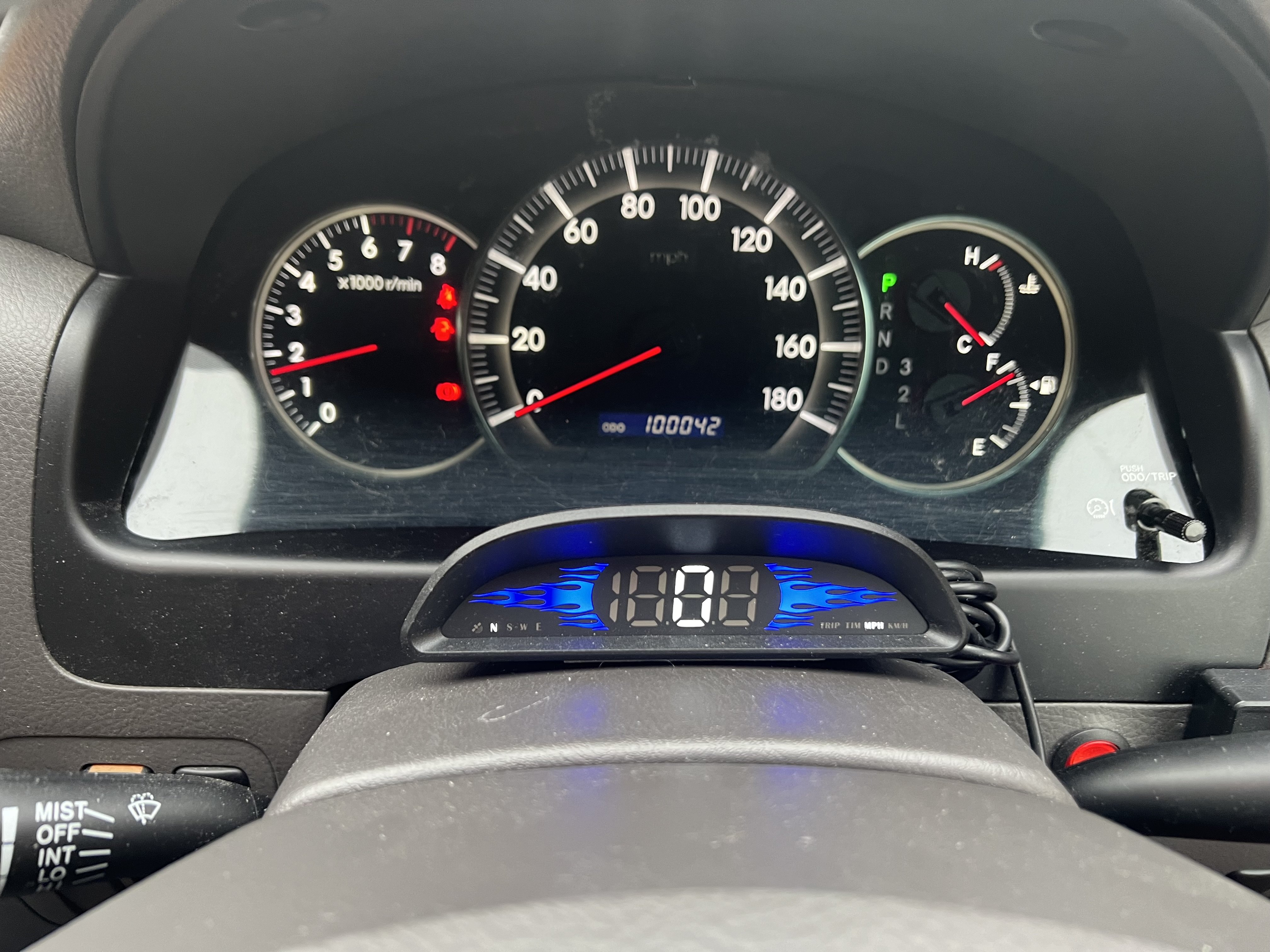

The tacho didn’t stop working, only the speedo. I found the problem to be the retrofit chip by completely removing it and reconnecting the wires, the speedo then worked perfectly well but in Kph.
I decided to leave it that way and used the power supply to the chip to fit a USB socket beside the binnacle and connected a neat little GPS digital speedo on the steering column to read in Mph. Perfect!
