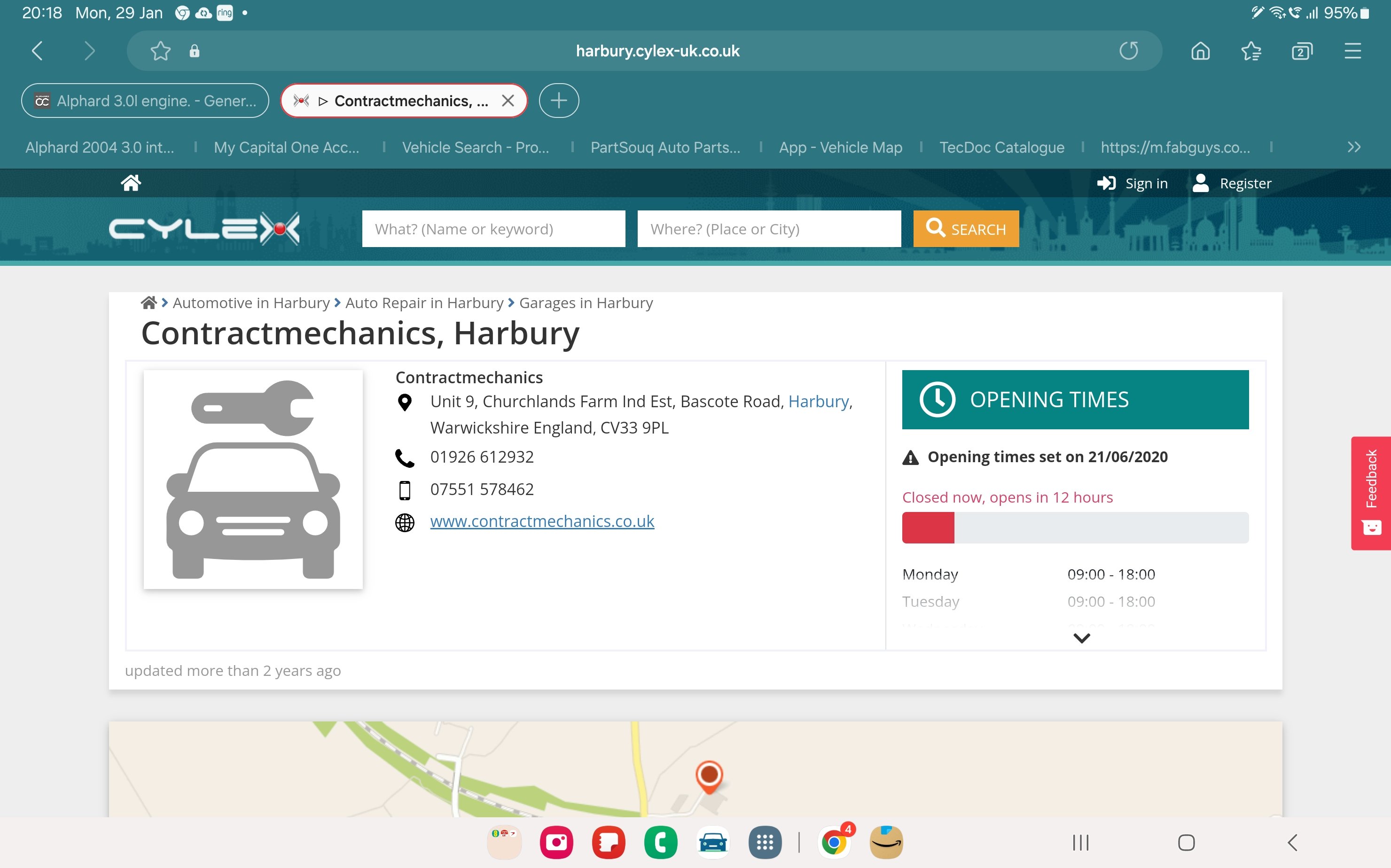

Picasso Posted January 29 Share Posted January 29 If your in no rush to have it done and want a proper job doing and prepaired to wait contact. Contract mechanics the owner is Simon specialises in mazda bongos but does all imports he very busy person but you get a top job done he not far from Southam give him a call . Quote Link to comment Share on other sites More sharing options...
