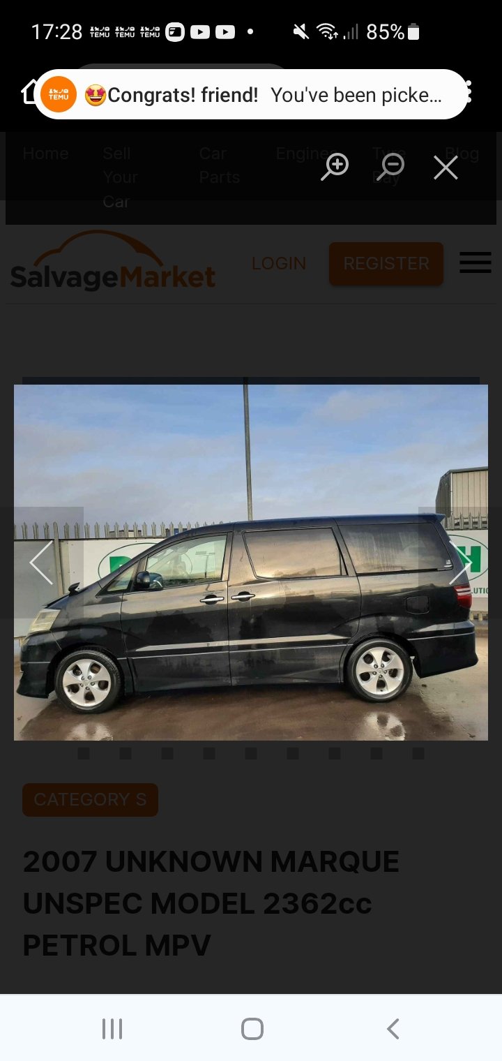

Maybe the owner of it here!  Would be great to have the history of ownership. LF07UBW
