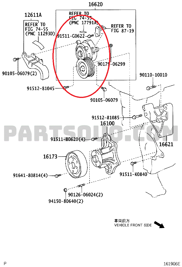

Alternator part no. G128028011  on hybrid these are not normal alternators they are high voltage and cost over £1200 + vat from toyota they also not repairable i personaly dont think its the alternator i would be looking at the belt tensioner  which is part no. 1662028030   have atatched a drawing circled in red

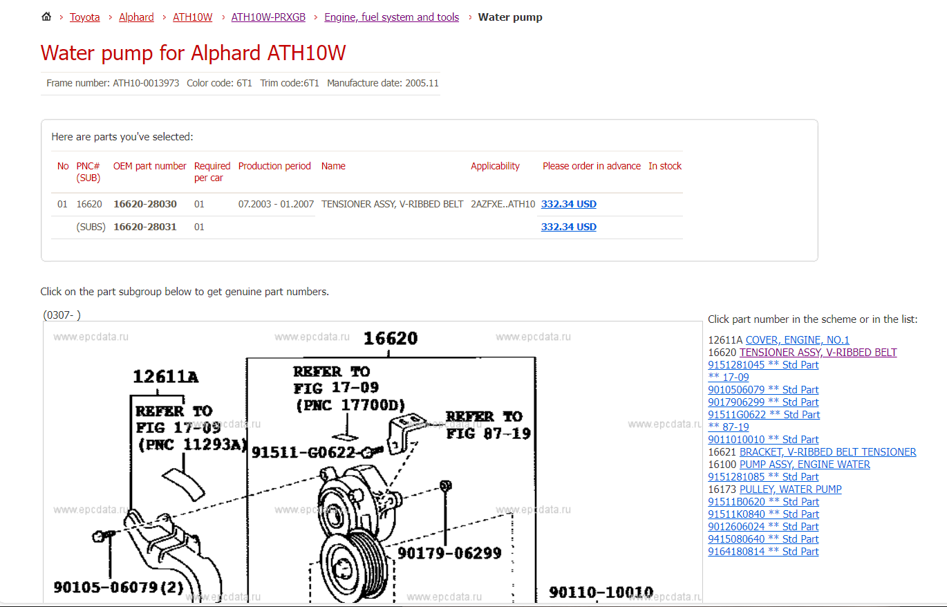

Hi, thanks for the info- if it is the belt tensioner where is the best place to get one- I clicked the link but Partsouq showed "nothing found"- I searched on Toyota EPC and found the info attached- are there any other suppliers I could try?
the part no. has been changed check this link have used it a few times and they are good genuine parts    https://www.amayama.com/en/part/toyota/1662028031   get your vehicle checked at garage be fore purchasing as will be waste of money if its not the problem if i was you get belt changed first see if that works as that be cheaper option. if you want part no. for belt let me know
