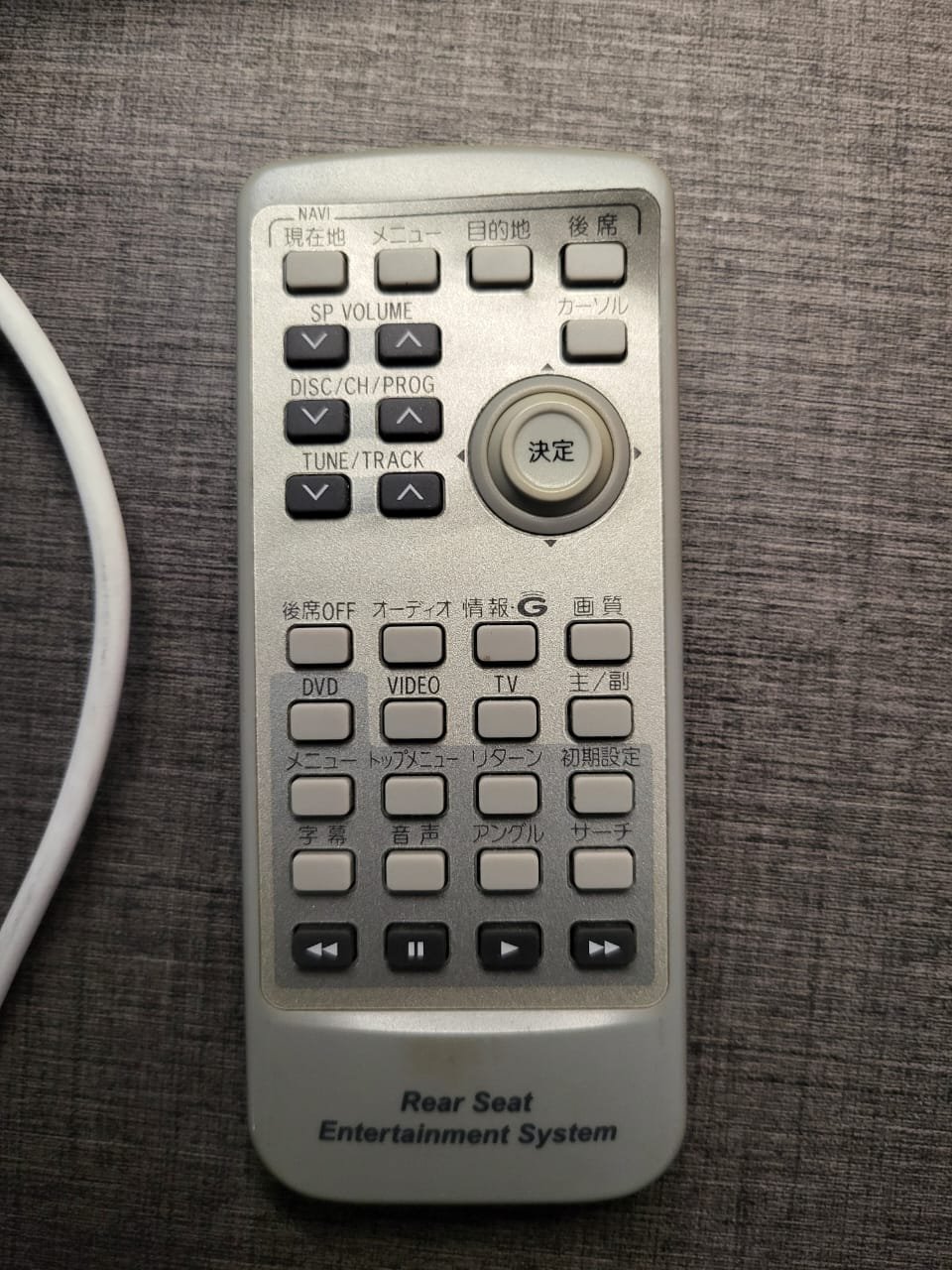

Hi, I have almost the similar problem, mine is alphard 2004 with home theatre audio system. I change the tv input to Video and it has video on the screen but without audio. my remote control isn't the same as yours. Wondering what would be the problem?

Hi Lohliak,
I also have that remote, that is for the rear screen in the back. The one I pictured above is separate remote for the digital TV tuner. Your Alphard may not have the digital TV tuner built in as it was not a standard feature. I think mine was installed by Toyota a few years after the car was built but I don't know and it may have been an option from the factory. The only built in TV tuner is the one for Japanese analogue TV. I only know mine had it fitted as I had this extra remote and the manual for the tuner included when the car was imported. On the left of my steering wheel you can also see an extra IR remote receiver which I assume is used by the digital tuner.

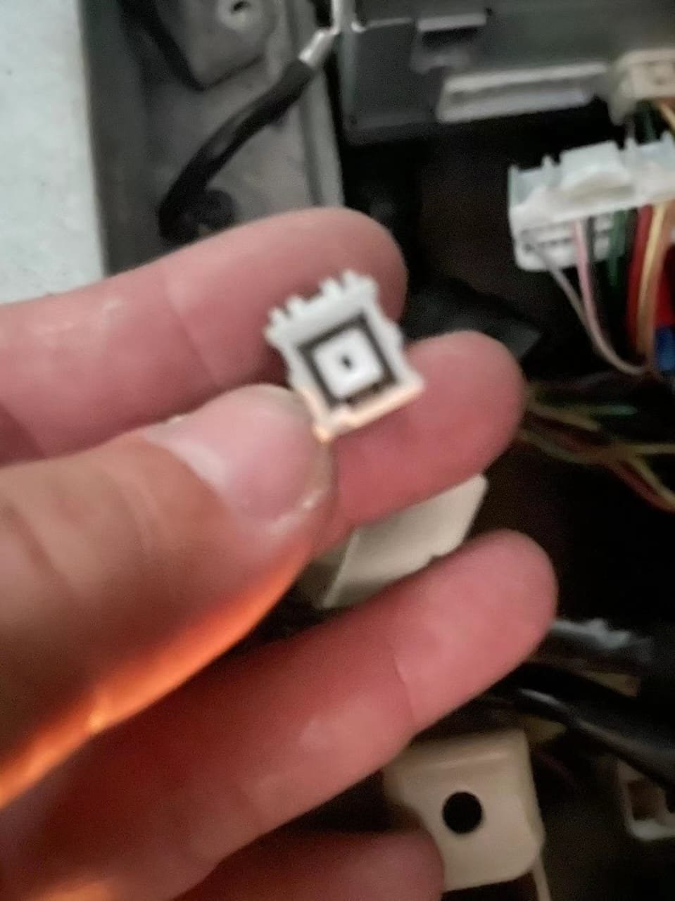

HI, I think I do have TV Tuner as when I remove the TV tuner connector it's not showing function when I press the TV function. As I can see Video on the Screen when I select the VIDEO under the TV selection, but unfortunately no audio. I did trace all the RCA socket to TV tuner and all the connection seems intact. I can't find any fault in between. The TV tuner seems connect to the Multifunction Multimedia device then only connect to the radio and then Amplifier. I did see the DVD player connect to the amplifier with a square socket which is not stated in the circuit diagram. The socket is transferring audio to the amplifier which when I remove it the DVD play only video without sound. I also attach the picture of the connector here.
