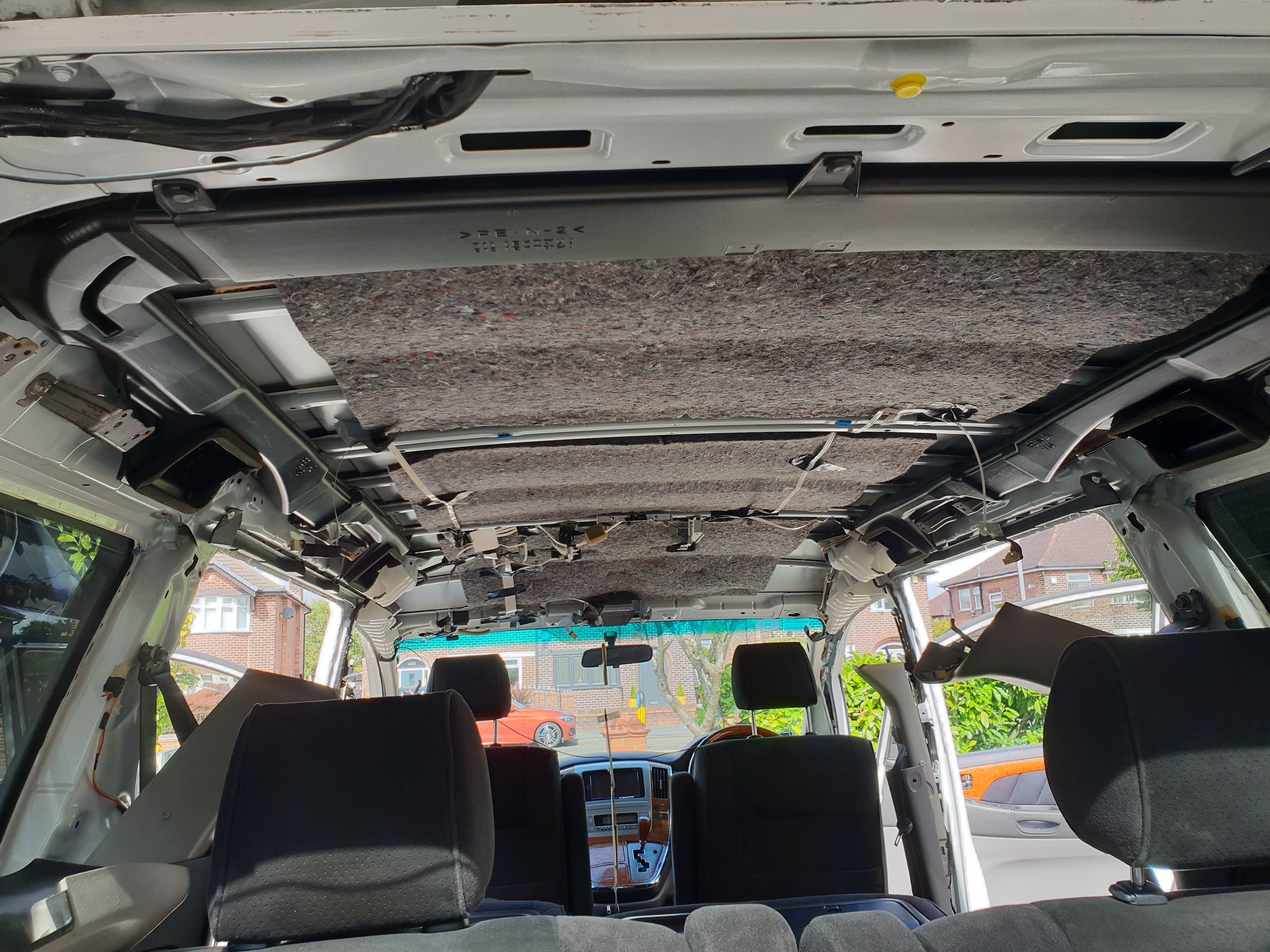

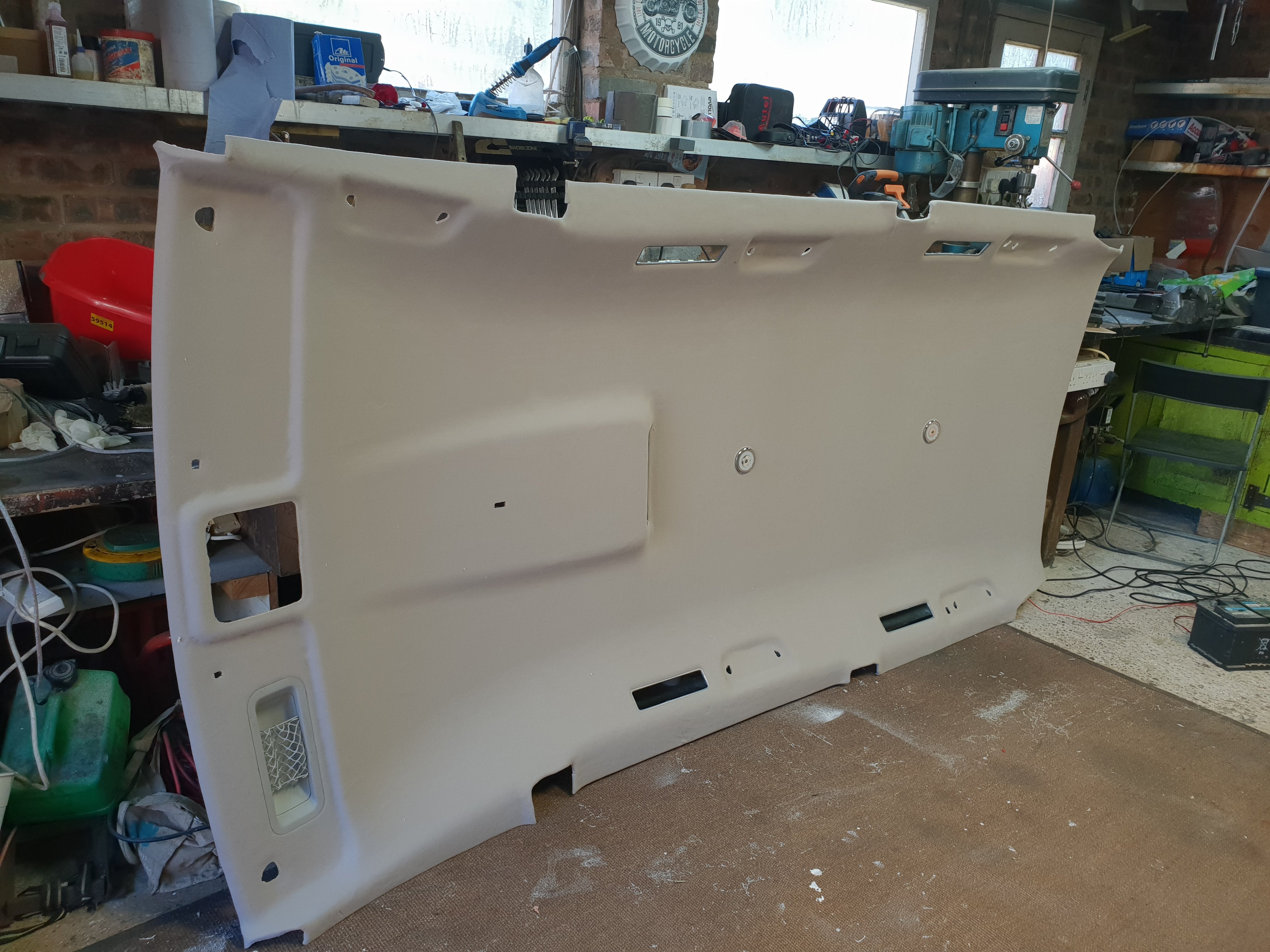

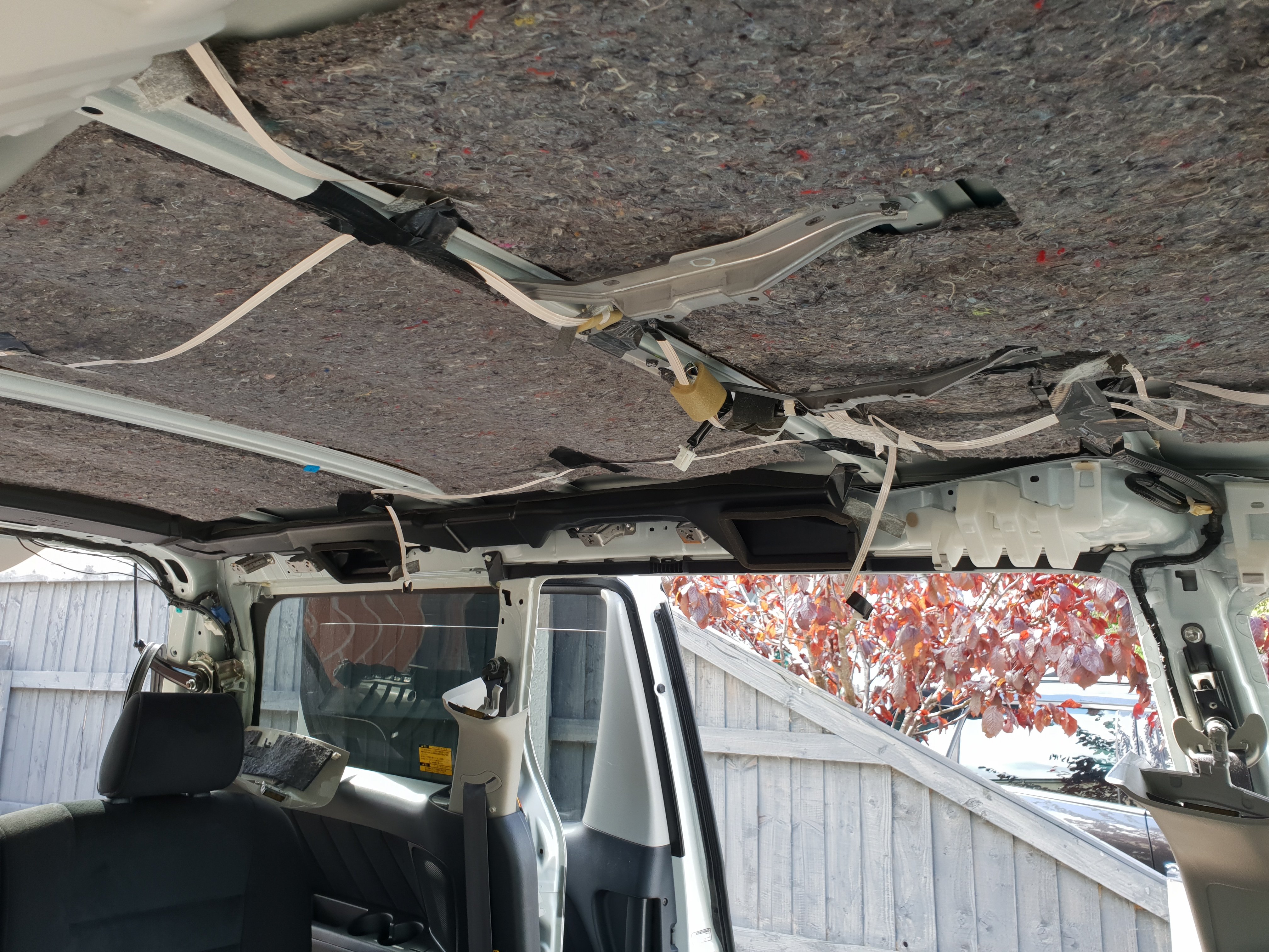

Hi supadave, I reupholsterd the roof and had to remove head lining. These are some pictures of the alphard without the head lining hope they help.

Cheers Monksey...I've only just seen this (bit late I know..). There's a whole lot going on there I'm not sure about - I might have to rethink my plans.

Quick question, from the photographs I see the overhead air ducting routing around the roof line to four overhead vents but cannot see where it rises up. Do you have another picture showing where it rises from? I want to fit a warm air heater and connect it to these overhead vents so I am trying to understand where I can connect it.
Hi Beijing Ballie, sorry I don't have any more photos and unfortunately it was quite some time ago when I stripped out the head liner and didn't take much notice of where the ducting came down.
I believe, somehow, it is operated by a unit behind the offside rear wheel arch.
I don't have any photos from my convertor, but I do remember there is no room in that area; it is packed with 'kit'.
Sardines comes to mind !
