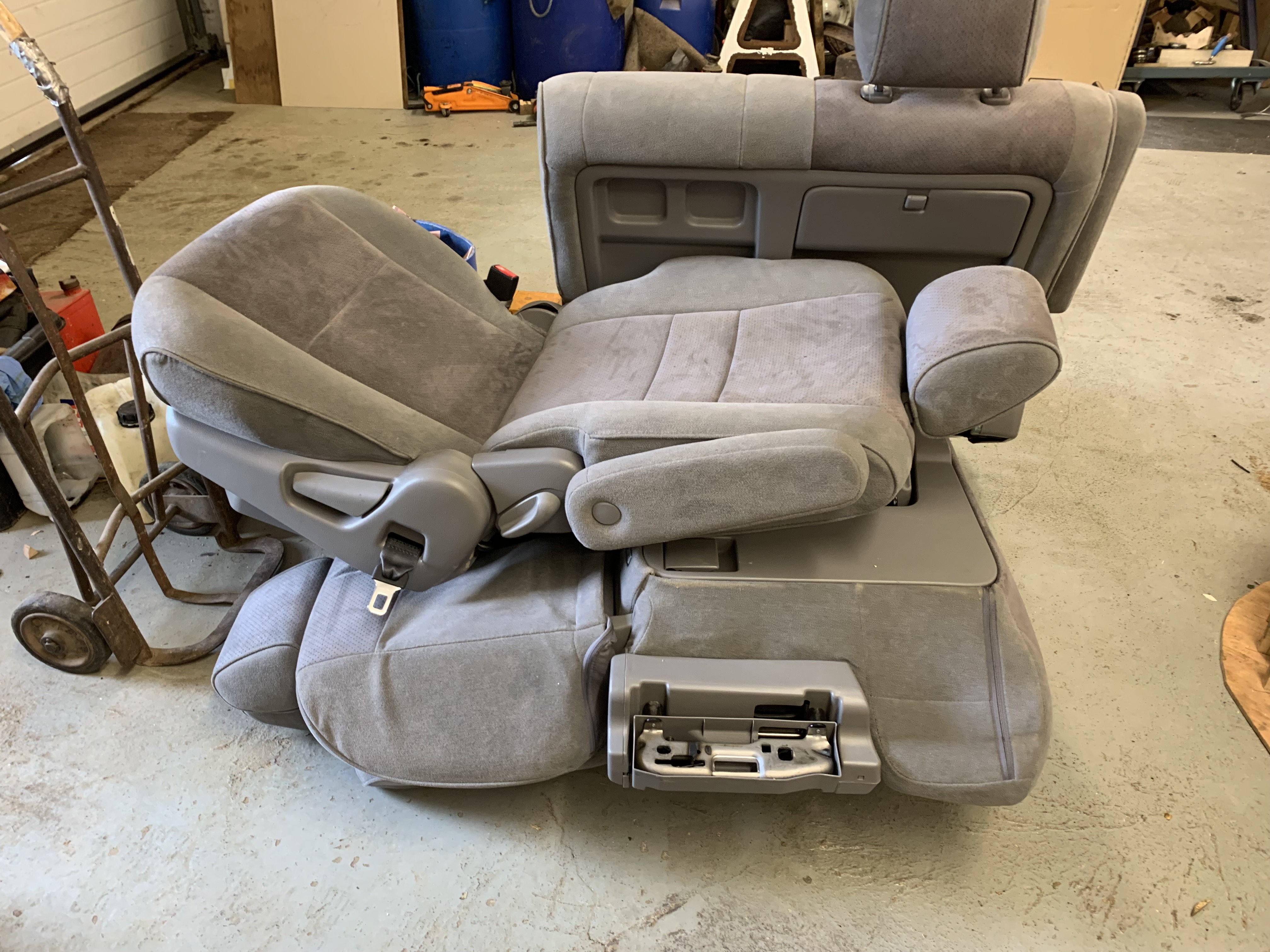

On 3/4/2024 at 9:01 AM, Duncan Grimmond said:
I have a full set offer seats available...X7817826796image.thumb.jpeg.05e94ac213827f560b540ec1aeafd8fb.jpeg
Hi there, it was a while back now but do you still have these seats and rails? Looking to convert a 7 seater to 8. Thanks
Sorry, that ship has sailed… I hung onto them for several months but eventually I took them to the tip
