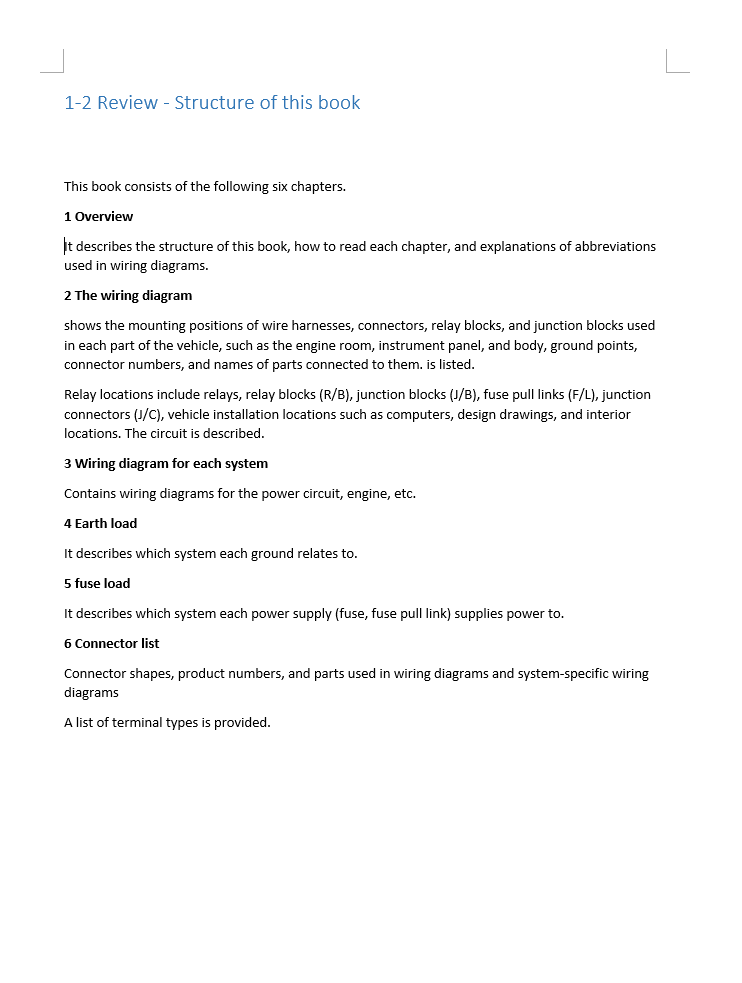

English translated wiring diagrams for ANH1#
I have translated the Japanese text into Engligh for many of the wiring diagrams for the ANH1# models 2002 onwards.  This was to help me debug the A/C on my 2004 Alphard ANH15.   If anyone is stuck and needs something to help please get in touch and I may be able to help.
