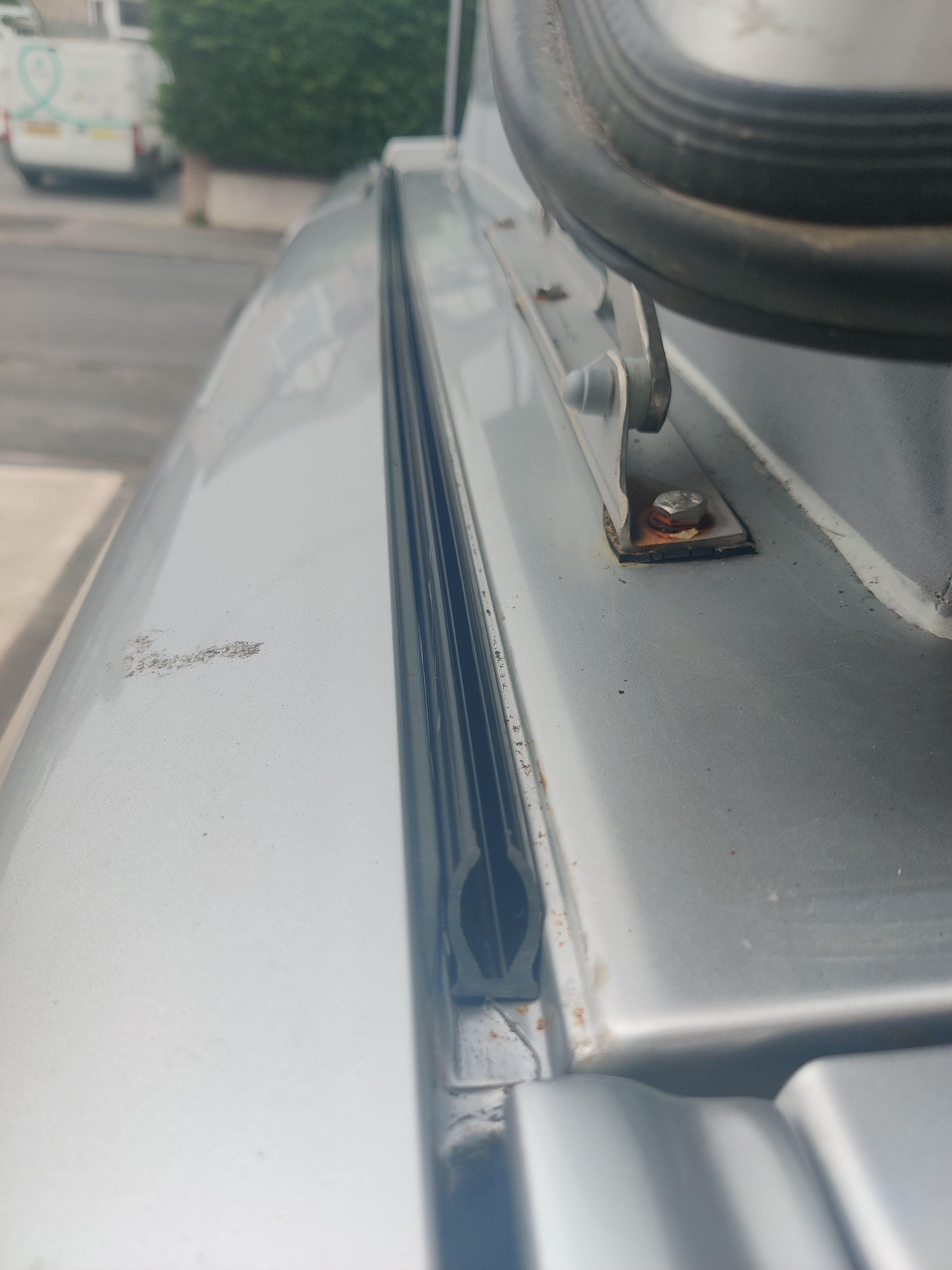

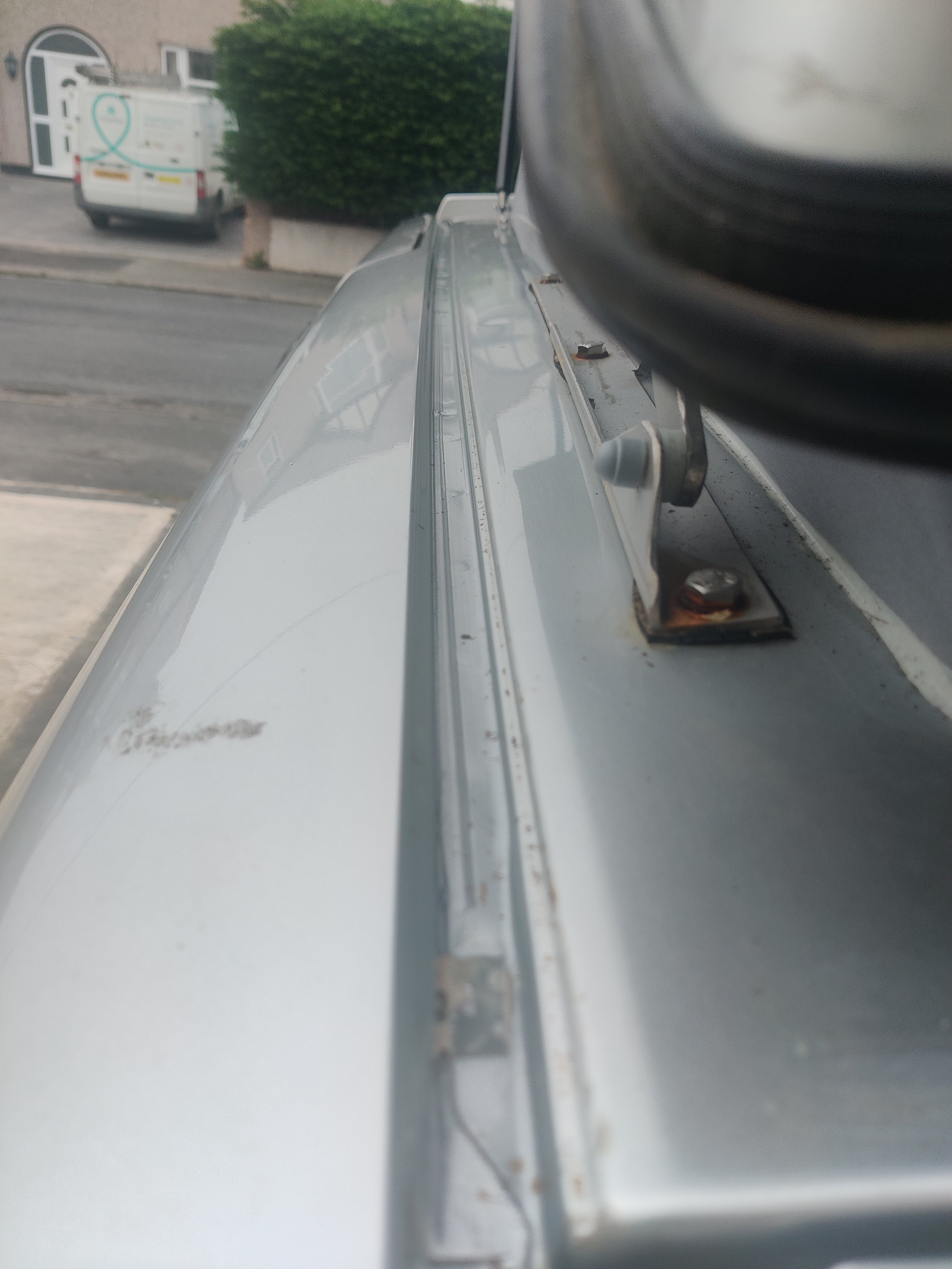

I recently fitted an awning rail by removing the gutter cover and fitting the rail in it's place. It is held in place with adhesive mostly, and a single self tapper on the leading edge. IMG_20240518_155636.thumb.jpg.7d7d1f5e268dba967d147d49d54a3c82.jpgIMG_20240518_153156.thumb.jpg.14c3a04c14974b21d8166b52923d1f3f.jpg

@smurfVery useful post.  I was looking for a solution that didn’t involve me attaching the rail to side of the vehicle, and yours might be the way to go.  Couple of questions:-—
- did the existing rubber length pull out easily?
- what adhesive did you use?
- did you need to drill a hole at the top end for the self tapping screw, or was there something me already there?
The rubber cover came out very easily. It is held in place by a couple of clips, one at each end. These clips are held in the gutter with adhesive pads and also need removing, but they can be easily levered out.
I used sikaflex 522 adhesive.
I had to drill a hole to accommodate the self tapper. It's only purpose was to hold the rail in place on the curved front end while the sealant went off, so you may find an alternative method could work.
The rail has had some use this summer, and at time we were being battered by high winds, but the rail hasn't budged one bit.
