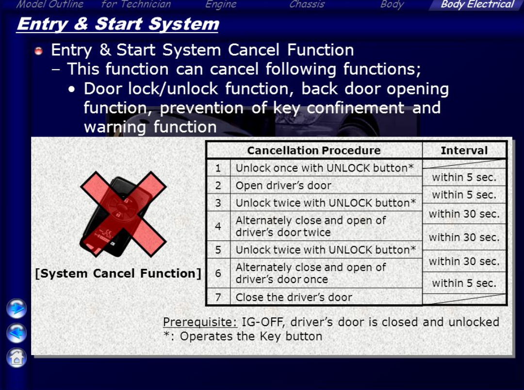

I've not found a method via fob, but you can do it via techstream, or an obd2 Bluetooth dongle
Thank you @Chris.ac  very impressive information, how and where did you find this?
Is this disabling reversible ? (Like repeat same sequence or something? )
Forgive me but I am not quite certain about meaning of the wording. Is this to only disable keyless entry or also remote opening and locking/unlocking of the doors? What is warning function?
I am afraid this actually left me with more questions then when I asked 1st time 🤣🤣🤣
I do not expect you to know the answers but I am still curios😉
I've not tried this manual method, i might have a go tomorrow with a spare fob.
The info comes from a Toyota training presentation, it describes all the electrical system changes from the 10 series to the 20 series
https://slideplayer.com/amp/10248235/
The warning function prevents you locking the vehicle from outside door controls whilst the key fob is inside the vehicle.
You can test this by lowering window (just to be sure), putting key in vehicle, get out and try locking doors by pressing button on handle, you should hear a long beep, and doors refuse to lock
