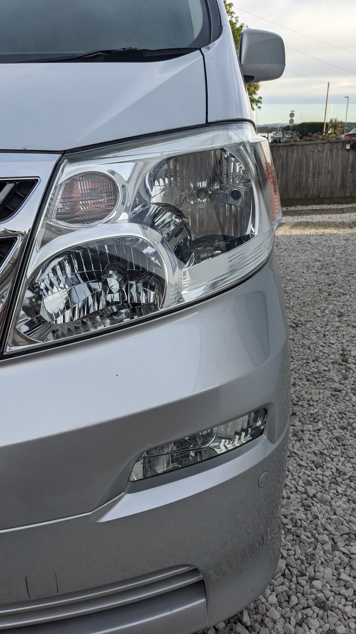

Recently had very yellow plastic headlights. Looked terrible.
Put cutting paste on and used an electric polisher.  then used a kit called Armorall Headlight Restorer Wipes (under £10 Halfords). The kit chemically removes the yellow. It then has a UV protection wipe to seal it. It is the UV that causes the problem. Leave it that day, it will haze over. Polish out the following day with a car polish.IMG-20240613-WA0001.thumb.jpg.a778aa6a2f3f61138ebe3a1bb88d6575.jpg
