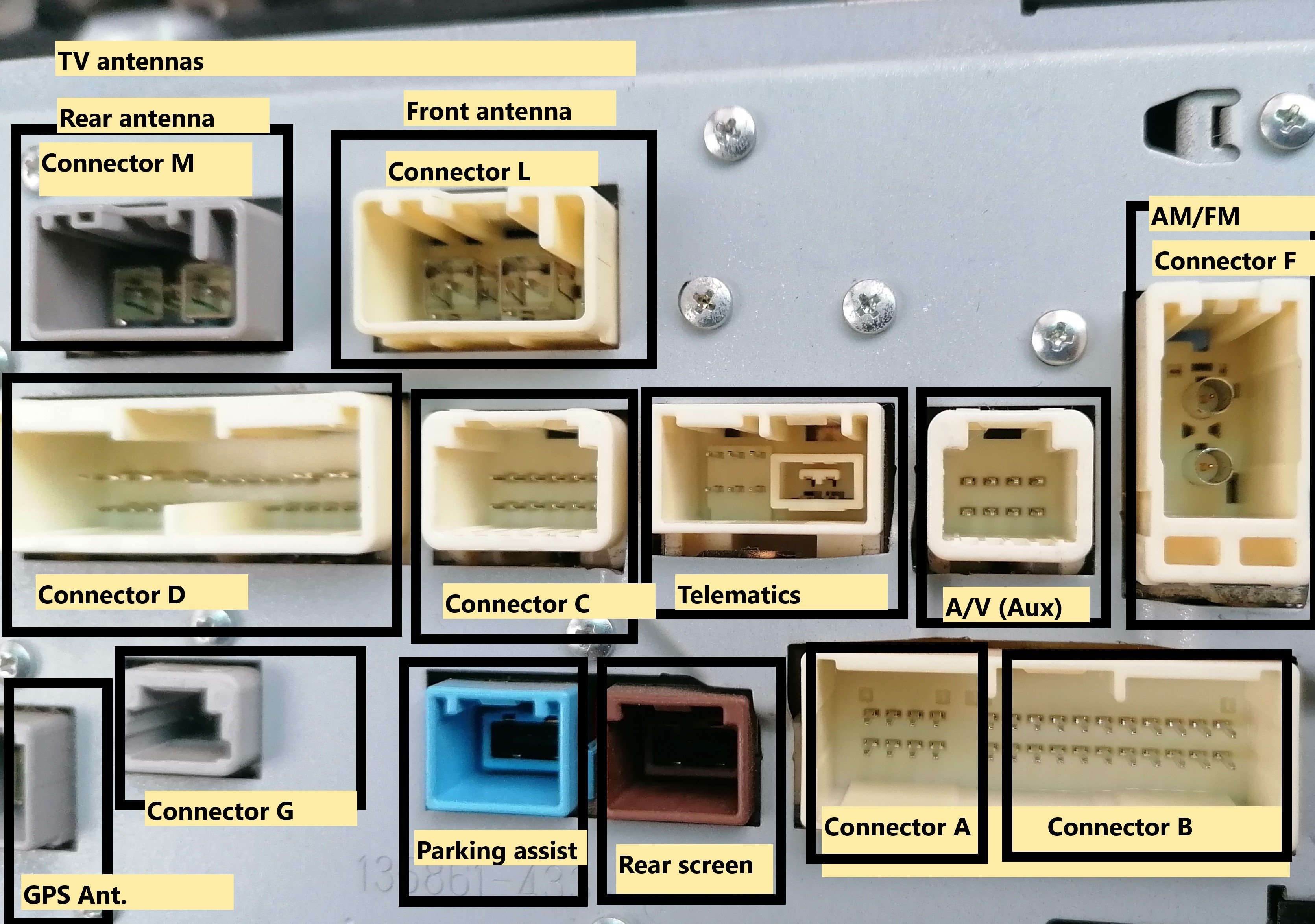

Hi Chris. That's for the etc card for Japanese motorways. Mine was in the cool box between the seats. I removed it as its unnecessary. I've just managed to connect my phone to the Bluetooth but it only seems to work with the phone app and doesn't connect to play music or anything else. I'd quite like to connect some rcd cables to the rear of the unit for audio input from my phone but from photos I've seen there doesn't seem to be any rcd connections in the back of the unit. Where did you plug in your rcd cables? Cheers
Samuel image.jpeg.41a2bb126fa31c0de0687550dc35b61e.thumb.jpeg.f9c847615153a7f27bea353bef02deca.jpeg
By RCD do you Mean RCA, my Alphard has the theatre system with the 7 speakers and rear roof screen, on the back of the centre console bettween the front seats their are 3 RCA sockets, yellow for video, and red and white for audio, if you get a lead with 2 RCA plugs on one end and a 3.5mm jack plug on the other, plug the RCAs into red and white on back of cosole, and 3.5 mm into a music player, or headphone socket of a phone with one and music on it on sd card or internet radio/Spotify etc, then press the TV button on the head unit, whatever is playing on the music player/phone will now play on head unit, was that what you were asking

Yes, apologies. RCA connections. Yep, I've also got one with the theatre system although the rear roof screen was removed to fit a poptop roof. I found the rca connections as you said and it works! Brilliant. So simple! I was worried I would have take off the head unit to find suitable connections. I think I'll now get a Bluetooth device that connects to rca and then I won't even have to use the cables. Thanks a lot!
