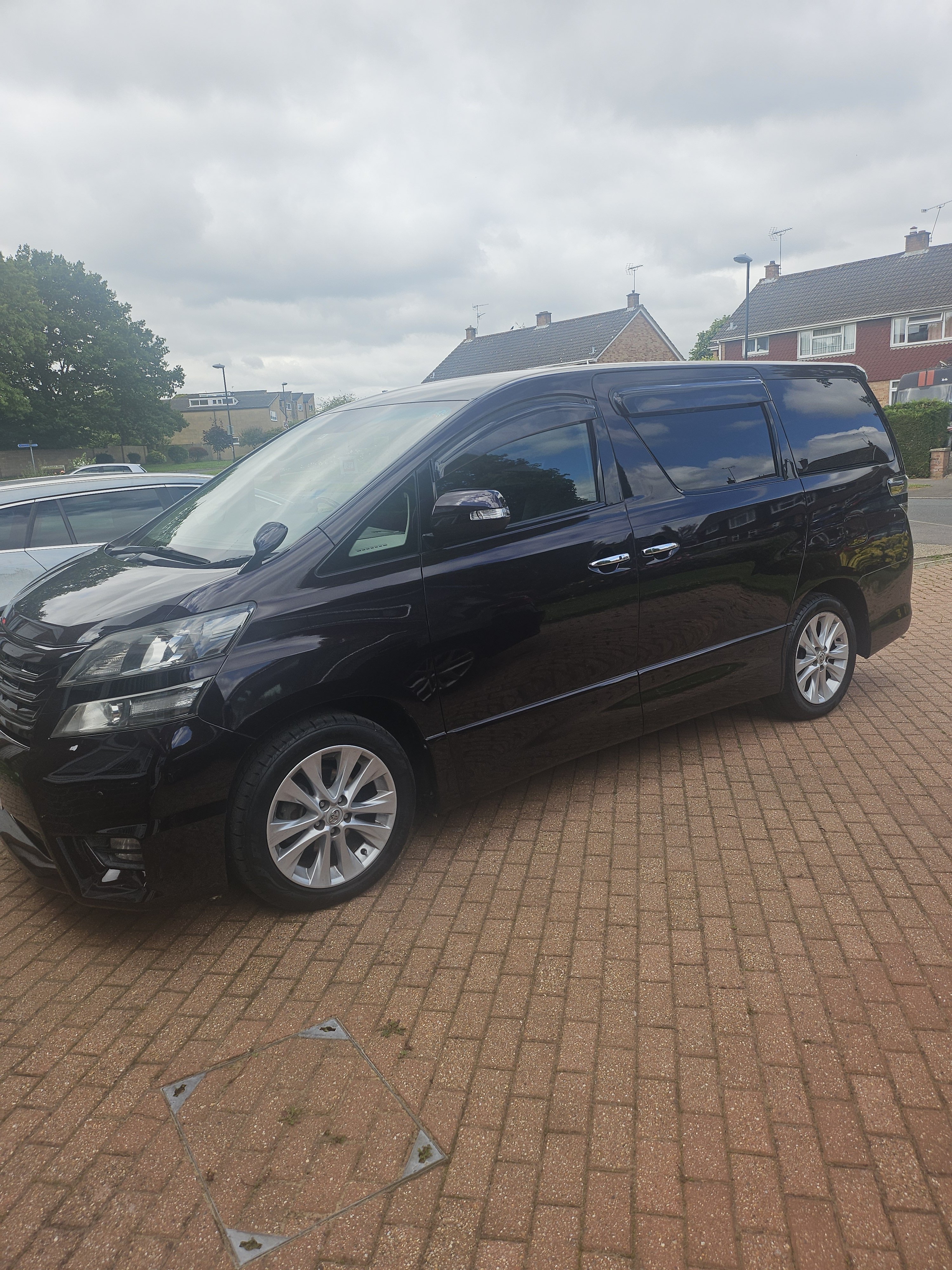

Hi everyone. Just purchased a 360Z G-edition  2010 vellfire yesterday. Super happy with it and the garage : Phil and Matt are good guys at Gastech Warrington.
It does have a handful of issues however : cruise control icon in green comes on when I press the stalk switch, but will not set.Also, does not show "radar ready" on dash. Googled, and found a YouTube vid that said push away from you ( ie cancel) for more than 4 seconds to switch between normal and adaptive cruise. No joy. Still won't  'set'. Might just be the stalk switch.
